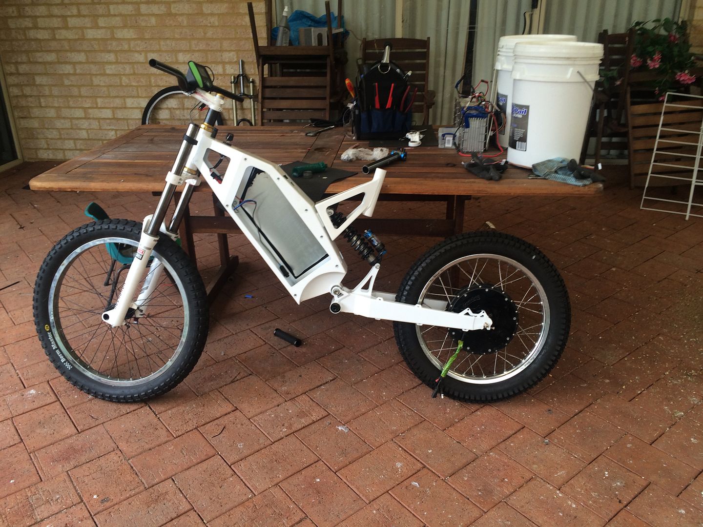

chilau2000 wrote:Hi
Can someone measure the minimum seat height and minimum frame standover height.
As the bikes set up now, the standover height is 730mm (29.2") and the seat height minimum is 920. This would change depending on which set up that you use.
I have fitted brakes too the front.
Rear adaptor doesn't fit. This was taken off my white phasor.

Rodney64 wrote:
chilau2000 wrote:Hi
Why it does not fit :?: :!: :?

Rodney64   1 MW
Posts: 1841
Joined: Mar 30 2012 4:00am
Re: Flux owners builds and pics
Post by Rodney64 » Aug 10 2015 4:27pm
Not the correct adaptor. I will need to get the correct one. They're code R.

chucho wrote:
Rodney64 wrote:Not the correct adaptor. I will need to get the correct one. They're code R.
Thanks i was confused :mrgreen:
I there any way of doing new holes and putting the seat suport a bit lower so it is not that tall for small people :?:
If you run a smaller rear shock lower mounting point on the shock
And run with a 160mm front fork then this would reduce the bottom bracket height. I have a 220mm shock so I'll do some tests tonight. I can also lower the front forks too 160mm.

Samd wrote:I bought up six kits - enough to do three shocks last night Jay. Hence the 30mmx8mm 3 piece kit is outta stock.
What an arse!
Will shoot you one up in the mail when I receive them.
Oh, what a gentleman :P
chucho wrote:I there any way of doing new holes and putting the seat suport a bit lower so it is not that tall for small people :?:
Not particularly - the inside of the frame is reinforced where the shock mount and seat subframe are so it'd be weaker if you tried to put it lower. And then it could hit the shot. Certainly the reservoir. You could get more clearance by mounting it upside down with the reserviour at the bottom, which may or may not be an issue. Someone with more shock experience wanna chime in ? Rix ?
If they wanted to do it it would have to be done at the factory, and it'd have to be a future revision. Unless there's sufficient demand to make a new seat subframe that bolts up to the existing holes. And even then it's a maybe and I don't speak for them. It looks to me like it'd be easy enough to drop the minimum seat height down an inch with a slight redesign though.
chucho wrote:And what happens if you put the the seat suport the other way round? up fasing down :roll:
LOL, you mean like this ?
In your case definitely ditch the 240mm shock and look at using a 200mm one. 19" shinko should be OK if you use the same up front too.
I will see tonight how low I can get it with a 220mm shock.
In the mean time I got these comparison measurements from stealth which might be useful.
Top of seat tube:
Bomber - 820mm
Fighter - 770mm
Flux - 800mm
Intersection of top of subframe and frame -
Bomber - 770mm
Fighter - 700mm
Flux - 700mm
Conclusion - the flux is half way between a bomber and a fighter, which in terms of form and function we knew from the get go.
The lowest 'dip' in the frame is the same on the fighter and the flux but the minimum seat height is 30mm lower on the fighter and 20mm higher on the bomber.
That all sounds about right - my flux in its current state feels about 50mm higher to sit on than my old fighter - 30mm of that is the frame design and so the other 20mm wheel size and shock position.

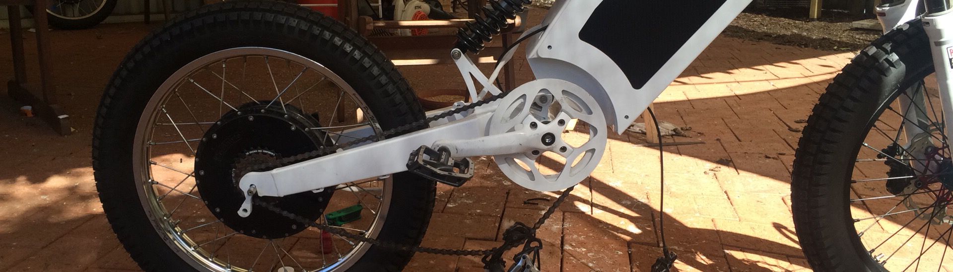

Added carbon bars, seat and seatpole. And shocks/boxers.
Reamed the bb and added a schlumpf hsd but need to check chainstay clearance for chain.
Laced up a 24*50mm front to a 20mm front hub. Also laced up one of my Mxus v2 hubs to a 19" moto rim.
Cut 10mm out of the headtube. Yep.
And I added magnets to one of my 24fet 80v 80a Bluetooth controllers so I can swing it in/out while playing with batts.Trying to avoid the clunky look of a cav3 here. Removed the keyswitch so I can mount my smartphone there maybe.
You can invert the shock and get a little more seat tube clearance, but I as far as the seat height goes, you can cut the post as short as you want, but that seat isn't going any lower than the top of the seat tube on the frame. For lowering the Flux, going with a 200mm long shock (8") shock with say a 2.5" stroke would bring you down the ground good, but you wouldn't get nearly all the travel out the Flux that a shock with a 3 or 3.5" stroke would afford. Rods got the right idea for folks wanting a lower seat height, go with a 17MC rear wheel and same on the front. That's going to give you tires sizes from 23 to 23.6 inches, vs 25-27.5" of your bit MTB tires, that mod alone will lower your seat height up to 1.5" giving everything else being equal Just remember if you go this route in the rear and don't change nothing up front and use a short shock, your head tube angle will be more slack and this can affect slow speed handling noticeably.

Post by Rodney64 » Aug 13 2015 6:38am
Made some more progress today. Cut the Crystalyte phase wire bullets off the 4080, also the Crystalyte hall sensor connection and soldered longer wires so that the cables enter the frame. I've also shrink wrapped the wires white. I have also purchased 1/2'in 20TPI nylock nuts and on the 7 speed cluster side plan on grinding down a washer so it doesn't sit on the freewheel. The freewheel I'm using needs a washer which is under 21mm. Current washer is 23mm. It will work but puts stress on the side cover until it fails which Ive had happen in the past.

Post by Rodney64 » Aug 15 2015 2:43am
Managed to get the rear wheel on and lined up.
44 tooth on the front with a 13/32 on the rear. I still need to add a couple of links too the chain and fit a gear shifter
Still need to bleed the rear brakes,fit the controller temporarily, soldier on the wires to the Adaptto controller plug, drill a hole in the front panels for the controller wire and brake and throttle cable to go though. Bolt on the adaptto screen and fit the throttle, plug in a temporary battery and I should be good to go.
