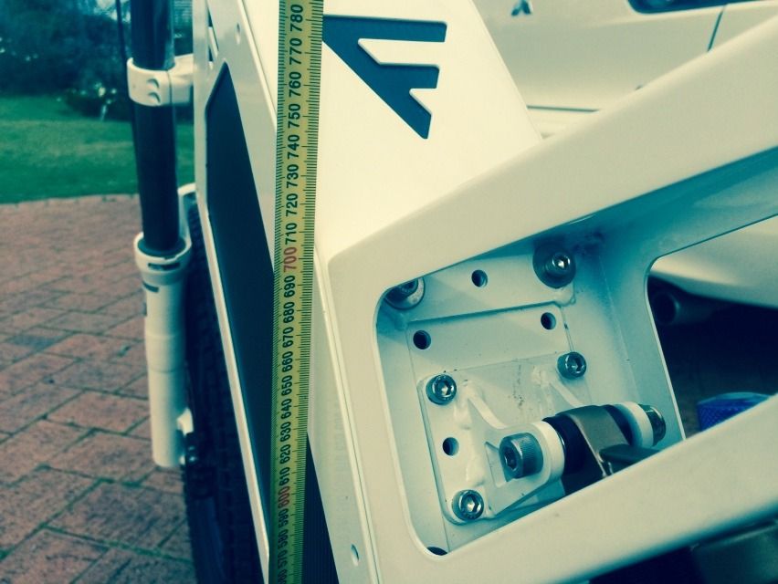

Post by Rodney64 » Aug 15 2015 11:09pm
I know everyone is interested in stand over height and bottom bracket height
A couple of photos
Standover height 710mms and bottom bracket is 360mm.

Post by Hyena » Aug 16 2015 2:01am
Rod, keep in mind those breakers are typically specced for 12 or 24v operation so will behave differently at higher voltage. Unless others have documented that specific type it might be a bit of a 'suck it and see' type outcome. Did you change something around with your shock position ? Previously you said the BB clearance was 400mm but it's now only 360mm ?
I moved my shock mount from the bottom to top position (only one hole up) and it dropped the BB height quite nicely. Moving the shock mount up ~10mm has dropped the BB 400mm down to 360mm and I can now flat foot the bike. I would ideally like the bike a tad lower again but this is easily achievable by trimming a bit off the top of the seat tube. 10mm off will sit me as low as I need to go for the steep and technical sort of offroading I often do. It could still go lower again by flipping the seat mount upside down, but I dont want the BB any lower than this and for my height it wont be necessary.

Yes it's a smaller rear shock Jay. 220mm previously it was 250mm. And yes those breakers are 12volt

chilau2000 wrote:Hi Hiyena
A few questions on your build ?
Rear shock length
Hubmotor and spoke gauge
Shock length is 220mm and unless you're quite tall I reckon this is the way to go. With the seat post right at the bottom and adjustability in the shock mount it will suit people down to 5'6" up to around 6' before you even start to play with the length of the seat post.
Hope motor and spoke gauge is 'choose your own adventure' depending on how and where you ride. On this build mine will be a mid spec hub motor and either adaptto mini or maxi
fullonoob wrote:How hard is it to ream the bb?
You'll need the special milling tool. Unless you already have it I was planning to buy the tool and do this so it's already supplied pre-done. I'm thinking I would also need to supply the special box spanner that's used for inserting the drive. The tool is $200+ so you guys don't want to have to buy that but the box spanner is only $20 and it's both necessary for installation and useful to have if you even want to remove the drive for servicing or replacement. If a group of you in each country want to share the spanner you can but for $20 I would think it's probably not worth the shipping costs to bounce it around.
