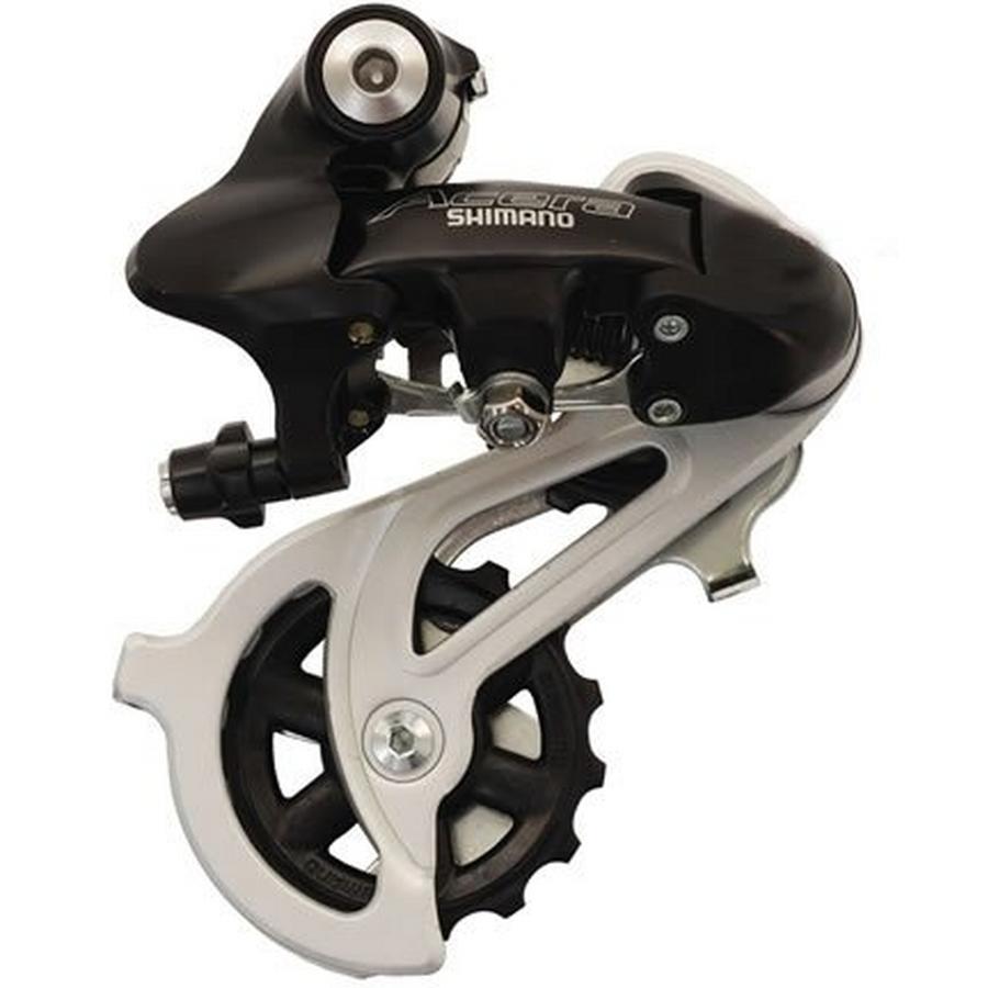

appreciate the kind words! are you sure 36t up front is enough? What voltage are you running? 36t>>11t will only let you pedal until about 16-17mph in your smallest gear
as of right now I have a 42t front 11t rear and get about 21mph until its too fast of a cadence, since I want to up the voltage to 48v in spring I will likely try to fit a larger front sprocket also
Im using a cheap take-off Shimano Acera derailur I think its off the Tidalforce s-750 but not 100% sure
