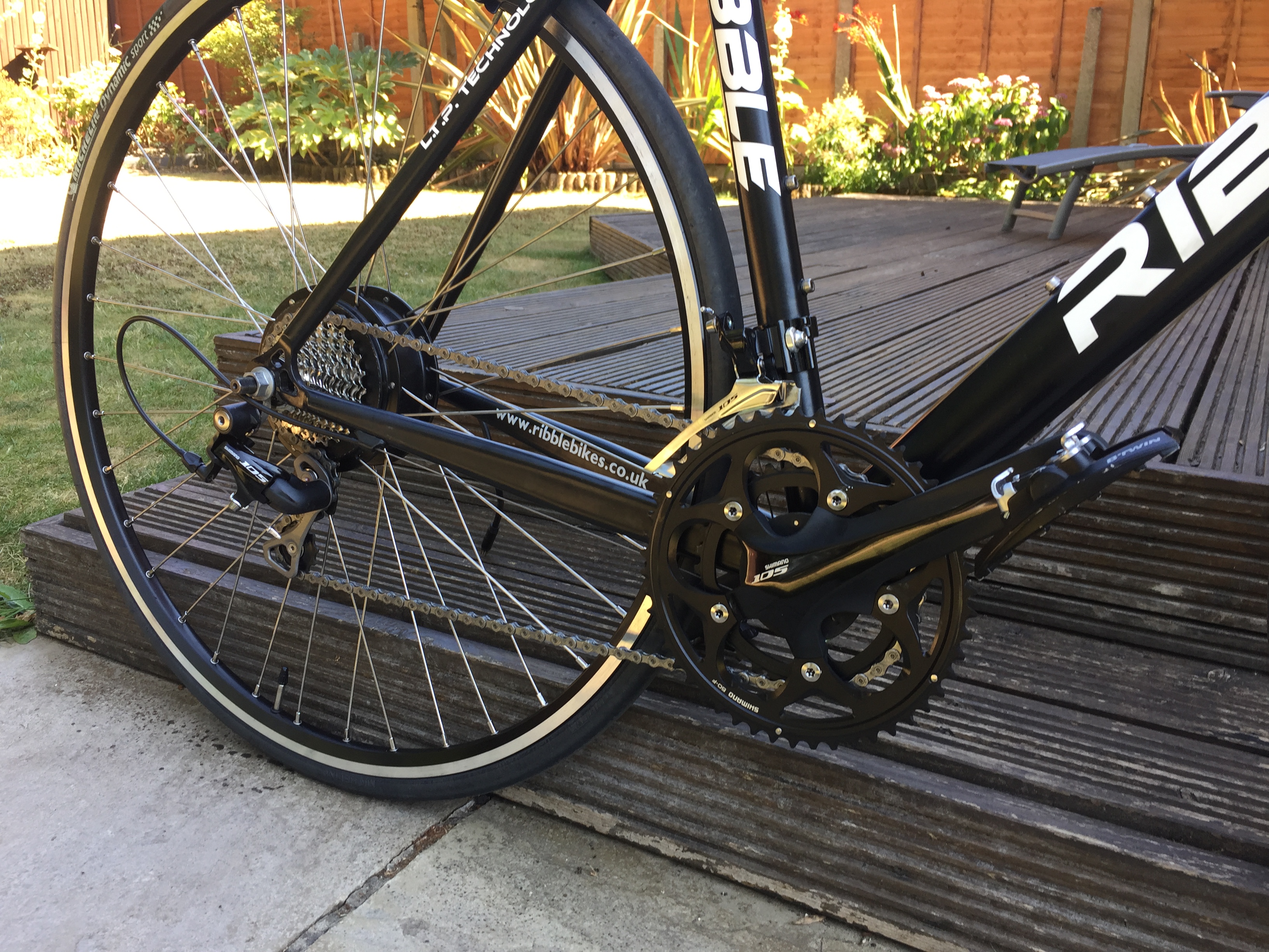

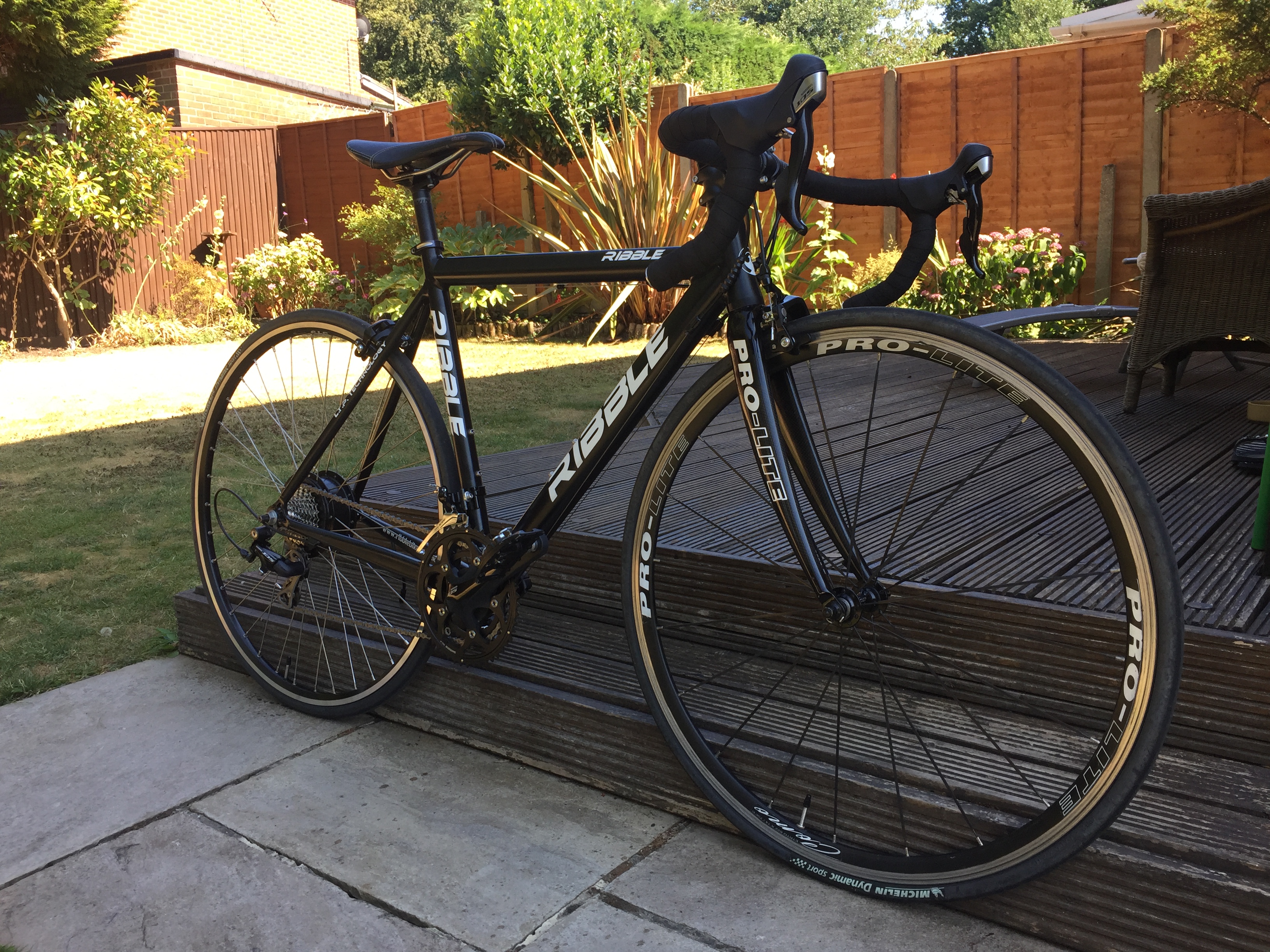

I've decided to convert my current roadbike:

Been a while since I updated this and a fair bit has happened. I could only use the larger 3 cassette rings and couldn't get the indexing right so took it to a local bike guy. He had the bike for nearly a month whilst trying to figure out what the issue was.
Turns out that it had Shimano rear cassette and it just wouldn't consistently play nice with the Campagnolo group set. I decided to get him to upgrade my set up to Shimano 105 and it solved all the issues and left me with full use of all the gears and a much better setup.
I took the time once the bike was back to properly route the cables and tidy everything up.
Heres the bike back as a standard roadie with the Shimano setup:
