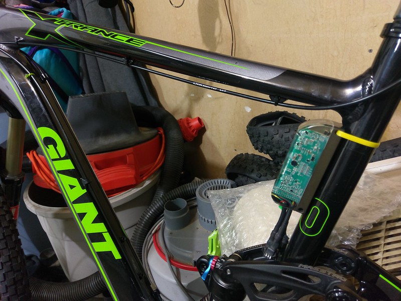

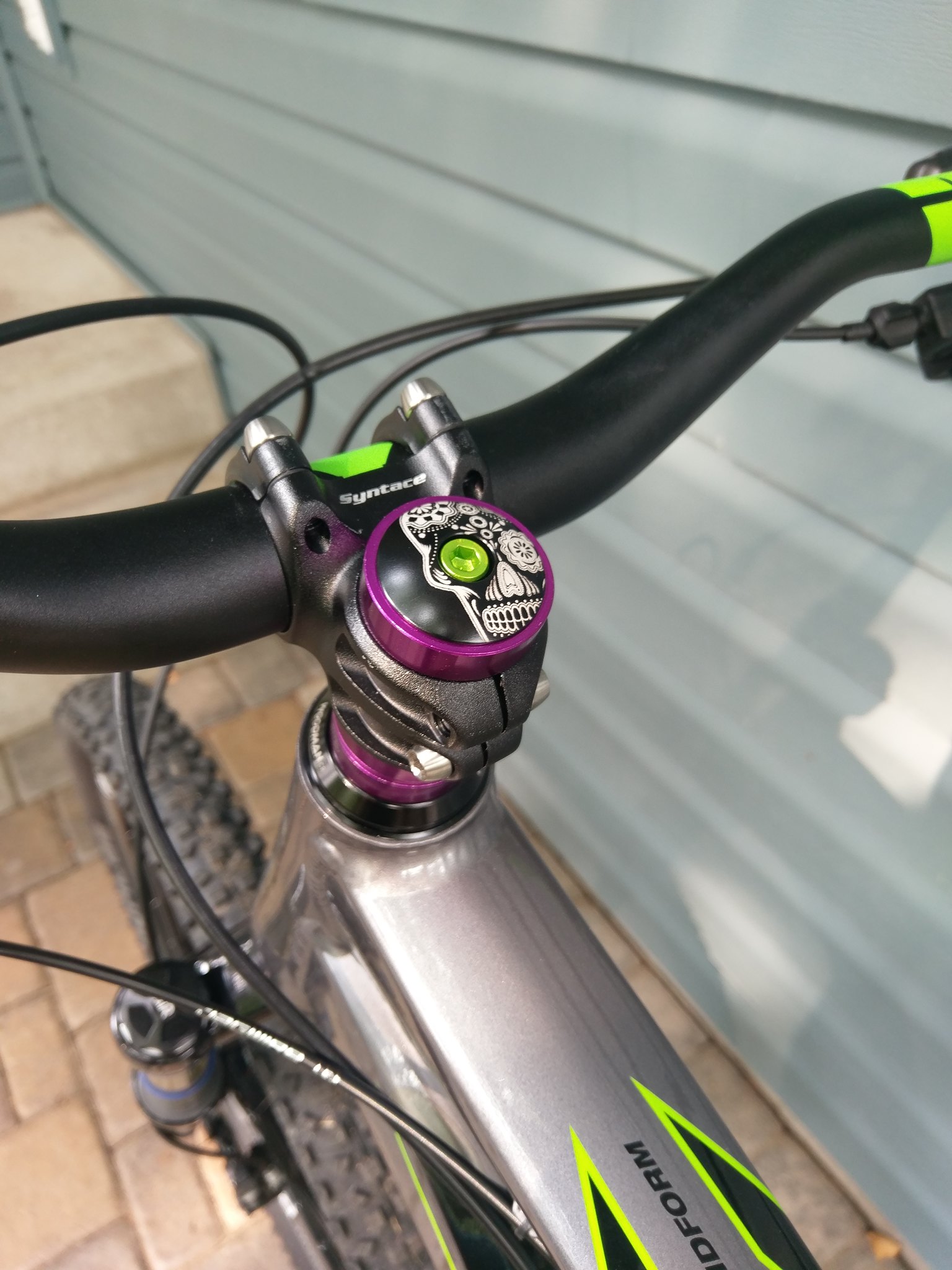

Well I got the bike fitting well now. I'm really liking the ultra short 30mm stem and long top tube of the XL frame. I never thought i'd like riding an XL frame, but this frame feels roomy, yet my body feels natural and not stretched out. I feel like I'm steering a downhill bike and I have lots of control. The wide 760mm handlebar helps with this too.
The headtube angle is a hair on the steep side for me so I might install a Works Components angle headset to slacken the fork out a degree or two. I'm going to see how the bike handles as an eBike first.
Now on to the motor. Leaf advertised the latest motor as having 3mm phase wires... well im measuring 1.8mm with insulation. These wires are tiny and not very highly stranded. I'll probably remedy this before installing the motor. The wiring will do for now as I test everything.

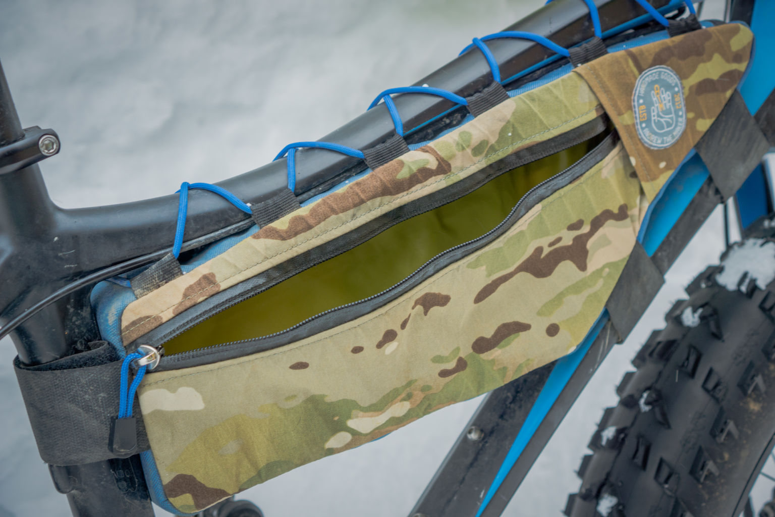

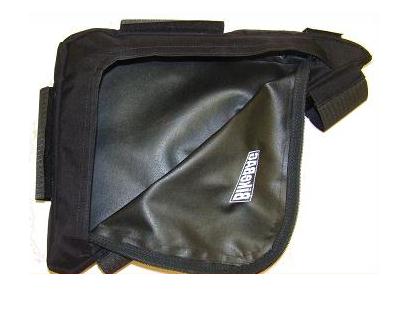

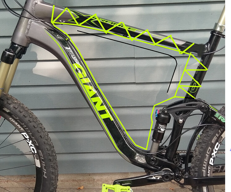

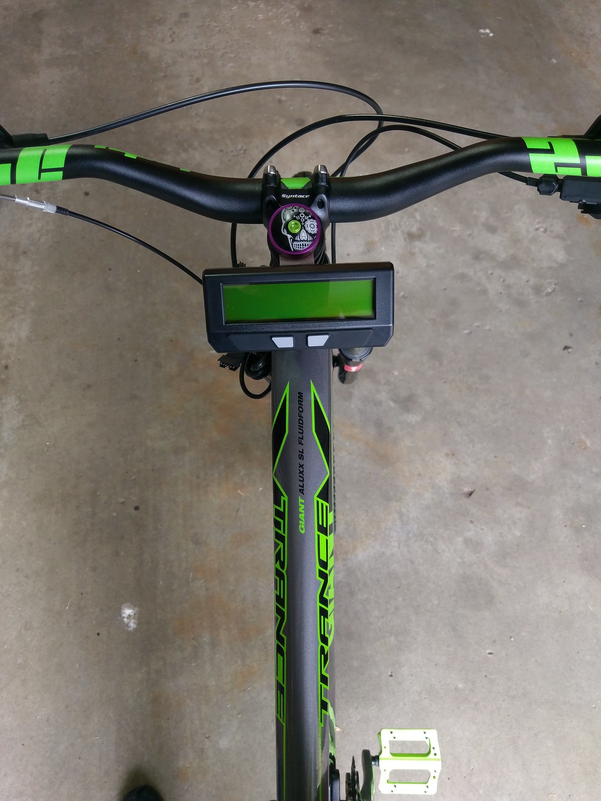

Been gathering ideas for a custom frame bag. I have a few places in mind that could make it for me at a reasonable price. I'd like to do this rope idea with neon green rope. The rest of the bag black, maybe with some dark grey. I'll have some internal velcro straps sewed in and some slits in the front and back to run wire into and out of the bag
Wish these Cycle Analyists were a little more low profile. This will have to do

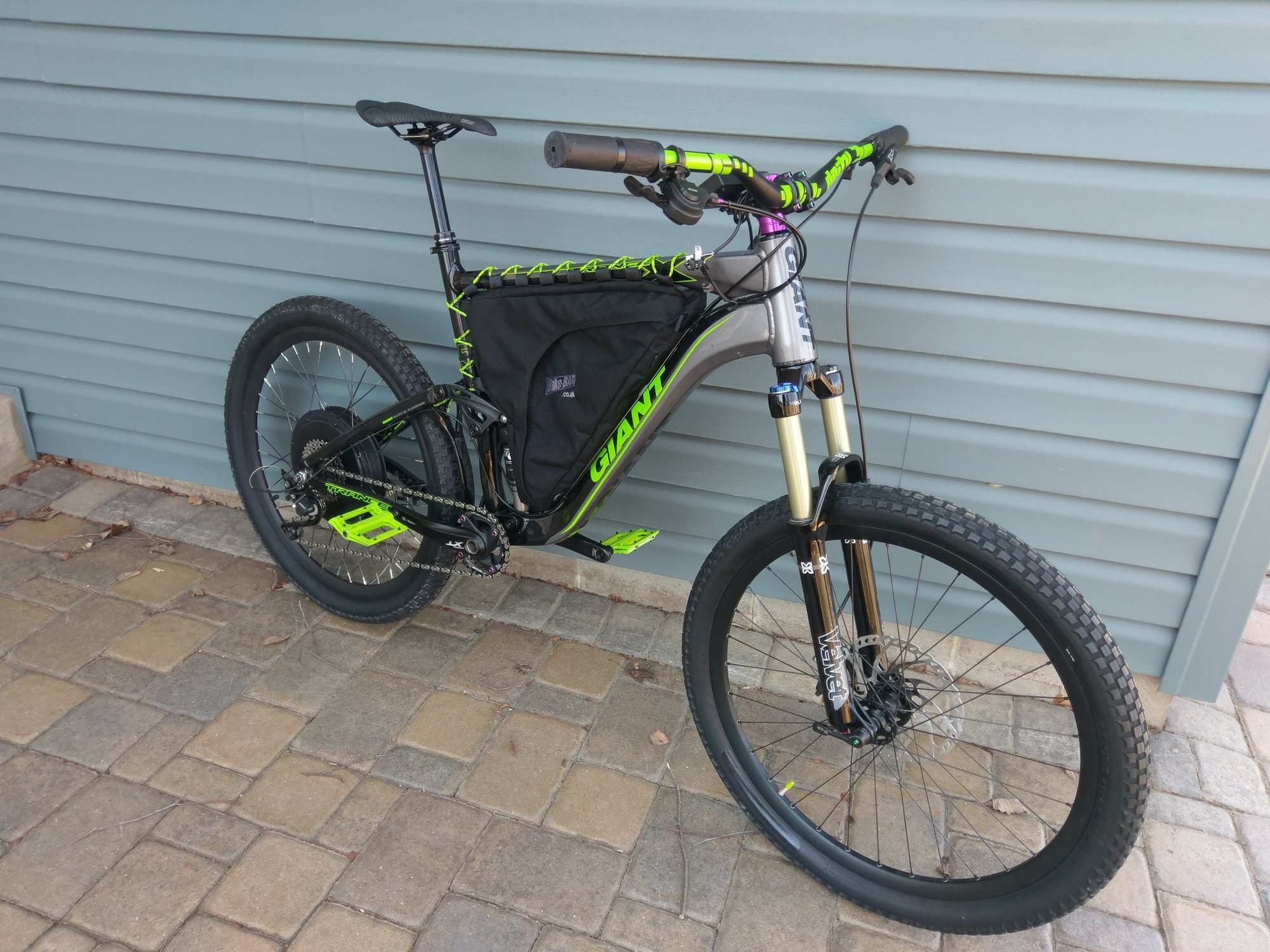

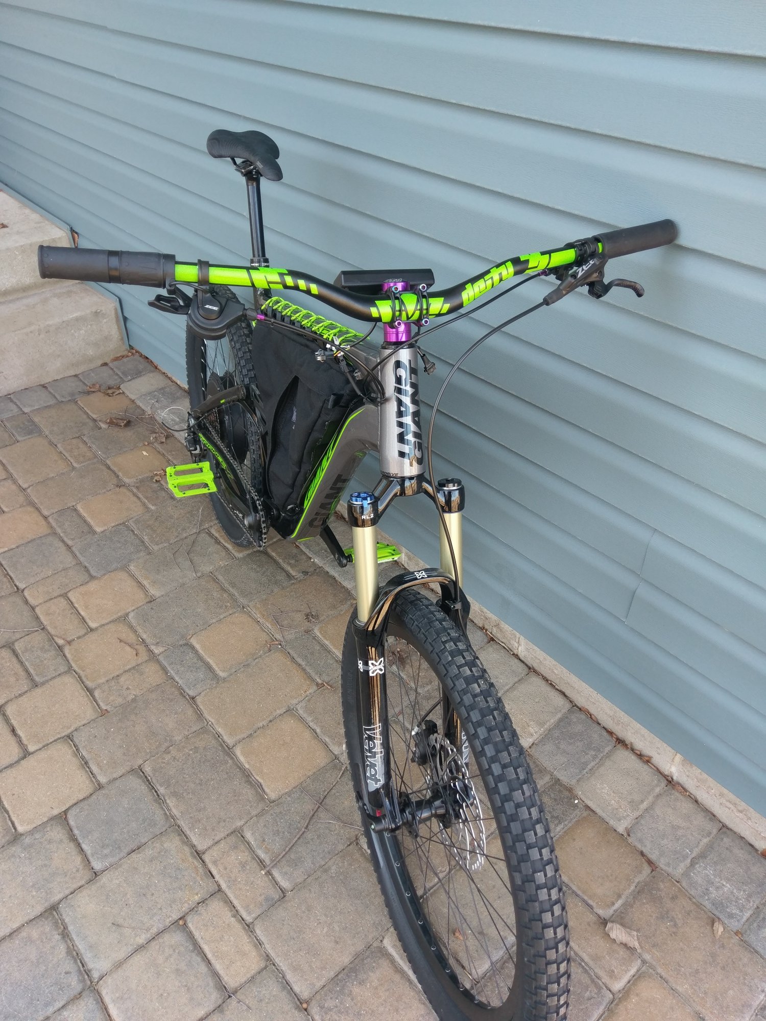

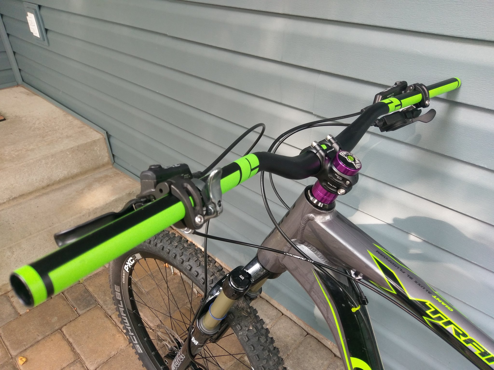

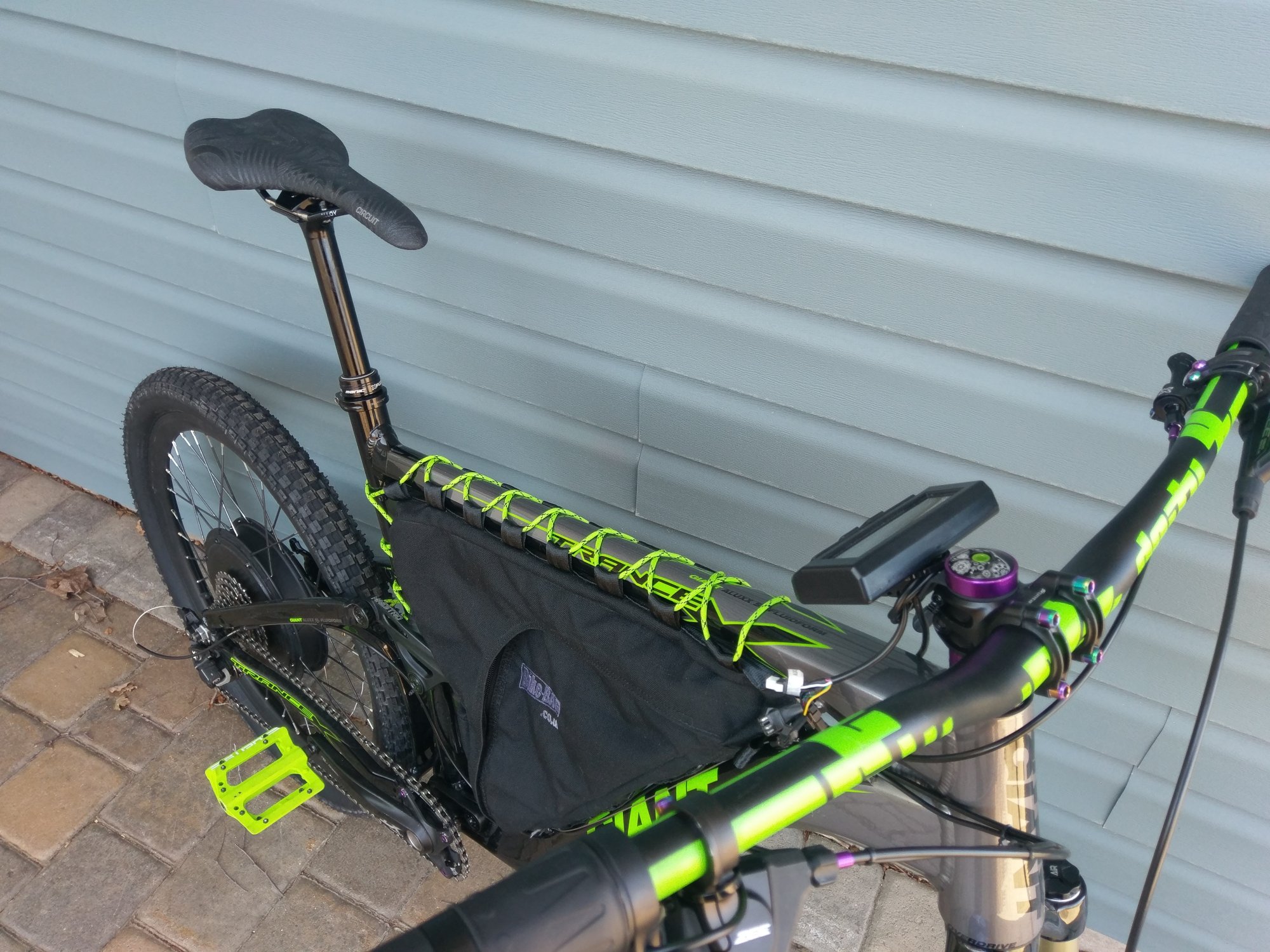

Post by dirt huffer » Mar 30 2019 4:39pm
Some updated pictures

It's nice having a bike with room for lots of batteries in the frame triangle. From the picture, I'm guessing that you could put upwards of 2 KW in there and get upwards of 60 miles of real range.
Have you considered building your own battery packs? I get my cells from NKON and they are about twice as cheap as anything I can buy pre-made (without counting my own labor).
Find weakest component, upgrade it, repeat until satisfied. Rome was not built in a day.

Post by dirt huffer » Apr 30 2019 9:15am
Pretty thrilled with my build so far. Last thing to do is set up the Regen. Not sure the best way to go about this. I have a Grin Tripwire Ebrake Cutoff that ill try on my front brake lever. Im not running a rear brake... i could possibly mount a small lever on the right side of the handlebar to operate the regen independent of the front brake - which might be nice. I guess ill try installing the Ebrake cutoff switch on the front brake first and see how i like it
