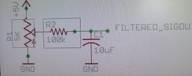

More on bldc speed kontrol:
As i mentioned before i am using a simple servo tester setup as throttle input, But not using e bike twist throttle. I would like to keep the stock brake levers so i will route a throttle cable to a linear potansiometer and get the voltage a output of the pot as throttle signal to the servo tester. The linear pot was 5k but the pot on the tester was 10k. Couldn't find the reason but it was difficult to set throttle off and max levels with the esc programming card.
I managed to run the system as i wish but start up was quite instable on the motor and any change in throttle was very harsh. Either settings for start up on the esc was too slow or too harsh.
So i ended up making a low pass r/c filter to smooth out the throttle transitions. It worked! 😁
You can find the details about the system in below pictures. Now i have a moderately smooth throttle.
