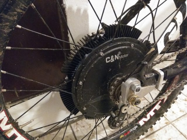

The bike used for this project is a downhill bike Giant Glory 1. It is a full suspension 26" bicycle with 180 mm front and 200mm back travel.

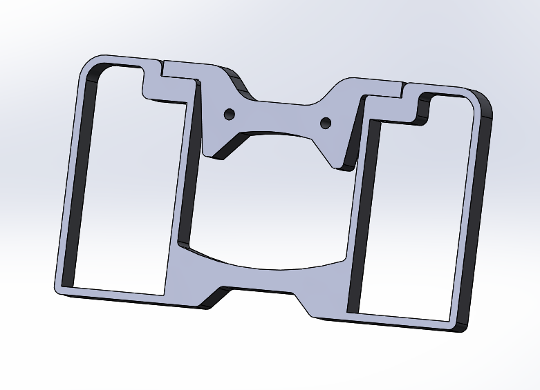

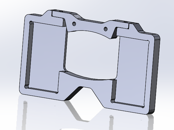

Before mounting the rear motor wheel some modifications had to be made. Because the existing rear hub was "thru axle" I had to machine two mounts the change it to standard 150 mm dropout in which the motor wheel fit. Because the new axis of rotation is now 32 mm off center the disc brake mount had to be modified. The disc brake rotor was also replaced with a bigger one.
Before machining the mount from aluminum I made few test mounts from MDF wood. The mount was spot-on after 3 iterations of trial and error. It was then machined from 20 mm thick 5083 aluminum alloy plate.

great job on the torque arms! What a great solution for thru axles. I haven't seen that before
Thanks. Having a small CNC helps a ton.

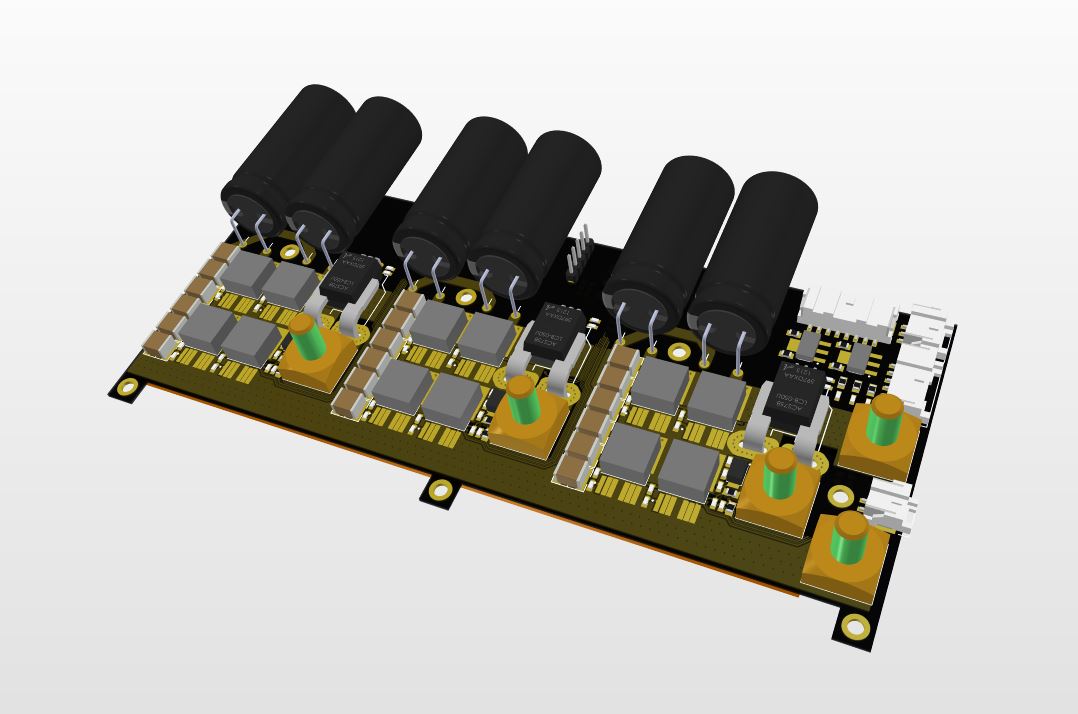

Btw: because 5 kW just isn't enough I'm designing a high power ESC based on VESC for my ebike. You can read more about it here.
Congratulation on your bike, I‘m very impressed indeed. I am wondering if you could post me additional photos and even better technical drawings of the dropouts you designed, and modifications of brake mounts as I plan to make similar project (in fact I want to use mid motor and IGH in the rear so I need to modify dropouts).
Excellent work and thanks for the 3d PDF.

I haven't used a mill or even got anyone to do that for me yet. Would you be interested in making an extra set? There could be a few people interested I'm sure.
If so what price could you do them for do you think?
No stress otherwise, I can look into getting them made here locally based off your excellent computer modelling.
Thanks, Lash.
Ok, happy to have a go at getting them done locally. It's been a long time (school days) since I've used CAD, so it will be good to have a play around and get up to speed with all this new technology.
So yeah, if you can send the step files that would be fantastic.

Good news. Got my custom controller up and running. Tested it to 60V 60A and everything looks very promising. :bigthumb: :bigthumb:

Unfortunately I'll have to set this project aside until semester finals are over. Can't wait to test what 200 A phase current feels like. :mrgreen:
Installed the controller in my bike and made some test with 200A phase current. Everything runs smoothly and I'm very happy with results. Acceleration is just insane although I think very low rpm torque is a bit lower than it was with square wave controller. Can't wait to test top speed but I'll probably have to wait until winter is over.
Because of FOC the motor doesn't make any noise. The torque is constant and there's no ugly vibrations at low speeds. It just goes, no noise, no nothing, just power. Almost like magic. :mrgreen: :mrgreen:

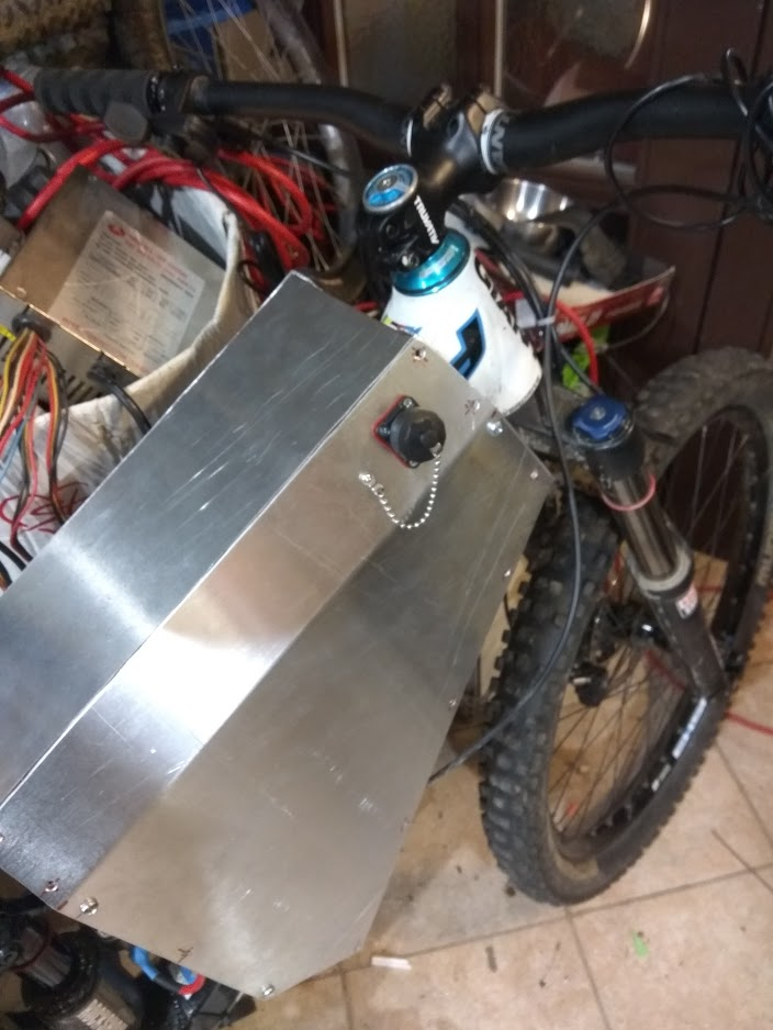

Here's how the enclosure looks like without the side panel. I added a rubber seal on the edge to prevent dust and water from entering.
Here's how the whole bike looks now. It isn't too bad. Actually it looks a bit better when a person rides it. There's some tape on the edges I put there for testing because the enclosure is either missing parts or is not sealed yet in some areas.
