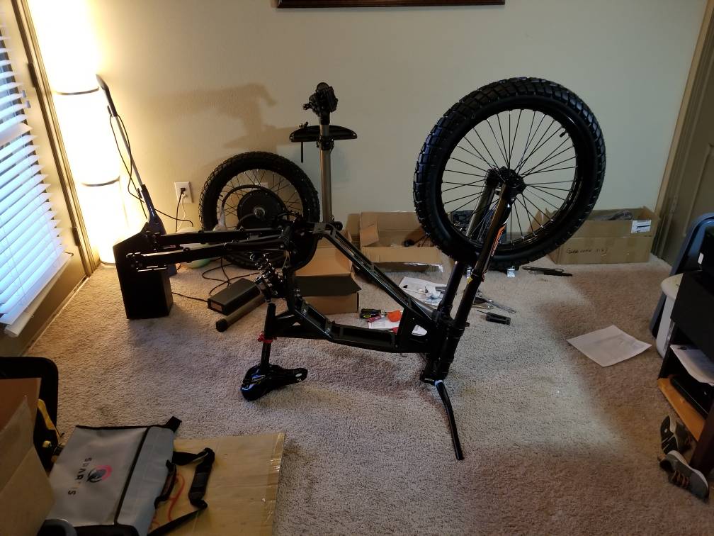

Hey peeps. I have been lurking and gathering info for a bit and pulled the trigger on building a high performance ebike. A lot of great info on this site and helpful members. Got my wife a set of diamond earrings for Christmas to lessen the blow back and ordered everything last night.. lol. Here are the highlights.
*EEB Frame w/battery box
*QS 205 v3 5T, laced on 19s, 19 F moto wheels.
*Custom 72v 36ah, 30q, battery made to fit eeb battery box w/150a bluetooth bms, 180a peak, made by Hi-C battery.
*Sabvoton 72150
*Magura MT5E
*DNM 8S
*Hubsinks/statorade
Thinking about drilling 1in holes on motor casings between ribs and use sealed bearings and coat the stator with a high temp water proof coating.
Now it's the waiting game... Super stoked!

Statorade and hubsinks are far more effective than holes in the motor. Makes it non waterproof too.
Yeah. Imma second Tommm here.
I have a similar build... QS205 50H V3 3T motor, Hubsinks + Statorade, laced to 18" moto wheels running off a KLS7230S pulling 120A at 84v and use a 20s 14p pack capable of 200a. Bike weighs in at 157lbs with the current accessories installed.
I can drain the entire battery in under 40 mins while running hot laps at the local kart track. In the past, I honestly had a more difficult time keeping the controller from going into thermal protection during track days than I ever had with keeping the motor cool.
Even with sealed bearings and a proper coating job, you are just asking for more trouble than it's worth. Old school hot-rodding was drilling holes in the case or adding some pc fans inside the motor, these days we have fairly maintenance and worry free FF + hubsinks that work just as well or better in some cases.
Try the motor out before drilling anything. If by chance you can get the motor to overheat
even with hubsinks and FF, then get all holy with it.

Thanks for the info! It's good to hear the way you run it the ff and hubsinks are efficient. I'm worried that running it hard on dirt moto tracks would over heat it pretty quick. Wondering if it is more effective running all 3 previous heat reduction options together... ff shouldnt fling out..

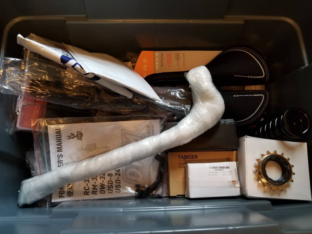

Merry Christmas everyone! Got a couple of things early! Motor/controller/wheels coming in a couple of days. Things are trickling in. Hopefully I can recieve my battery the first week of Jan.
Sent from my SM-N950U using Tapatalk

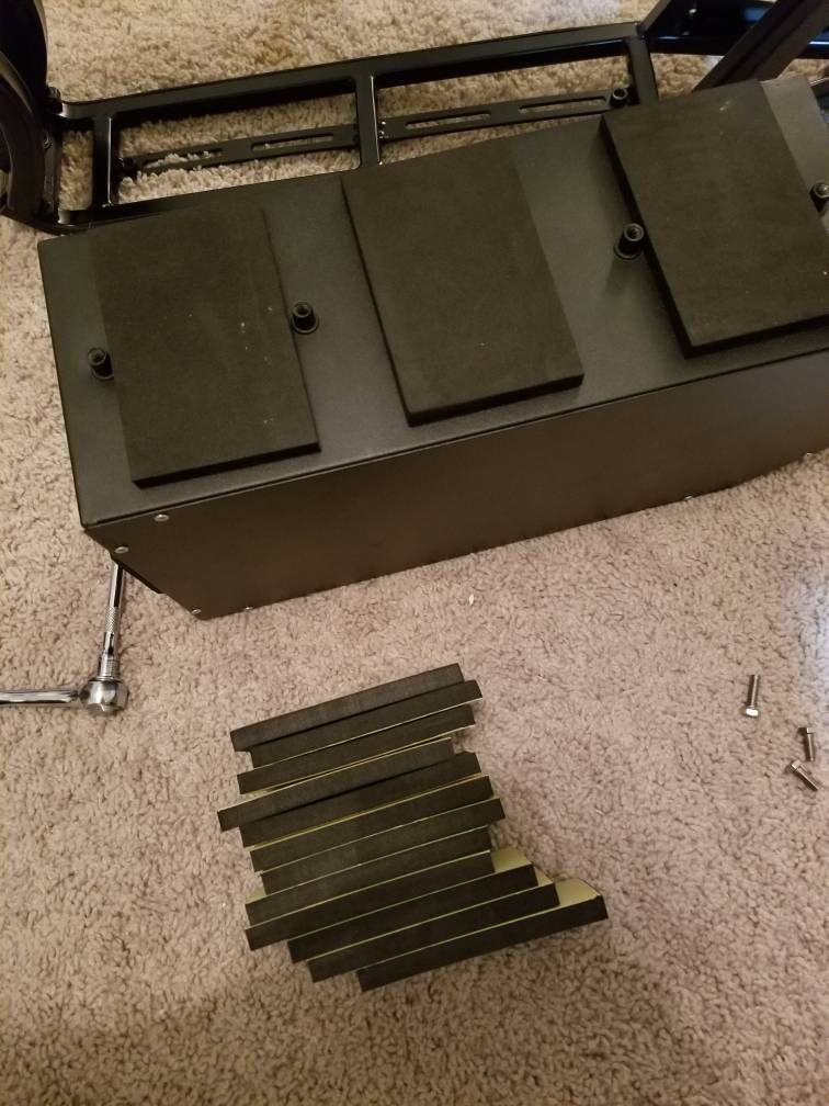

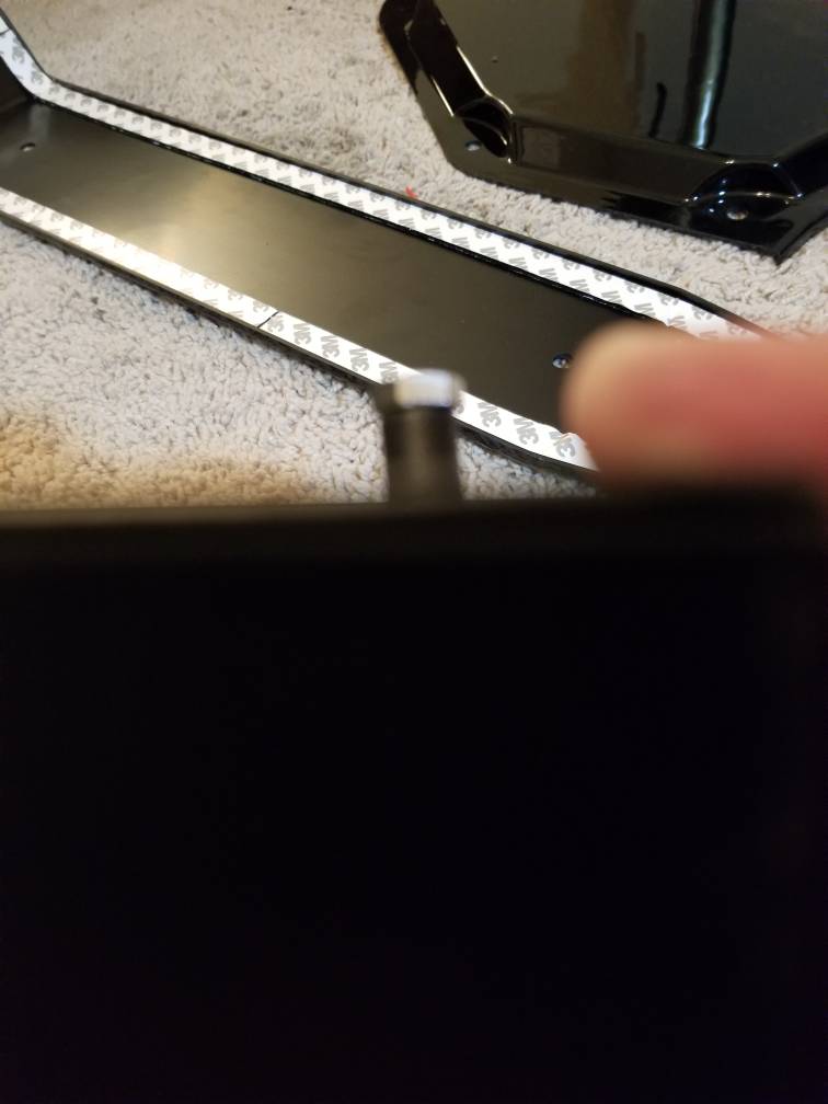

So today I unpackaged the eeb frame from em3ev. Everything looks great.... but they sent me the wrong swing arm bolt. o_O and definetly I need to file out the holes on the frame where the rear shock bolts attach to the frame. Is it just me? Or did I get the Friday build, lmao. Definitely quality issues. Unpackaged the battery box from enduroebike.com.... lmao missing 2 screws and one of the mount points were bent. Definetly a Friday build. Lol.
I guess enduroebike.com made up the 2 missing screws by sending me a shit ton of padding for the box.. lol I can literally cover the whole exterior of the box with them. Hehe. I got skimped 3 bolts..the long one is perfect with the padding, the 3 short ones dont even reach. Smh.

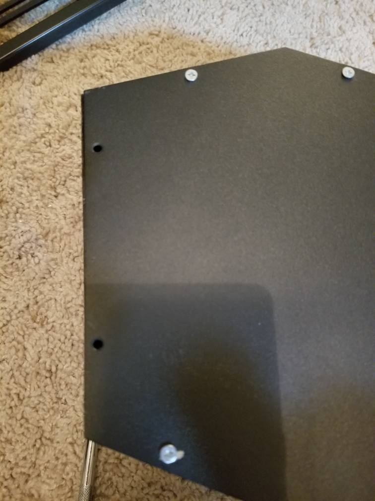

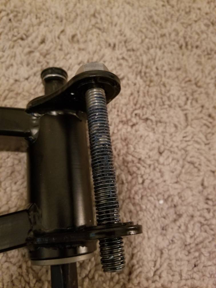

After a closer inspection, it seems the tube were the bearing sits is not aligned properly? Hopefully I dont have to send this frame back.
Ok problem solved I think.. lol. Got some advice from members here and fb, found out it was a bushing that could be adjusted with some elbow grease. Whew. First thought it was wielded due to not budging with ease. Had to really knock that sucker where I wanted it to move a bit. Now the bolt slides in. Definetly going to look for some aftermarket bushing/bearing kit to replace it with.

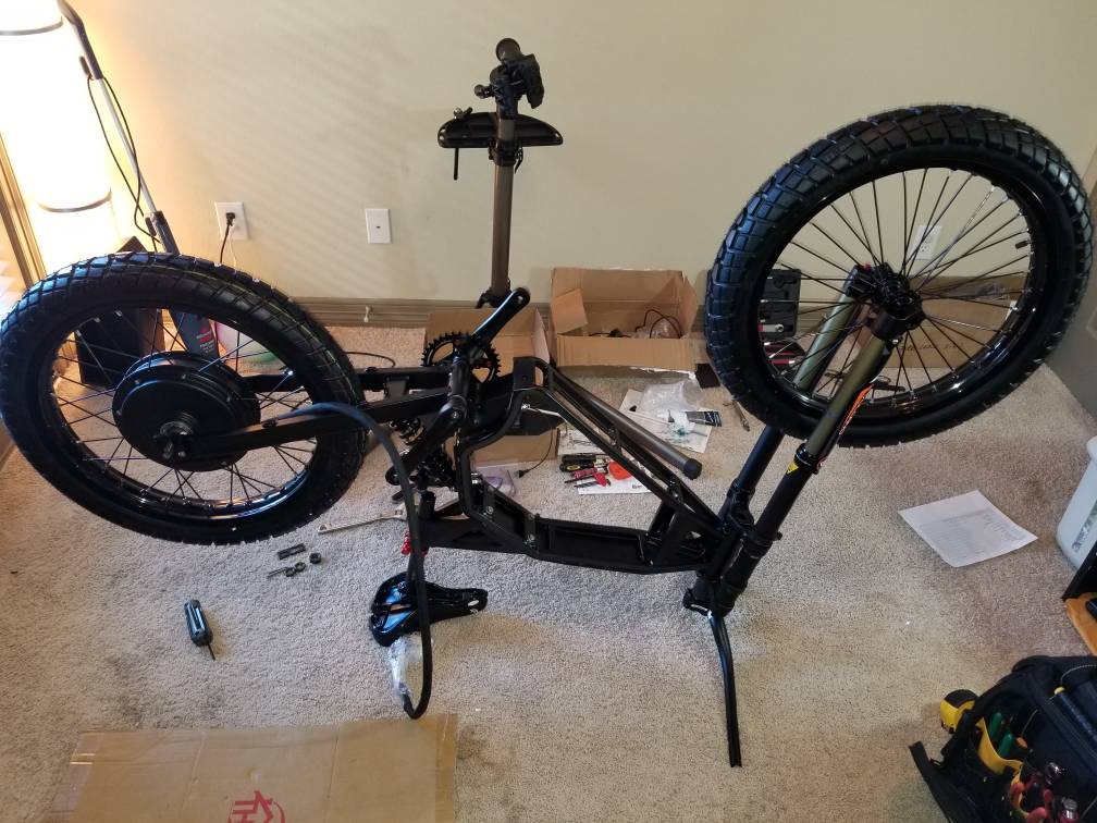

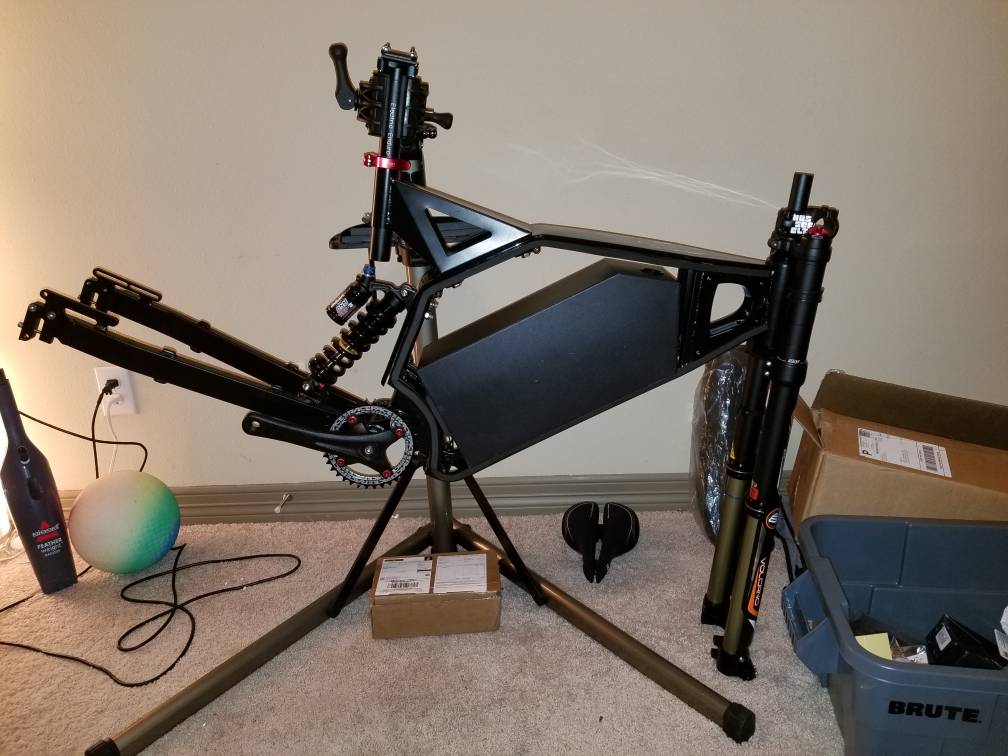

Thought I update my thread, been a while... been super busy with work and family, but managed to make some progress on my build after I resolved the issue with the swingarm bolt not fitting correctly. Still waiting on my battery tho, hopefully should be in a week or two. Hubsinks and statorade should be here tomorrow.
Still cant figure out the what to do with the rear rotor. I have counter sunk the screws, tighten the hell out of the wires with zip ties and it still rubs a bit. Might need to look into a tad bit thinner rotor then the magura ones or maybe position the wires so they come toward the back instead? Maybe a long tube washer of some sort? Or I might just not run the rear brakes at all...
The sabvoton 72150 is huge. Its base is a tad bit bigger then my battery box. Have it zip tied to the box and frame for a mock up, but gonna get some L brackets to secure it tight to the battery box. Super tight fit within the frame.
Build is coming along well Chris. The swinging arm bearing,is it a sealed bearing in there or is it a like moulded rubber bushing? Cant quite tell from pictures? Looks like a bearing? Keep the posts coming. :bigthumb:
Choppa66 said:
Thanks brotha. It's a sealed bearing. Hopefully I can get this built up by next week. Cant wait to ride this thing.

No worries. The bearing on the stealth style enduro bike I'm building and other guys on here like shortcircuit have a moulded rubber bushing with a steel sleeve through it and there not good,make the swing arm wobbly and fishtail at speed. There is a kit available for these to replace the rubber one with a bearing the same as you have so hopefully you won't have that problem. The motor wires are a pain in the a## arent they!! I've had to do the same as you and counter sink the rotor and replace bolts with counter sunk bolts but it's still so tight there. I wish they would change the design of the motor axle so that wasn't a problem? If the wires short out then it will blow up the speed controller and that will probably cost more than a new motor to replace!! Crap design from the motor manufacturers.
