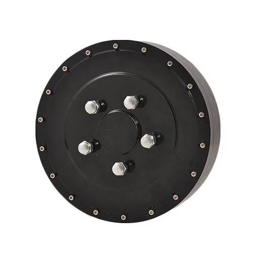

Hi all,
I'm getting a second car for getting to/from work for times when I can't ride my electric bike like when it's raining or it's broken etc.
The only real criteria I have for the car is that it runs reliably and gets me from A to B. After doing a bunch of research on the cheapest car to buy and run I settled on a Mitsubishi Mirage.
My wife actually owned one when I married her 7 years ago and it was our main car for the first couple of years of marriage. It was a great little car and we only sold it after it was damaged in a hit and run and was going to be too costly to repair.
Anyway, I decided I would like to tackle converting a Mirage be able to run electric without removing it's ICE engine. I don't have a whole lot of experience working on cars so will tackle this with the KISS principle first and foremost.
So I think I've found an ideal car and might go pick it up this weekend:
http://www.carsales.com.au/dealer/detai ... -13183080/
I was keen to get a 2002-2003 model, but then discovered they added power steering after 2001, and from what I understand power steering can make it difficult as they tend to suck a lot of power. If this isn't the case please chime in as I would also like the airbag and aircon added to the later models if I can get it, but not super fussed.
The plan as far as electric motivation is concerned is to add 2 x 8KW QS motors to the rear wheels.
As for controlling them, I actually thinking of getting 2 x Adaptto MaxE's and linking them together. What do you think?
With adequate cooling on the controllers, that would allow 20KW peaks (per motor) which would be sure to get the little hatchback moving. Built in temp monitoring on these controllers would make it super easy to push the hubs hard without fear of melting things down.
For batteries, I would probably start with 4-8Kwh of LiPo and place it in the spare wheel well and ditch the spare. That would be more than enough to get me the 50km to/from work I think. I would also like to rig up a 12V charger so I could charge the main pack off the ICE motor.
At this early stage there are only a few things that come to mind as potential problems:
1 - Torque capturing. I have no idea how the torque of a hub motor is captured in a car and no idea how Regen effects this.
2 - Disc brakes. I'm pretty sure the Mirage has rear drum brakes. I have no idea how to convert them.
3 - Dual power plant control. I plan to make it possible to run the ICE engine at the same time as the electrics, or independently, so making the control system work will be a little tricky.
Also, before everyone comments on this not being the best idea...yes I fully realise this thing will weigh a fair bit after everything is done...and performance will not be great. That's part of the reason I'm starting off with a sub 1000kg hatchback. My needs (for now) only extend to the 50ish km range. This is also a learning experience for me, so I'm sure I will have to learn some things the hard way as I always do. :roll: :lol: 8)
So what does everyone think?
Is this a stupid idea...why haven't I been able to find anyone else trying this?
Cheers

Have you looked over on DIYECar ?
A few folk have tried using similar hub motors with limited success.
ES member Ripperton also used a pair to power a small hatch, It did run for a while, but he had to give up after many frustrating problems and failures

Thanks for pointing that out to me Hillhater!
I just read through the first 25 odd pages of Ripperton's thread and have determined several things from reading it.
1 - I'm somewhat naive, and to think that this would be simple is an understatement.
2 - Rippertons issues with using hub motors stemmed primarily from low speed take off cogging caused by a combination of the kelly controllers power limiting features and the KV rating of his hub motor's not being the best match to his battery voltage choice.
3 - Even a sub 1000kg car is not going to be light enough to make this work.
So based on all that, I think I need to re-evaluate my initial hatchback purchase. I actually like the Daihatsu Mira and might look around for one of those cheap as well.
The other big question I've recently realised is how do I make this legal. Reading through Rippertons conversion, there's 0 mention of compliance requirements etc, however one of my work mates reckons it's a minefield as soon as you start changing anything significant on a car and having never done anything like this before I haven't got a clue.
Any local Aussies know...what's really involved in doing this kind of thing? Will I need to get the car re-engineered, etc?
Cheers

Actually scratch that...just read the rest of Ripperton's thread and after seeing the damage to his Mira from a mere 40kph crash, I'm not keen to repeat that.
I also think I won't be able to do my conversion any time soon...I have to save enough $$$ first...I don't have anywhere near enough gear/tools and/or experience yet either.
That being said, I would still like to buy something now that I will eventually be able to convert, but if it's going to have to be driven as a wet weather commuter for years to come first, I don't exactly want something that will break down, hurt in a crash, or be uncomfortable either.
So with all that being said, I think I'll keep a lookout for reasonably priced 2002/2003 Mirage as was my original plan. I will worry about it's power steering later. :)
Cheers
