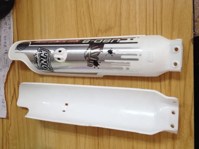

Hi, I really need to get it
Fork Fenders DNM USD-8 upside down downhill fork protector bicycle fork parts
Send to the Czech Republic.
Or send a link where I buy this part.

Too expensive for those dumb plastic parts. I've made one myself using Sintra plastic, heat gun and can of black paint.

Awesome job. I want to make these too, the ones DNM makes are flimsy as hell, and they want $80 after shipping for replacements? Hell no.
What mm plastic did you go with from that site? And do you think my Black & Decker 1375W 1000 degree Fahrenheit heat gun do the job?
Thanks!

I did not purchase at that site. I've sourced a ~5mm sheet locally. Sintra board is hard but foamy, other plastics may be used. If more dense use less thickness. Policarbonate, polypropylene. Almost all plastics can be shaped with a 5 dollar cheap gun. Good luck and post pictures if you make it.
