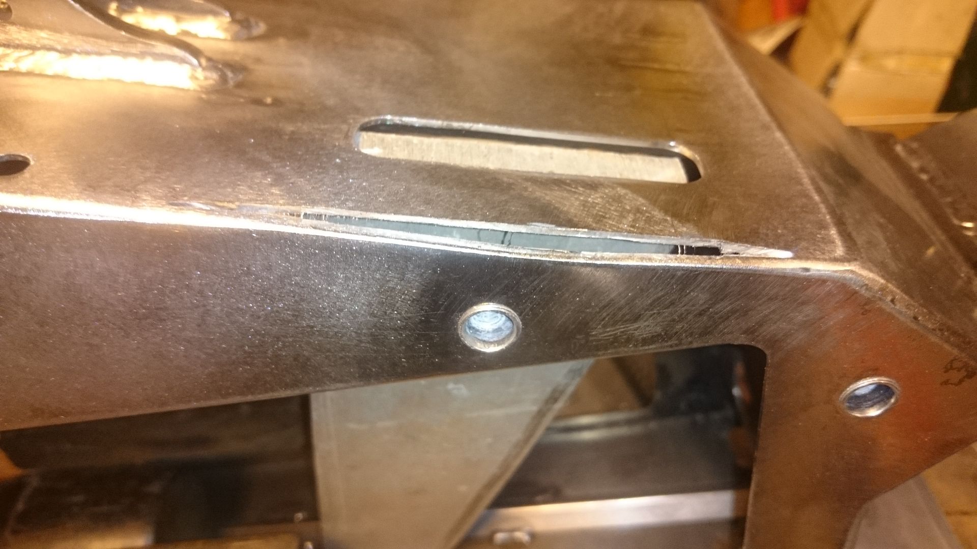

I started on my "yearly service" on my fighter this week, and I have fractured the steelframe on the battery box once again at the same spot it was fractured last time. Is it only me that have problems with frame fractures? I'm only 65kg and I don't think that's to heavy?
No you are not alone. My frame also cracked on the top were the seat post frame met the frame. But i welded it up again my self and re powder-coated the entire frame and swing arm. And reinforced the heck out of the frame. Now it's much better than new.
Her you can see the cracked frame.

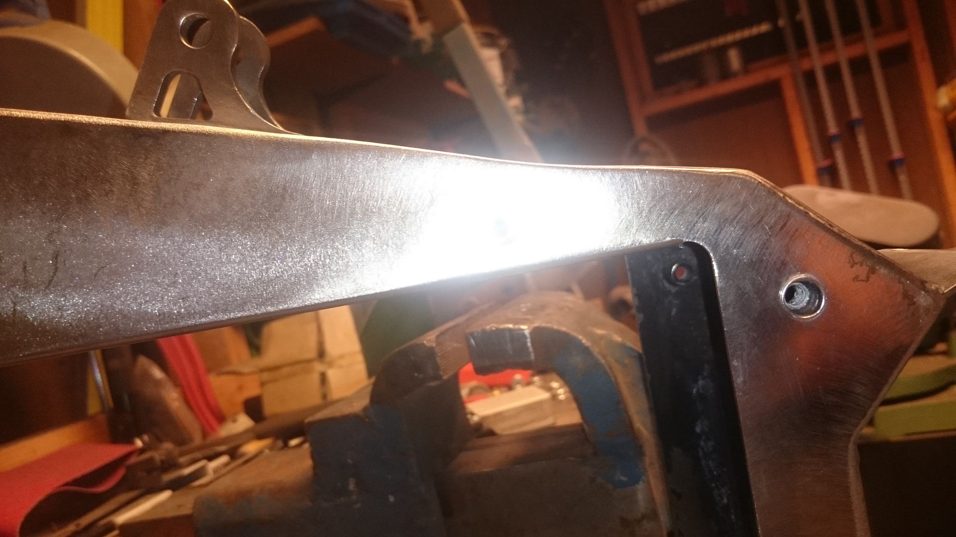

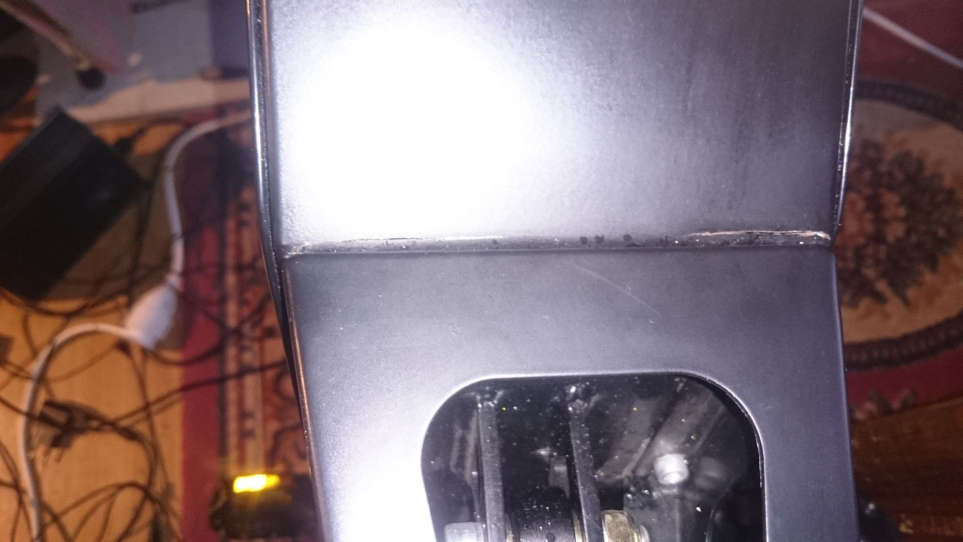

But my frame had some strange kinks and dents, Manufacturing faults from the factory, That I decided to fix and get rid of. This one and one on the top of the frame.
Picture shows how mutch I had to re weld to straiten it out.

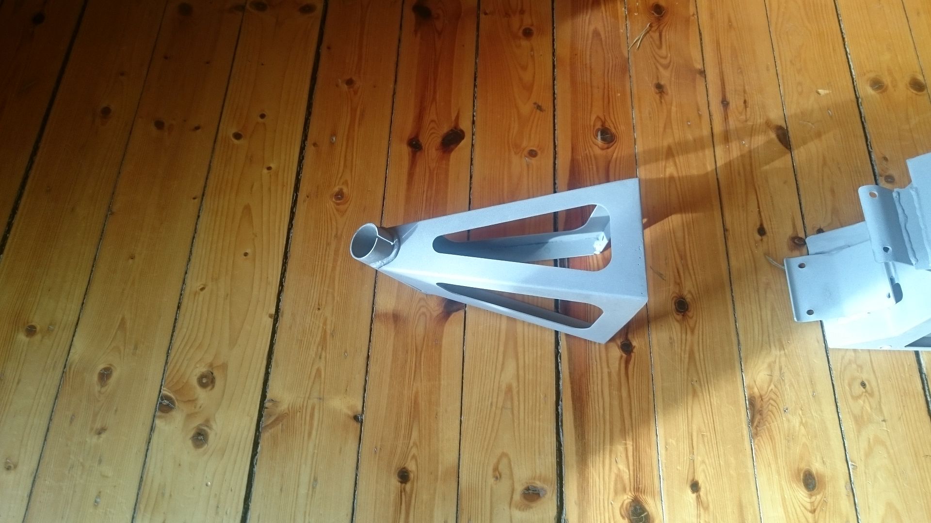

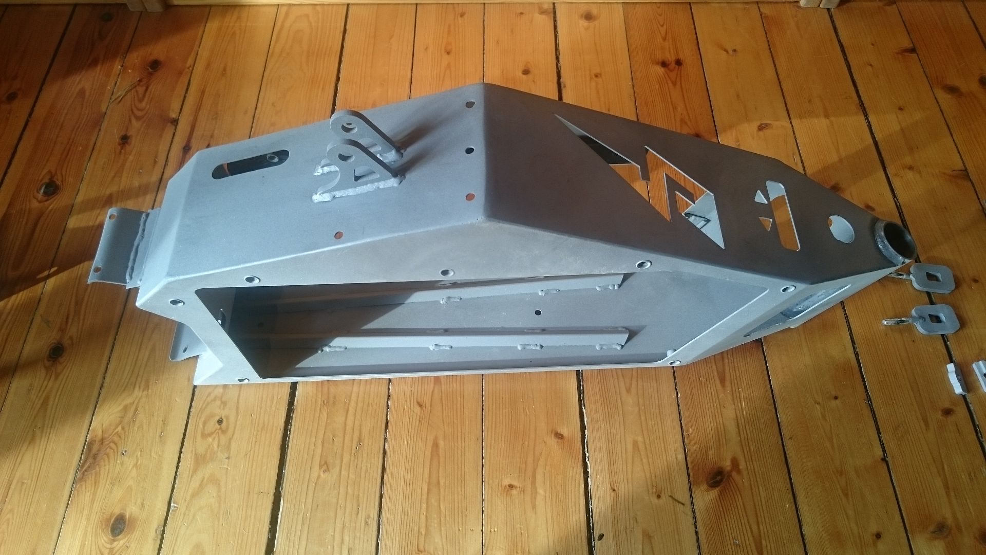

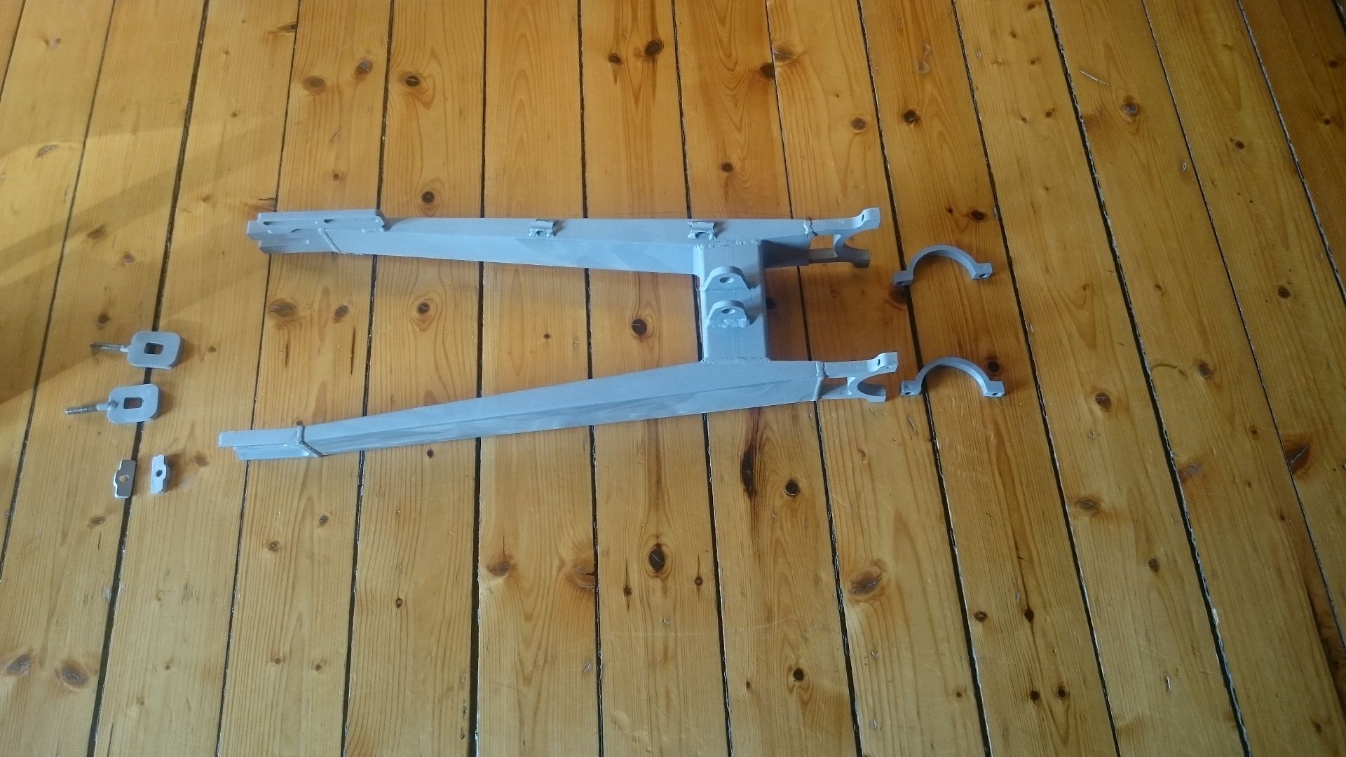

Frame and swing arm, and all parts were sandblasted before Powder coat
Complete time from start to finish 10 days.
