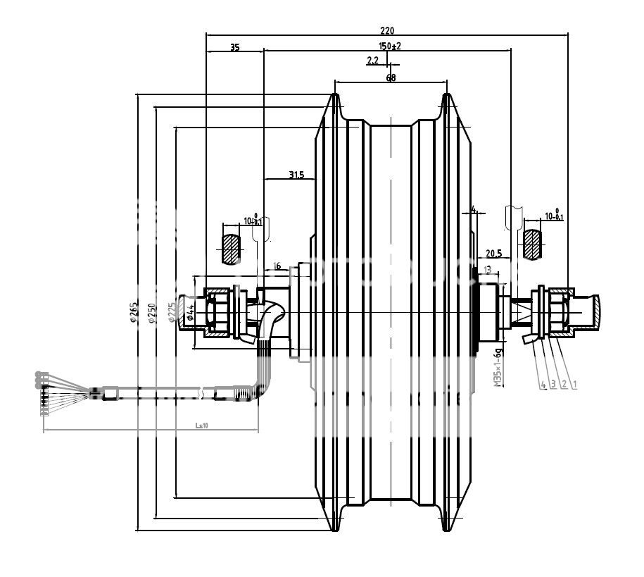

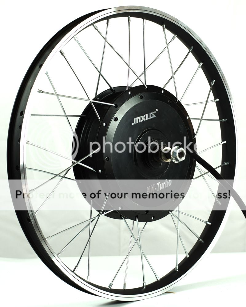

MXUS sent me some info on a new motor they are going to be building, model number "XF5K"
It is a 55mm wide magnet design, which is 5mm wider than either the QS 205 or the Cromotor.
They rate it at "5000W"
Here are the specifications we know so far:
Stator Material: Unknown
# magnets/Pole Pairs: 32 magnets & 36 tooth stator design.
Magnet Height: 55mm
Standard Winding: 33x3T
Kv: 13.47 (970 RPM at 72V, 4A unloaded)
Rated Max. Torque: 110 Nm
Drop-out Width: 150mm, 220mm wide axle, overall. M16 X 1.5 Threading, with 10mm flats.
Weight: 13 Kilograms.
Single-Speed freewheel, M35x1 Threads.
Phase wires: 6mm2 (about 9 AWG)
Dual sets of hall sensors & KTY83/110 temperature sensors
Left side cover accepts disc brake rotors.
Stay tuned. More information to come! :D

13kg is almost twice the weight of the mxus v3!

MXUS 3K-Turbo is 9.3 Kg. so the 5K is about 40% heavier.

Samd   1.21 GW
1.21 GW
Posts: 3667
Joined: Jun 28 2011 11:08pm
Location: Ballarat, AU
MXUS coming out with a 5K motor, 55mm Magnets
Post by Samd » Dec 29 2016 2:37pm
Thanks Barent, install width noted.
250mm spike dia. Nothing like and extra inch inside the flange up the rear.

at "5000W"
is that continuous or peak power ? 13kg wow that's a boat anchor heavy...
Based on weight alone, I'd say Continuous.
Lots of guys run the MXUS 3K-Turbo motors at over 14KW peak with the Adaptto Max-E.

madin88   100 MW
Posts: 2966
Joined: May 27 2013 2:02am
Location: Austria
Re: MXUS coming out with a 5K-Turbo motor, 55mm Magnets
Post by madin88 » Dec 30 2016 3:32am
thanks for keeping us informed about new stuff from MXUS! :)
LOL, the amp that goes to 11 is indeed similar to the watt rating bullshit of most motor companies..
250mm outer dia would mean a whole new stator.
on the drawing, the axle looks larger as 16mm, but i could be wrong..

burner77   100 W

What bothers me is the itty bitty phase wires. The 3000 watt QS 205 V3 has 10mm and this new 5000 watt 55mm MXUS has 6mm? Basically a 7 gauge wire for the QS and an 9 gauge for the MXUS. That seems to always be the downside of MXUS. Now I know that a wider stator will make more torque/power but at the end of the day under sized wires is just that, undersized. Specially or should I say specifically for this crowd here of over volting & over amping abusing what ever they can with too many electrons being stuffed in things they don't belong in! I do however love to see it and recommend it on a daily basis. Nothing better than a "watch this" moment.
When you look at the 4000 watt QS273 Ebike motor it has 16mm sq wires which is about 5 gauge.....good gawd!
I'm not saying this isn't awesome but it looks like inflated "horsepower" wars and consumer mass confusion.

litespeed wrote:What bothers me is the itty bitty phase wires. The 3000 watt QS 205 V3 has 10mm and this new 5000 watt 55mm MXUS has 6mm? Basically a 7 gauge wire for the QS and an 9 gauge for the MXUS. That seems to always be the downside of MXUS. Now I know that a wider stator will make more torque/power but at the end of the day under sized wires is just that, undersized. Specially or should I say specifically for this crowd here of over volting & over amping abusing what ever they can with too many electrons being stuffed in things they don't belong in! I do however love to see it and recommend it on a daily basis. Nothing better than a "watch this" moment.
Tom
With a 33X3T winding, the total cross-sectional area of the motor's windings is 6.47mm2 so a 6mm2 phase wire size is slightly undersized. Put in other words, the phase wires will get hotter than the windings.

teslanv wrote: With a 33X3T winding, the total cross-sectional area of the motor's windings is 6.47mm2 so a 6mm2 phase wire size is slightly undersized. Put in other words, the phase wires will get hotter than the windings.
In real world, the phase wires wouldn't even be hot to touch when the windings already turned into plasma. The phases wires normally will give off many times more heat compared to the coils.
What i don't like is the voltage drop and the involved decrease in "torque stiffness". For 5T or higher turn winding it would be OK.
Is it 205mm stator now or, wider?
From the 225mm OD of the back iron it might be the case, but the large 265mm outermost dia is a bit strange..
Magnet Height: 55mm

Barent and I have asked for samples and trying to firm up timing. The only one in existence is a CNC sample.
I am hoping everyone has noticed the magnet and spoke radius - it won't be a stealthy unit to hide behind a 203mm brake rotor. Haha!
