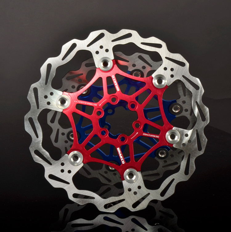

I'm on the lookout for reasonably priced 8" rotors with a non-directional pattern to prevent the inevitable reverse installation of the symmetrical wheel by end users. Any ideas?

Brakco? Closer to a bi directional design. Float points and outer slots not.

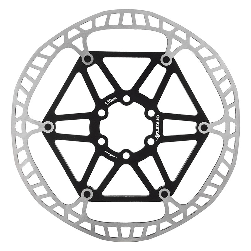

Origin looks to be fully symmetrical, but possibly some cbore at the mounting screws. Not sure outer slots on the lower cost option would be a issue. KCNC also with a nice lightweight design. https://www.ebay.com/itm/Origin-8-Speed ... SwVqlaHClC

Odd folks think your rotors are mounted backwards. As a man who has overheated and wadded up a half dozen bicycle brake rotors into a hot mess of steel, I found mounting them they way you did so it pulls on the rotor spokes vs pushing on the rotor spokes enabled them to survive much longer at extreme temps.

Iv'e also always thought rotors should be mounted that way as well. Seems like in the case of a catastrophic rotor failure you would want the "spokes to fold away to a smaller radius rather than growing to a larger radius and stabbing everything. I guess its probably silly to try and apply logic to such a chaotic event.
In the picture, they are backwards relative to their directional markings.
I think the idea is that leading spokes exert an expanding force on the outer ring of the rotor, which helps keep it straight by means of hoop tension. Trailing spokes contract against the outer ring, promoting buckling. I don't know how much of this is founded in test results.
The first disc brakes I owned in the early '90s were Mountain Cycle Pro-Stop 9" full floating cable-hydraulic brakes with hard anodized aluminum rotors. They were labeled specifically to have trailing spokes when mounted, contrary to common practice today.
I figure I'll mount them the way the manufacturer suggests, all the while wondering why more disc rotors don't use a non-directional pattern.

Wow. I'm not an engineer but as a machinist I dont like anything about that rotor design. In my experience with steel you typically want to avoid sharp corners and avoid thin sections that concentrate heat/stress. That rotor looks like the worst possible design for the heat and loads it would be under. Just eyballing it though.

Buckling the spokes from compression in a rotor happens way easier than pulling on them until tinsel strength failure.
You really want some offset in the spokes vs being radially arrayed, but just like in a bicycle wheel you want to be pulling on the spokes and with a hub exit offset.
Most bicycle brake rotors I've seen looked like they had artists make the designs to look flashy rather than doing a mechanical stress optimization.
