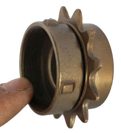

Yep, I ran into the same problem. I've gone with a 40t chain ring and I would say it is probably the largest that will fit in the frame.
Combine that with a (14-17-20T) 3 Speed Freewheel and it's ok to pedal up to 40kph.
http://r.ebay.com/JMO7Q8
Does that 3spd freewheel have the right threads for a hub motor?
I'm not sure Shorza may, seems like a nice option but id prefer a 12t
