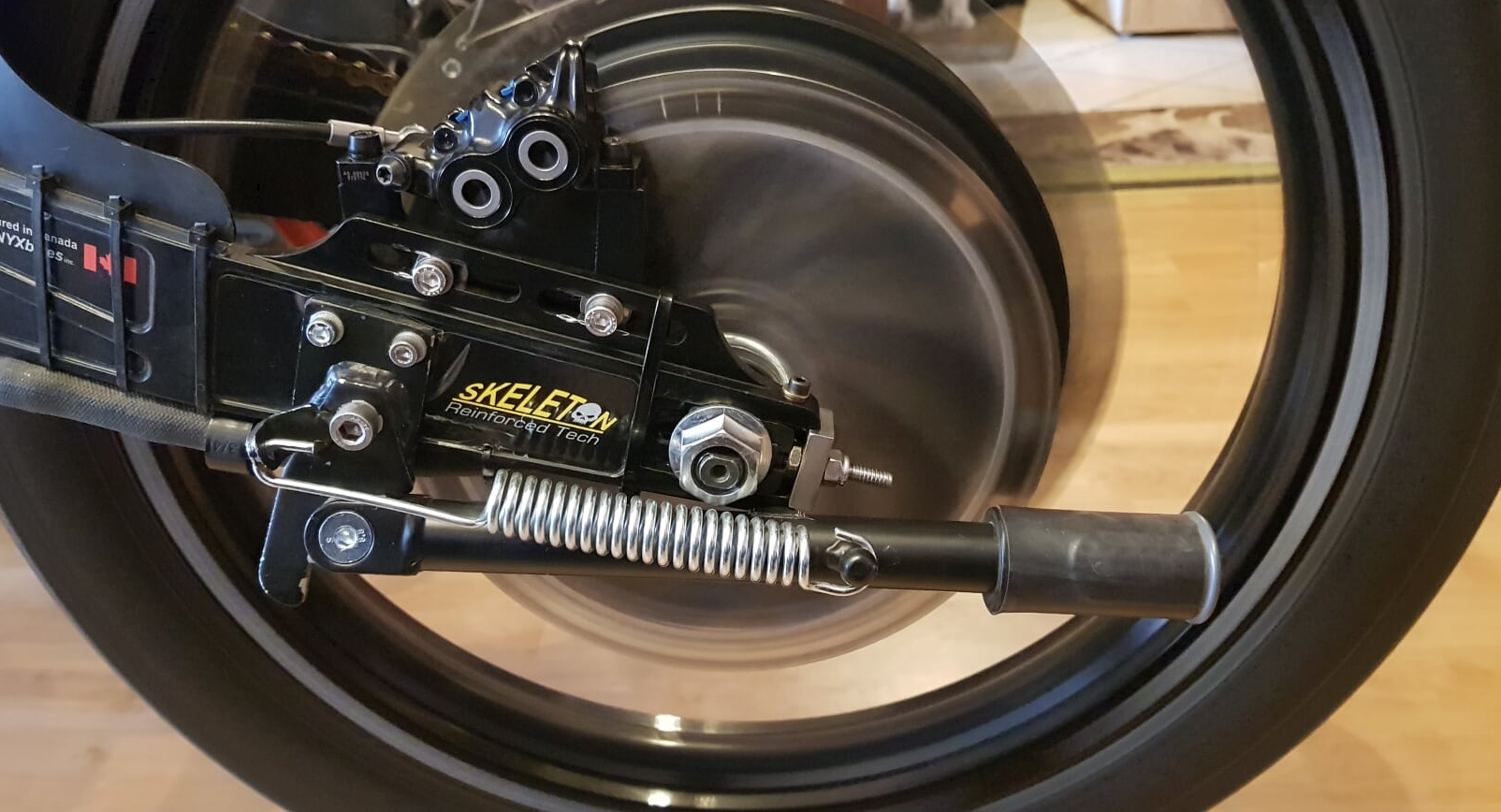

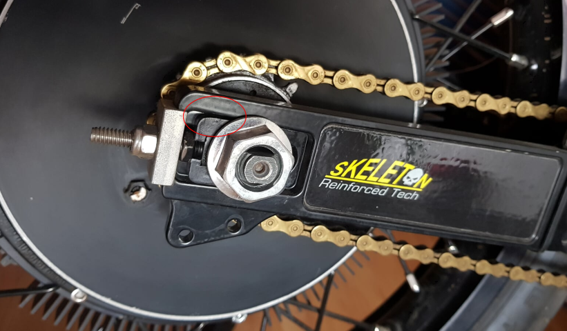

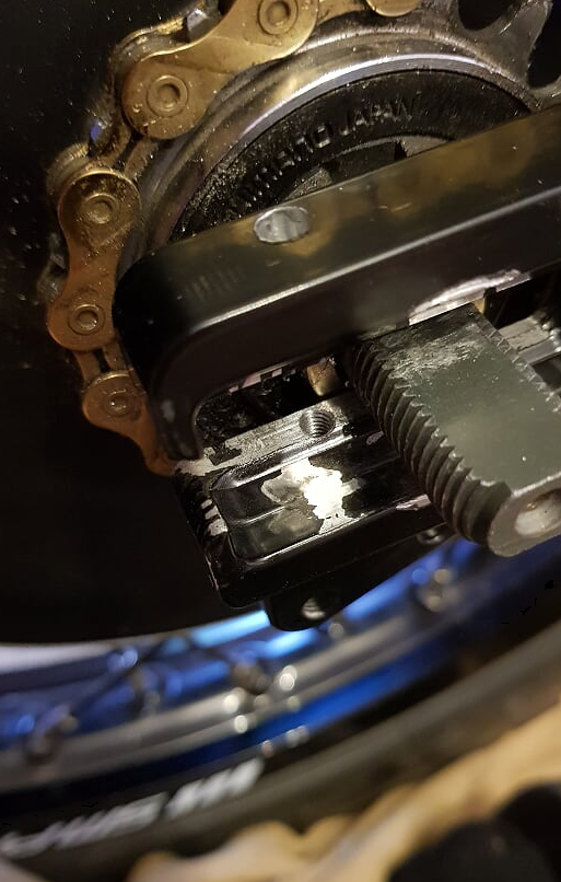

On the headset I was afraid of being not inline or the shock mount...bike rolls and works... "so far" because rolling free handed the bike tends to lean by itself slightly to the right.
What does it mean?.... There's a problem with the geometry and angles of "something" right?
But the most important thing was or IS the swingarm and the wrong angle. As you can see in my pics I filled it with washers.
No question was answered from nyx about that. But as
BrumBrum said the only guy left maybe does not speak English very well so i let this open to the language barrier.
Any ideas what I could do for the self leaning part?
Iam very picky on installing parts without tension.
I'll double check everything and even on every wheel/tire change I put my girl on the bike to have weight on "everything" before nuts and bolts tighten.

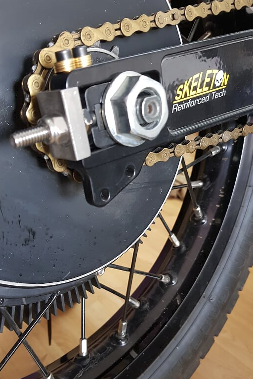

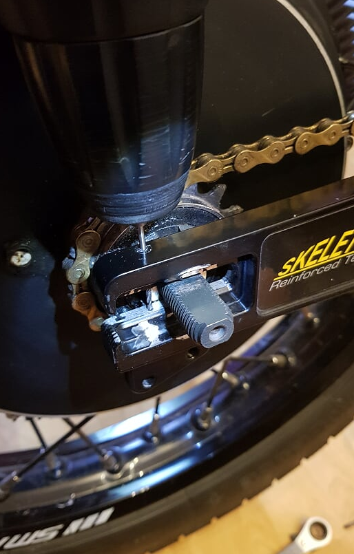

its "normal" that sometimes after replacing tires that your axle nuts come lose 2 or 3 times.

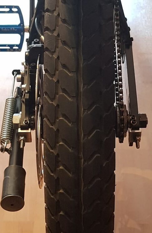

after some nice days in austria riding where other ppl skiing i noticed some weird sounds...creeking and squeeking on accelerating and ebraking.
after checking all movable parts, including suspension brackets etc it took me some time to find out Axle nuts were a bit lose.
my bad...didnt had a frame for years without clamping dropouts.
....tighten then up going out for a ride....a Single Full Power run 0-80mph, ebraking and sound was again there.
rolling home thinking about why they are lose again.
....at home checking the nuts..but they were tighten rock solid. "this time"...it was something other:
yep...on the right side dropouts are "slightly" bend.
What should i do now?....emailed NYX for ideas. But abit as expected. no Answer till now.

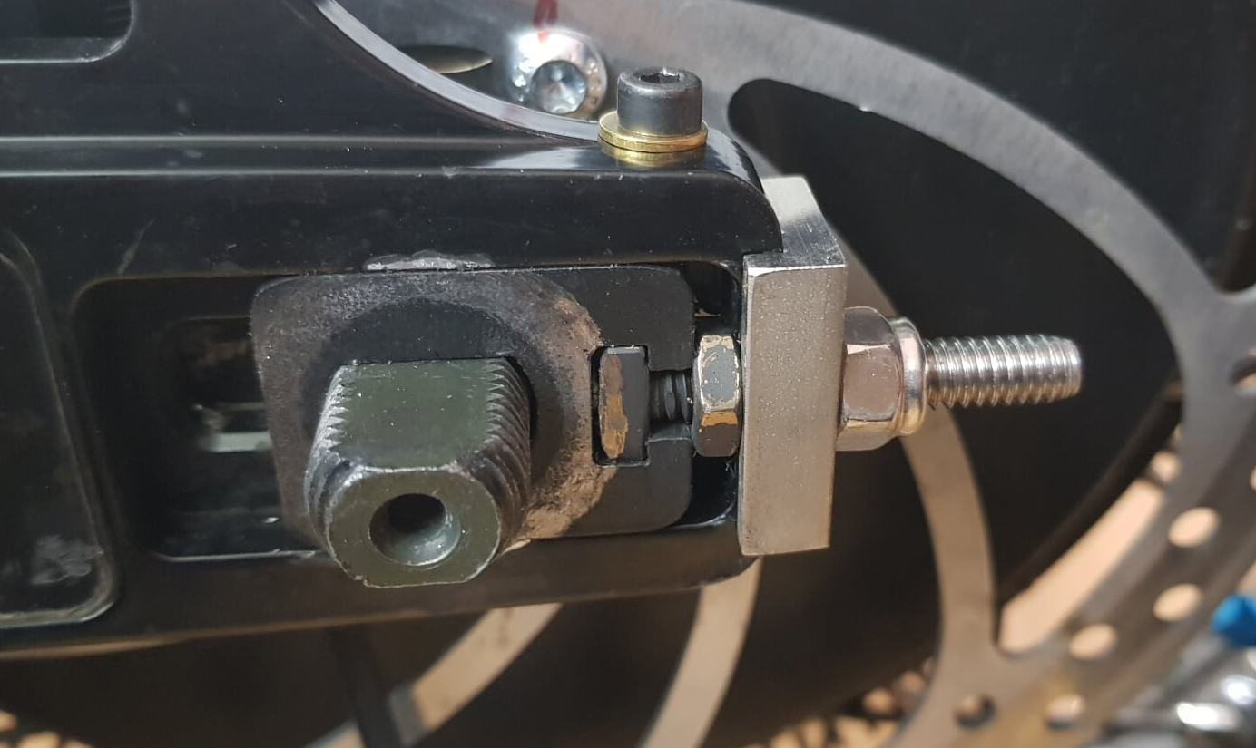

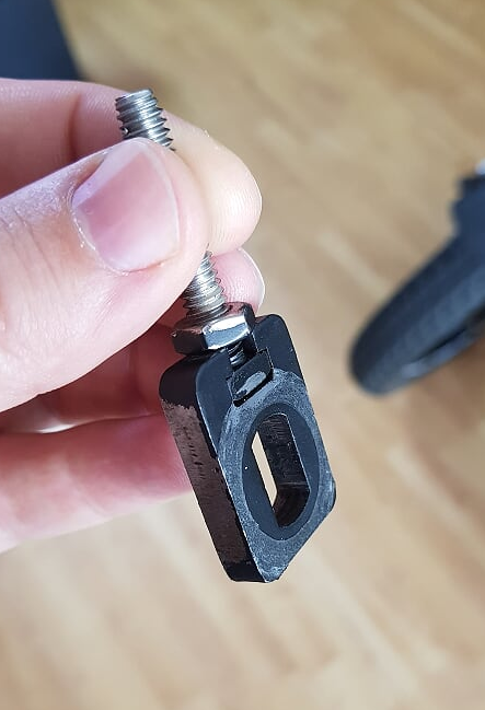

as it is aluminium its not a good idea to (over)bend it back to "normal".
i tried a really small and short pipe wrench and was surprised how easy i "could" bend this 6x12mm end of dropouts.
i only need a single hand to bend it...wow...what a fantastic piece of art.
this complete swingarm is not for that power levels. it flexes side to side like a cows tail with very less effort. i could make a video if someone is interessted.
if you hammer the throttle from a dead stop. be carefull with 10kw+ Power levels.
i like drag racing. so its probably my mistake doing full power runs from a dead stop with this frame.
but to be honest i wasnt afraid of dropout failures because doc bass pushed always the limits and still running nyx bikes.
Luke also build an nyx with a bigger 273 motor.

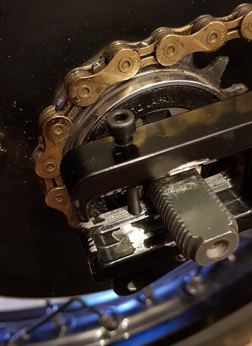

anyway. For others who wants to protect the possibilty of a bend dropout....heres my solution.
brumbrum   100 kW
Posts: 1359
Joined: Oct 30 2010 3:29pm
Location: Wales U.K
Re: Qulbix 165/140 Raptor /NYX Carbon - Sabvoton/Adaptto - 20s/22s Build #5
Post by brumbrum » Apr 10 2018 3:09pm
That's a nice bit of bodging. What size bolts did you use?

M4 bolts. No more room for bigger bolts.
But when you tighten then even M2 should do the job. Its so easy to bend this part.
took another run now. looks and "sounds" good for now. Feels "stiff" again. Time will show.

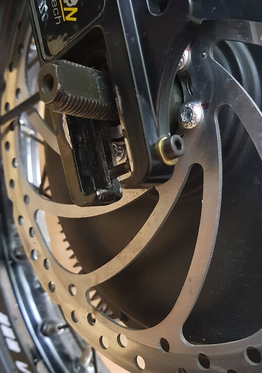

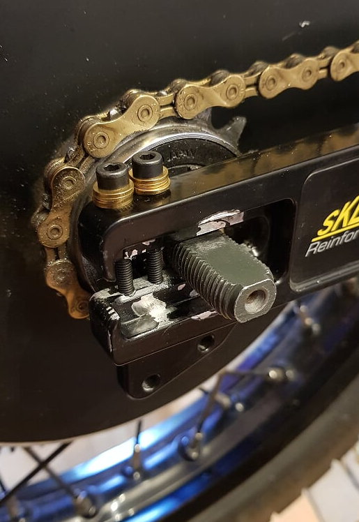

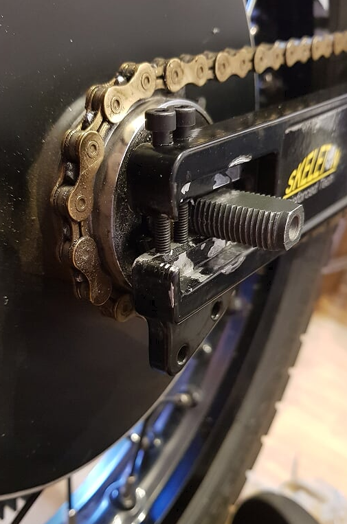

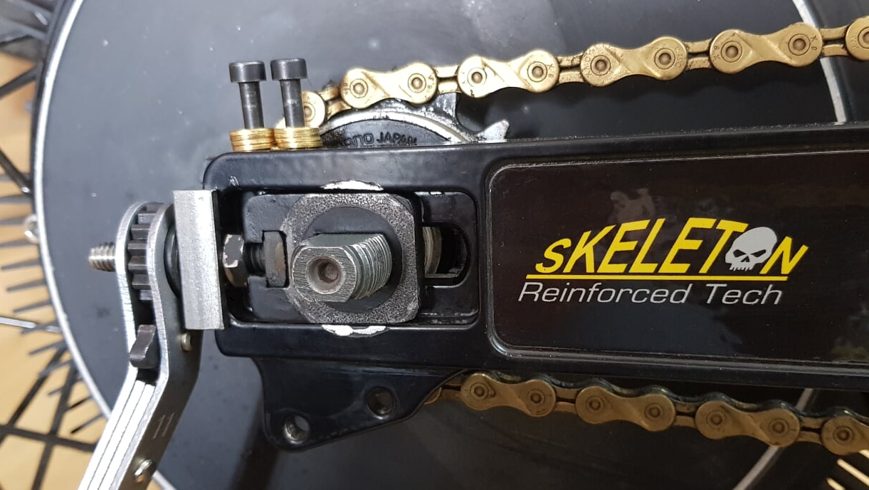

When you put the swingarm on without motor and no rear shock. can you move the swingarm easy with your hands?
edit: ill ask because of "this" (pic below)

ill fixed it with washers.
in "this position" i had 150mm dropout space + no play in any direction + all bolts tightend i could move the swingarm on the bushings easy.(without wheel or rear shock mounted)
i think that should be the normal state and not fixed by a customer.
but atm i have only around 1000km on it. lets see how it is after 5000km or more.
