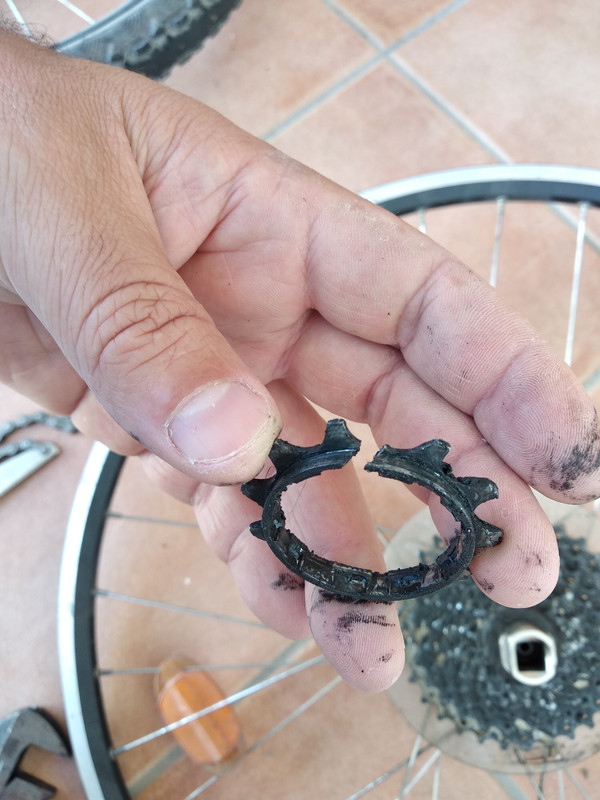

I don't know if was a coincidence or not, but on a second test ride (now with human power implemented and battery current = 18 amps) the 11T gear sprocket just broke at a startup!! But the TSDZ2 metal gear seems to hold on
Maybe I should reduce the PWM duty_cycle increase rate/motor acceleration rate....

Thank you Casainho! I'm sorry about the sprocket, it has probably been happening for a while. All your features are nice but what I really like is ease of programming and voltage and amp settings. I guess I have to cut off the motor to lcd connector and wire in a new one, and also hard wire the throttle into the motor wires as well. I am guessing it is not too difficult, provided I don't have to solder them
I think I will reduce my amp output though. I think when the battery is pushing 60v 15 amps is probably more than enough power. I am lucky that I hardly ever use that 11 cog, I only use it when going over 30mph down hill.

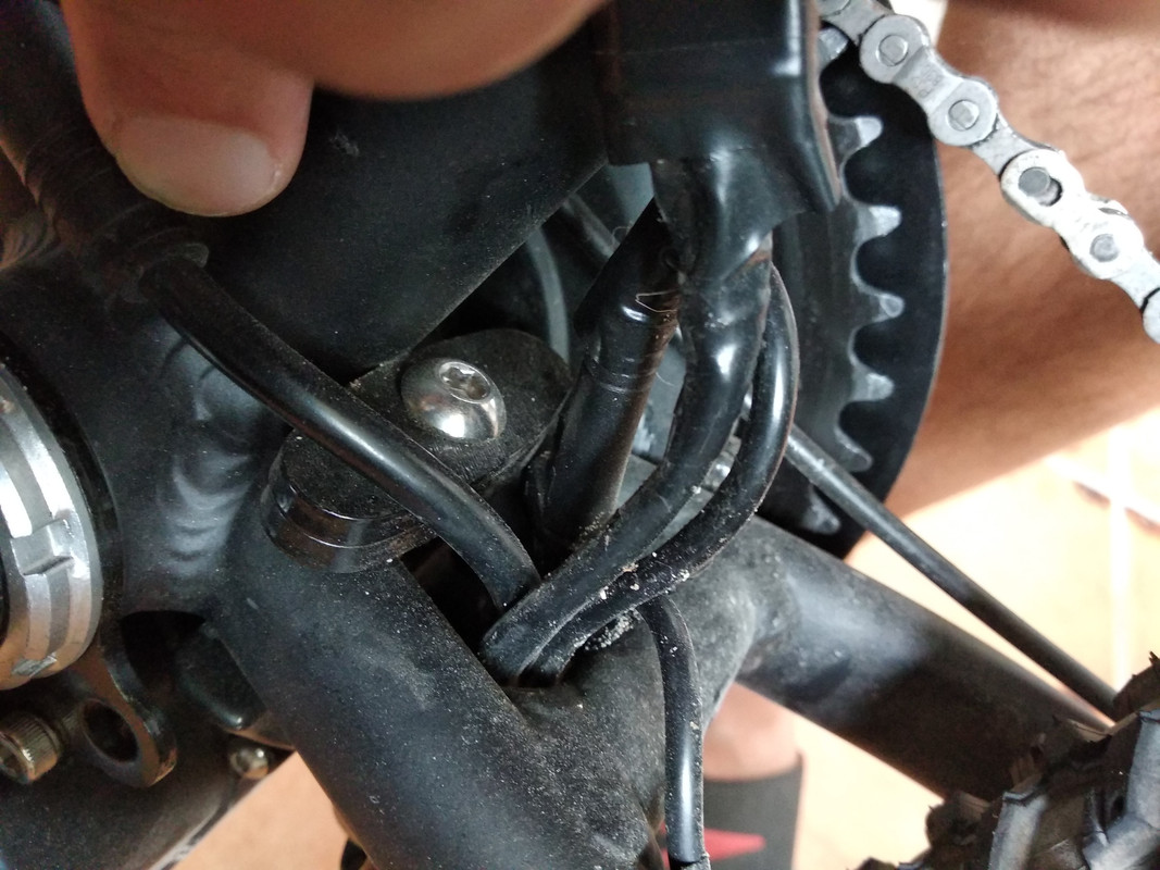

I know my motor does not move but I did not use the rear bolt on mount since I have nothing to bolt it too. I wrapped my motor with a crisscrossed heavy duty cable tie around the bb and it does not budge at all. Perhaps there is some play with the hole in the metal piece which the bolt slides through or maybe is shifting on the frame?
Your motor sounds quite different than mine too, I guess it is due to your metal gear.
Oh, I just saw that big bolt was a small bit loose. But I tried to tight it and found again it loose just after and then I saw that large kind of oval piece of metal is now unflat....!!! So the motor is pushing so hard that the original metal part is not holdingJohn and Cecil wrote: ↑Jul 18 2018 11:48amI know my motor does not move but I did not use the rear bolt on mount since I have nothing to bolt it too. I wrapped my motor with a crisscrossed heavy duty cable tie around the bb and it does not budge at all. Perhaps there is some play with the hole in the metal piece which the bolt slides through or maybe is shifting on the frame?
That was I put 2 of that metal parts on my oat recent ebike of my son, I had another spare part from a dead motor. Guess I will have to found locally a stronger piece of metal than the stock one.
Can you please share a picture of your setup??

Sorry the pictures are not the greatest as much of it is hidden from view. What you want to do is use a heavy duty cable tie to snug the motor up against whatever you are using for support. I had nowhere to snug it to so I had to crisscross the bb and use that as the leverage point and then snug the motor portion of the mount up against the backside of the bb. 650 miles so far and as far as I know it hasn't budged at all.
Use a thread lock and check the fixing of bolts more often. I missed this moment and the body broke in half.
