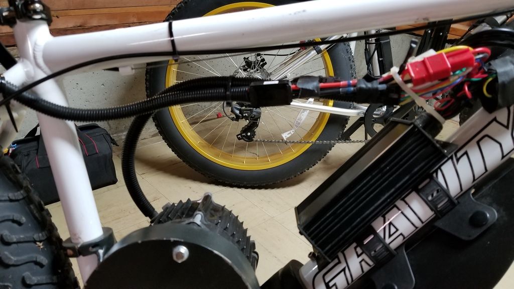

Would love to build a moderate range, 72-volt system to take advantage of the Cyclone's 3k of available power. That said, according to the Cycle Analyst almost all of our dune riding is done at 10-15mph pulling less than 500 watts from that Gianormous 48v -20ah LiFePo4 battery pack that sits on the rear rack. We rode for 8 miles and used maybe a quarter of it's capacity? As stated earlier the battery tips the scales at 24 pounds and makes the kind of riding we're doing trickier than it needs to be. All that rear weight makes the rear end fishtail even when riding slowly transversing the dunes. But 72 volts would be nice hammering up a sand covered hill. The bike has a Nexus 3-speed IGH and in 'low' can climb pretty good already but 72 volts would make it even better. So I'm definitely gonna build something for the triangle above the Cyclone. I have moderate fabrication skills (I custom fabbed the hard mounts for Cyclone) and it's easy enough to relocate the bluetooth programmable controller so the space available is actually quite big. I plan on building some kind of sliding/quick detach mount so I can take the pack off and charge remotely from the bike.
So priorities?
1) Cost
2) Safety
3) Weight
3) Range
So priorities?
1) Cost
2) Safety
3) Weight
3) Range

I'm gonna keep repeating, in 72v configuration, that 3000w motor can easily kill 80 18650 cells, unless you actually limit the amps to more like 1000w.
In fact, 4 cells in parallel is a bit small for 1000w. Oh sure, its within cell spec. But at the top of spec, those cells get all hot and bothered each discharge, blow a ton of their capacity into heat, shorten cell lifespan dramatically, etc etc.
To get a decent result, you need to start thinking in terms of 6p, or even 8 p. And even then, no 3000w spikes when you start up one of those sand hills. No way 160 cells fits in that triangle. So stop dreaming of that. But you can run 80 cells in the triangle, and carry another 80 on the rack. The one thing the 18650's have going for them is they are light, and pack into a triangular shape real nice. That's 18650 cells, like the Panasonics or whatever.
And one more time, lipo is the cell type that can pull 3000w, easily. 20s 10 ah of lipo is 8 packs of the 5ah 5 cell type packs. Get the 30c or better type for best results, but the cheaper 20c can do good enough. Spec on them is not realistic, but if you keep them under 5c they do fine. 10 ah of 72v at 5c, is 3600w. For a 30c pack, thats running one 6th of spec, keeping cool and less than 2 v of sag under full load. Again, you'd run 4 packs in the triangle, about 8 pounds or less, and then the other 4 on your rack, meaning about 12 pounds less on the rack than you have now. You can also mount 4 packs on the handlebars pretty easy too.

3000w motor with 72v voltage will use about 40-45 amps. 80 cells is more than enough to give that current. Or i missed something?dogman dan wrote: ↑Mar 18 2019 6:26amI'm gonna keep repeating, in 72v configuration, that 3000w motor can easily kill 80 18650 cells, unless you actually limit the amps to more like 1000w.

I'm soooooo confused now....
80 cells in the triangle, and another 80 out back? WTF? I don't want anything 'out back' anymore. I don't want anything on the handlebars. I don't want anything anywhere but inside the triangle.
I'D LIKE 72 VOLTS (or 84-whatever) but am unwilling to pay $1,000 for a 160 18650 LiFePo's to make that happen. And I'm certainly not going to put that weight anywhere.
I could live with 52 volts, or even 48 but is the technology that 'sketchy' that even you guys (who know about 1,000 times more than I do on this topic) can't agree on it?
Again I say WTF?
And somebody please point me in the direction of a (non Luna) reputable supplier of 18650 cells at a reasonable price!
Again I say WTF?

You can make 20s4p battery pack with cells capable of 10+ amps continous and your pack will probably run without issues.mammonista wrote: ↑Mar 18 2019 10:40amI'm soooooo confused now....
Again I say WTF?
I think main problem will be small battery because you will be able to run your motor for 15-20 minutes with this pack.
If you can - make bigger battery.
About voltage - your motor is 72 volts or what?

as I understand it... (or thought I understood it anyway) my Cyclone 3k mid-drive motor is rated to take 72 volts and provide 3,000 watts of power at that voltage. I've been running it on a 48 volt system (battery pack and bluetooth controller) and the Cycle Analyst says it's drawing/producing 2,000 watts of power at that system.

If 48v speed is enough for you - go for it. This way you can make bigger battery.mammonista wrote: ↑Mar 18 2019 11:11amas I understand it... (or thought I understood it anyway) my Cyclone 3k mid-drive motor is rated to take 72 volts and provide 3,000 watts of power at that voltage. I've been running it on a 48 volt system (battery pack and bluetooth controller) and the Cycle Analyst says it's drawing/producing 2,000 watts of power at that system.

and when you say "be able to run 15-20 minutes with this pack" I'm assuming you're talking about 15-20 minutes at full throttle/ 3,000 watts 'draw' ? Because I can't imagine doing more than 10 or 15 second bursts of needing that kind of power. Most of our riding is pulling 500 watts or less through the system.
Or am I missing something here?
- Posts: 94
- Joined: Feb 18 2019 4:50pm
Re: Scavenging one nearly new battery to make another?
Yeah at full throttle. I guess your motor will use 10-20 amps in normal use. Maybe less.mammonista wrote: ↑Mar 18 2019 11:44amand when you say "be able to run 15-20 minutes with this pack" I'm assuming you're talking about 15-20 minutes at full throttle/ 3,000 watts 'draw' ? Because I can't imagine doing more than 10 or 15 second bursts of needing that kind of power. Most of our riding is pulling 500 watts or less through the system.
But - bigger battery is always better choice because you will load less current from each cell and your ride can last longer.
Btw you dont have to spend 1000€ for your cells. You can buy decent cells at https://eu.nkon.nl/.

The Cyclone motor is rated at 3,000 watts at 72 volts. The Yuyanking (sp?) controller is rated at 60 watts (I think). Most of our riding is mild off road (sand dune, sandy forest trails, beach) where we're not full throttle 95% of the time. The bike has a 3-speed IGH and my current 48 volt battery pack has enough punch for just about everything but the steepest hills. Still most of our riding is pulling 300-400 watts traversing soft sand hills at 10mph (or less).
Everyone says inexpensive 18650s are out there, but where? And what is inexpensive? I've been happy with my LiFePo4 -20AH battery pack but it's far too heavy to carry on the back rack for the kind of riding we're doing. So I want to move everything to the triangle. What's the best maker of LiFePo4 batteries and what's a reliable source.
PLEASE?

When I bought a fat tire bike I knew almost immediately I wanted to put a motor on it. Have you ever driven a fatty without one? Ugh!
Then I decided on a mid-drive and I figured a Cyclone would give me by far the most bang for the buck. A lot of people said, "Why not just buy a bafang?" or "that's an awfully big motor for hanging below the bottom bracket!" My answer was to spend a lot of time building custom mounts to put the motor inside the triangle. I'D DO IT AGAIN! The motor makes a lot of sense there. That said, there's still a lot of room inside the triangle (once I relocate the controller) for a huge custom build battery!!!
I am not mounting anything on the rack!!!!!!! The rack is probably going away!!!!! Because of the kind of riding we're doing any weight on the back of the bike is BAD!!!!!! Ditto anywhere else on the bike. It's either going in the triangle or it ain't going!!!
I hope you understand.
That said, the link you provided is for pre-made packs only.
- I want to build a custom pack.
- I want to put it on a sliding mount inside the triangle so I can remove it for charging to a safe outdoor location away from any structures.
- I want the best deal I can get for quality cells (I don't mind sales 'mark-up' but only within reason.
- I want to be able to pull 3k watts for the Cyclone, and I guess I thought I needed 72 volts to do that? Now you tell me that's incorrect?
- I love 'Vanomo' (Van No Mo) my DIY DOKA!
