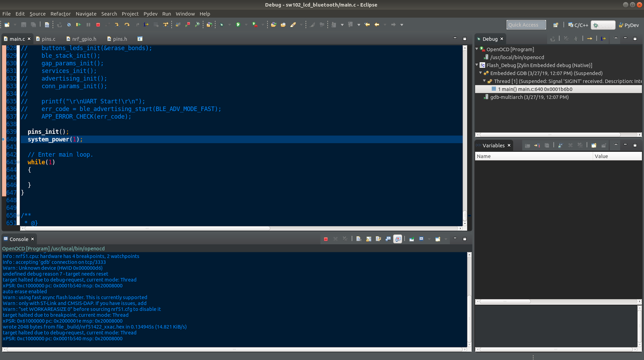

I created a simple project based on a sample project of UART <-> Bluetooth communication, based on Nordic NRF SDK for the SW102 LCD microcontroller and flash and debug successfully. I am using just the same tools as I use for 850C color LCD: STLinkV2 clone + ARM GCC + OpenOCD + Eclipse.
The project code is here: https://github.com/OpenSource-EBike-fir ... _Bluetooth
- TSDZ2 OpenSource firmware

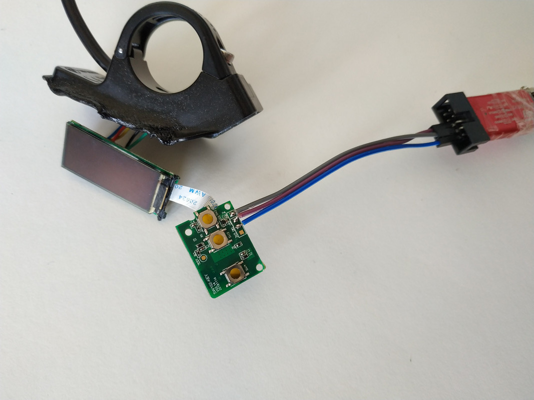

Bluetooth on SW102 LCD is now working!!
I used the Nordic SDK sample "ble_app_beacon" because I though would be the fast and simple way to have Bluetooth working.
Here is the source code where I changed the UUID to some number easy to spot:
And here is the beacon listed on my mobile phone, using the nRF Connect app from Nordic, specific to help on the development:
I guess for future, we can use the sample code "ble_app_uart" that is a UART/Serial Port Emulation over BLE, so we could work on the firmware side to have 2 UARTS on the system, 1 for communicating with the TSDZ2 motor controller and the other with the mobile app.
Also, I would like to connect to that visible xiaoxiang BMS that are installed on my battery packs and I would like to read the battery pack temperature and each voltage cell. The idea to read the BMS temperature is similar to read motor temperature... my cells can't discharge fast, otherwise they should increase the temperature and the their lifetime will be reduced.

SW102 Bluetooth LCD:
- Bluetooth works (tested with Bluetooth Beacon firmware sample)
- LCD do not works yet but I already logged the electric signals (should be easier than 850C LCD)
- only piece of hardware missing to have full control are the 3 buttons but should be very fast to get them. The power on/off button already works.
I want to focus myself on 850C but if anyone is interested to help on SW102, I can help mainly on get the full hardware working.

Hi casainho, buba,
I would be interested in helping out with the SW102 bluetooth LCD. In one of my past internships, I had to develop a couple of simple Bluetooth applications using an nRF51 board so I have some basic experience with the Nordic uC products. I'll have to order one of those first. Once I receive it, I will reach out to you for some help on getting started. I'll give up on trying to set up the LCD3 for now.
Cheers,
Sid

sidmodi wrote:
Mar 31 2019 4:15pm
Hi casainho, buba,
That would be great!!
Please take care when open the keyboard to solder the flash/debug pins. Try to find a way a user would do that, as I didn't did that yet and I would like to know how hard is doing it and the final aspect on the handle bar, etc.
