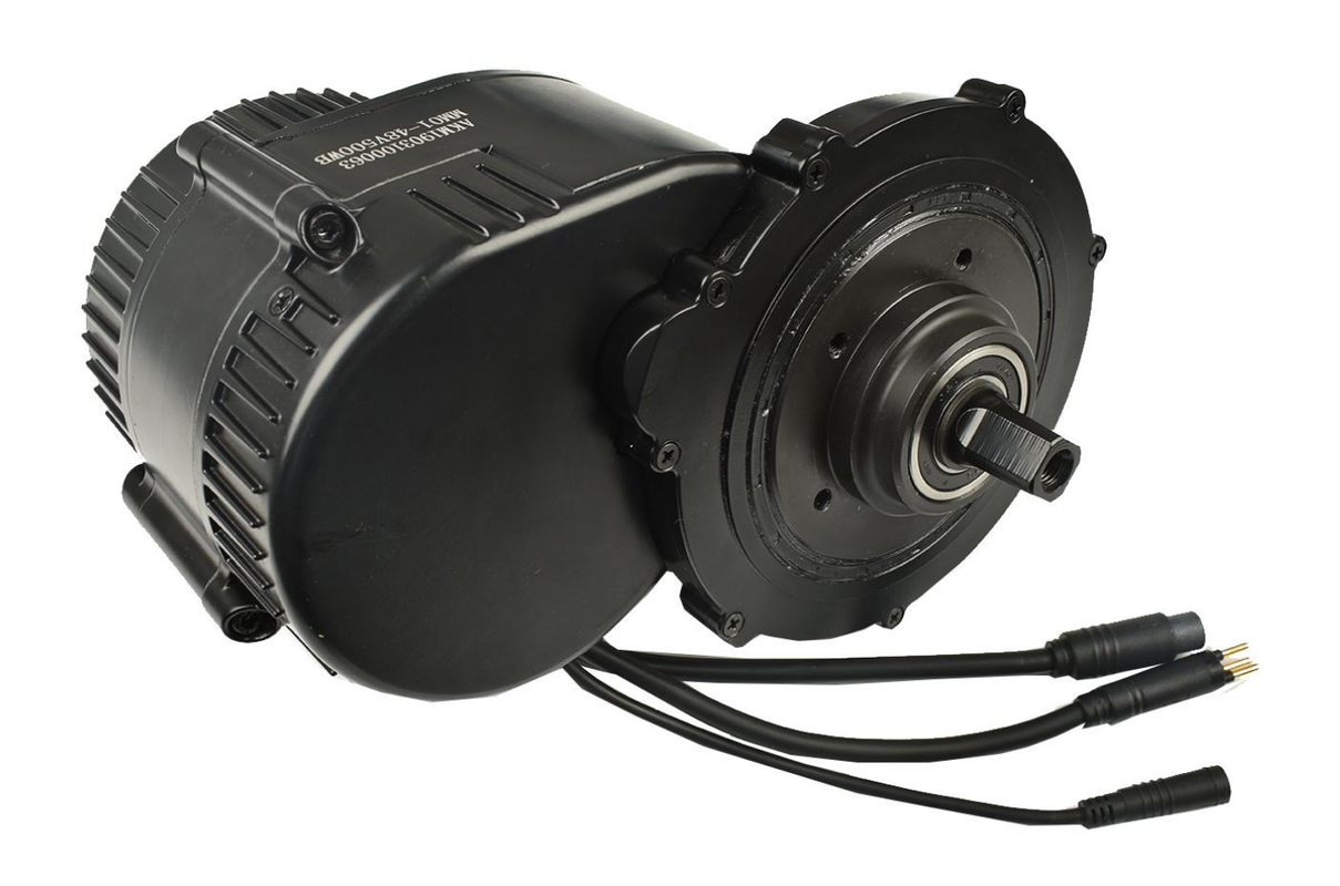

Hi all,
I just the TSDZ2 a few days ago, and haven't done more than a couple of km for a test run. I've got a issue where the entire axle in the crank is a bit loose so that the crank arms wobble when you pull in them, and it makes a tick sound every turn of the pedals when you ride it. I've made sure everything else is tightened properly, but you can still se the axle moving when you yank the arms back and forth.
Is there any way this can be tightened/adjusted or should I return it?
Edit: The clicking probably was the pedal that didn't work properly after the winter, and it got better after a while. A bit less worried now. The axle still flexes but now it doesn't feel like it will fall apart any moment.

This thing with the looseness of the axle is what i see as well. I got my kit 2 weeks now and i have done 80 km so far.
The effect is not so big. Does not feel near falling apart at all, but i feel a slight looseness on my feet when i pedal.
If i try stationary to move the crank arm in and out, I feel a movement of a milimiter or maybe less. Not on the center of the axle. On the edge of the crank arm.
Is this expected? Normal?

my engine is completely adjusted and without any slack, tightly tighten the cranks that are aluminum and can take slack and tightly tightened all the catches

If the axle is a bit loose, you can remove the gasket/seal on the non drive side, and insert a washer or two behind the lock ring... then re-insert the lock ring... may be a task to get as tight as you want, but I assure you, if you get it tight, it removes the problem. Several people have tried and did not find this to be so, but I can confirm if you insert the correct amount of washers and refit the lock ring (I repeat, can be a task) then this will remove the play.
I can upload a demonstration file later if needed...

So remove the seal on the non drive side:
then remove the lock ring, and insert some identical washers until you can BARELY slide the lockring back down to snap on. In order to get it snug, I cannot place the lock ring with the pliers...I get it as far back as I can, then I have to slide it until it locks back into the groove, because you will need to apply some pressure if you put enough washers there to snug everything up...
Washer size / part info to follow...

I'm a bit ambivalent to this. You're applying longitudinal pressure to remedy lateral flex, and I suspect the reason it works is because you put pressure on the inner part of the bearing while the outer part is fixed, and the balls will be squeezed between the two cups. These bearings aren't made to take sideway forces and I will probably cause it to wear prematurely. But I'm not an engineer, so I might be wrong.
If it's the bearing that causes the flex, could it possibly be replaced with a quality bearing instead?

Having too wobbling crank axle. Got my 250w kit installed week ago and after 150km ride noticed cranks wobbling. First thought cranks were loose but after checking found they are tight but axle is loose.
Short video https://youtu.be/7iOWg5nUjfo
Today asked from pswpower about this and they replied wobbling to be normal. It is a bit irritating so perhaps need to try that washer tinkering...
Thinking to make open source firmware upgrade but perhaps will wait a bit because it will stop warranty. My unit sw version is 3.6. In LCD5 manual were 3.7. What you have - can it be updated?
Looks like mine:
https://photos.app.goo.gl/mLghqp4QBk8FuQKn9
I also asked, and got the reply that it's normal. Let's hope it holds together.
