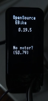

Today I was testing the firmware and update process using Bluetooth of SW102. This is the current boot screen:
On mobile, using the NRF Connect I could see listed the OS-EBike device:
And the Manufacturer Name String:
Then I went to start the Bluetooth bootloader so I could update by wireless the firmware. The device name was changed to SW102_DFU:
Then I clicked on DFU and was asked to select the ZIP file, that I did download from our SW102 repository, on the releases: https://github.com/OpenSource-EBike-firmware/SW102_LCD_Bluetooth/releases
The updated went perfectly as expected:
