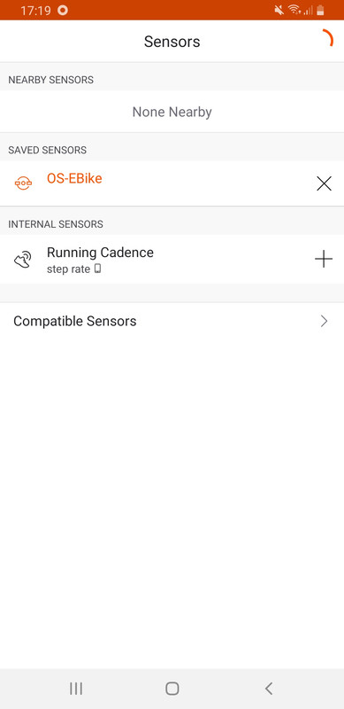

casainho said:
Today I was testing the firmware and update process using Bluetooth of SW102.
And I forgot to say that as we can see on the screenshot, there 2 services (cycling speed and cadence, battery) that are specific for integration/sending data to Strava!!
The Nordic UART service is the regular UART transmission of data just like happens now between the display and the motor controller, but this time from the display to mobile app:
For other fitness app is the same thing?
geeksville said:
yep! Though fair warning, I've only implemented the battery profile fully so far. so the CSC profile to upload cadence/speed (and related pedal power profile) aren't fully complete yet. They will enumerate but the data I'm sending up is marked invalid for now.
I am not a Strava user but I went to the app, started a search for the sensors and then OS-EBike sensors did appear and I was able to pair with them :)

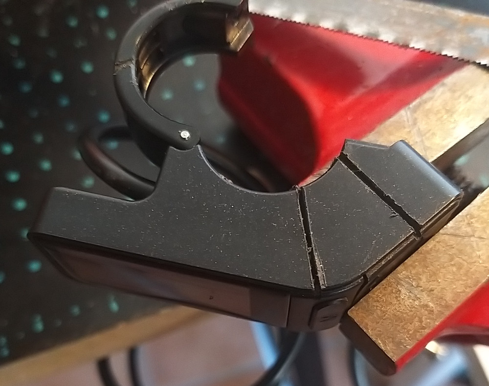

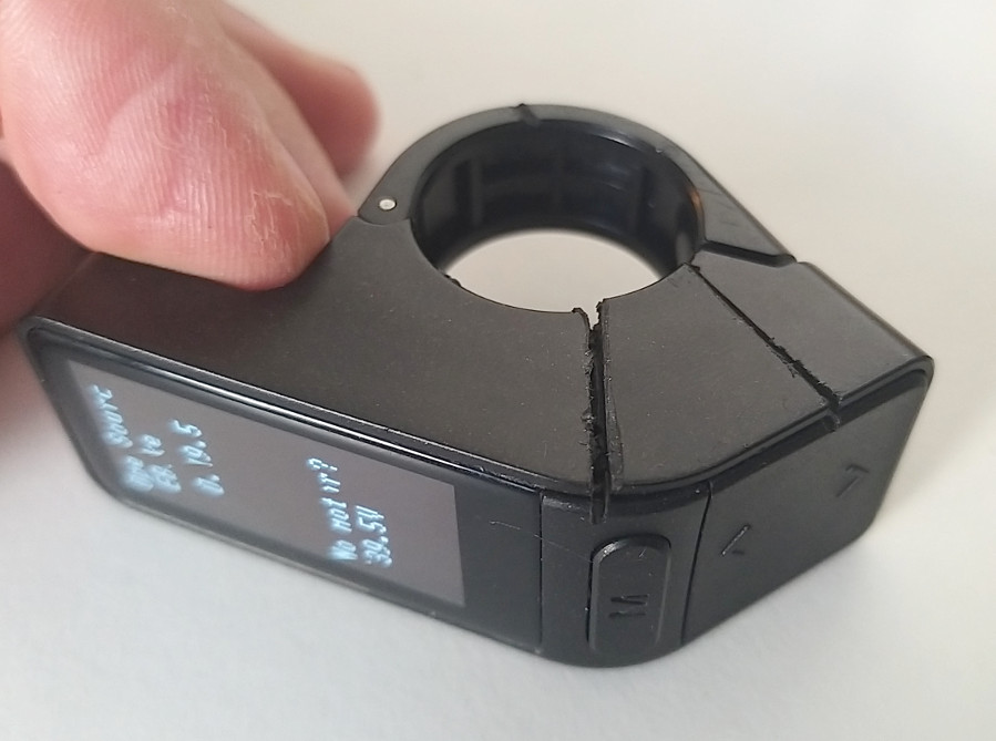

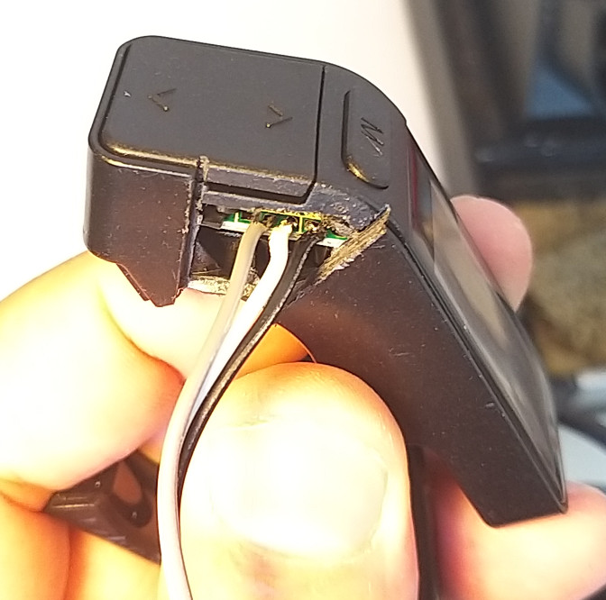

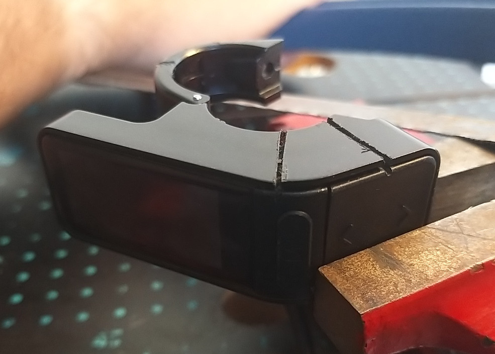

Here is my way that I think is safe and most easy (yes, I already break 2 units of SW102 before having this idea). If this works for others, maybe we should put on wiki:
I just went to cut a lateral from SW102 so I could solder the 3 wires for STLinkV2. I am not using the 3V3 as I am powering the SW102 from battery -- I think this is better as it is one less wire to solder and it is a bit hard to solder them on SW102.
I started to use a hand saw for metal and did cut the lateral part:
Then I simpled break it when I pulled with pliers.
Here the pads exposed. I had to I pull with pliers a small rubber sheet and had to cut a bit a plastic with a cuter knife:
Finally I soldered the 3 wires carefully and made sure there was no short circuits on them:
After flashing the bootloader and the firmware, it runs!!
Finally I can use the parts I removed and glue it. After all this, the key pad is working perfectly as original:
nice idea. It's a good alternative. So removing the pads as you made before you can brake the lcd structure?
If you know exactly which pad and its precise location, could you not simply drill 3 small holes and insert a probe onto each ? Once the bootloader is installed simply put a blob of silicon over the holes.
