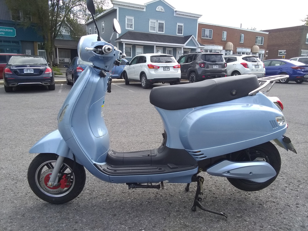

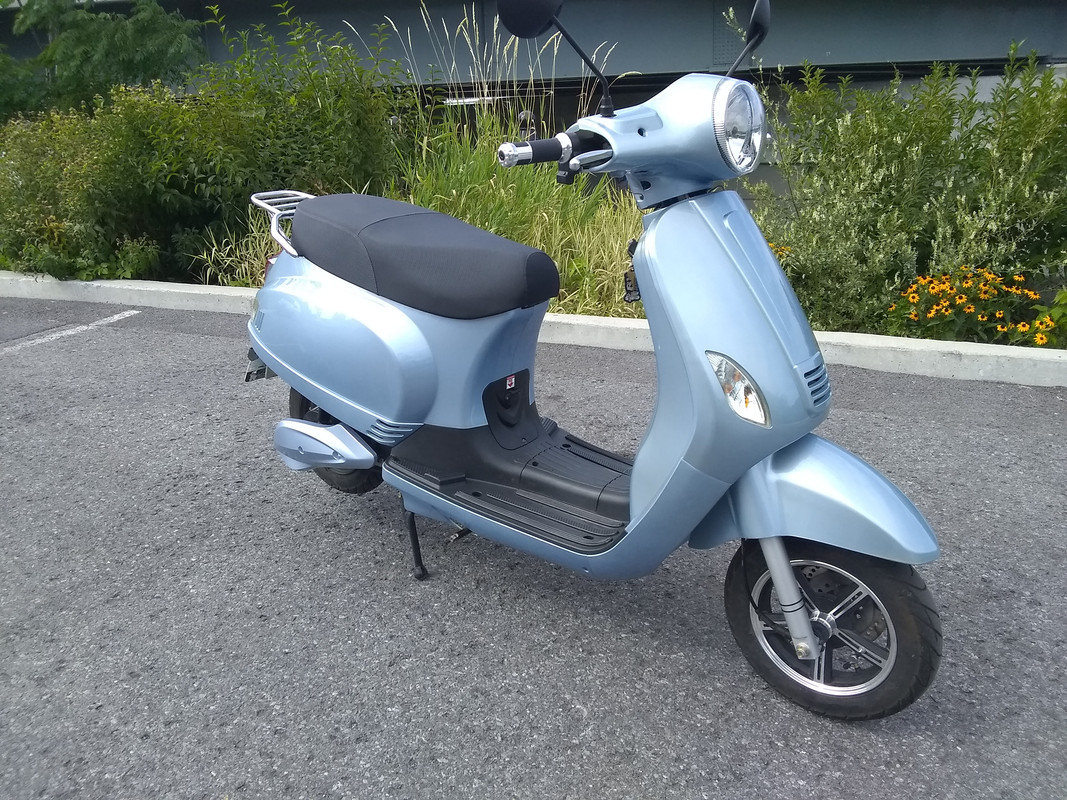

This is a copy of a Vespa scooter, i think the model is the LX50!?
This scooter is a 72 Volts, 22.3Ah Graphen battery and a 500 Watts motor.
I buy this scooter at 80km, with dead battery, i put 6 brand new 12V 22.3Ah graphen.
The only problem i have, it's the volt meter on dashboard always indicated FULL when the battery are low!?
I think the voltmeter on it it was for a 60V! They have the same model on 60V....
I'm going to install a digital voltmeter later

Update,
I drove almost 100 km since the installation of the new batteries and it run very well.
Top speed is 47 ~ 48 km/h (full load), but I drive on average at 35 ~ 40 km/h and I get a 52 km autonomy!
Very well seated and the suspension is not too hard even with its 10" x 3.00 tires. The acceleration is not super fast, but rises quickly
I still have to adjust the front mudguard that knocks on the front suspension!
