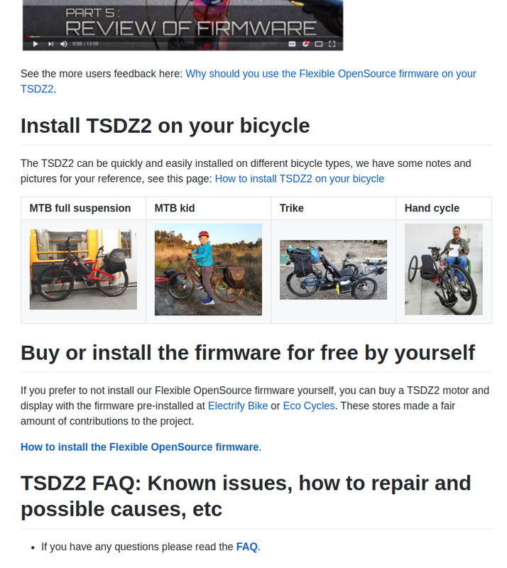

Jeff, I added as example your build of an hand cycle -- I linked to your videos!!

Jeff, I added as an example your build of a handcycle -- I linked to your videos!!
Thanks, Casainho, Today electrifybike.com is going to install the "overrun" modification on the old beta 20 to see how that works. And then later this week we're going to install an 860C and your latest software on my hand-cycle. Where excited to try your latest efforts and your support for the 860C. I'm very thankful for all you and the others have done to improve the TSDZ2 system for hand-cycles and regular riders, my wife loves her TSDZ2 with an 850C.
