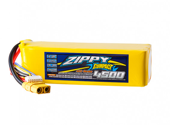

The battery in your picture appears to be a 6s 4.5ah pack.
Thats 6 cells in series at 4.2v per cell. The total voltage of that pack fully charged is 4.2v X 6 = 25.2V.
The nominal avg voltage of a cell is what we use for the math. Depending on the exact cell type 3.7 or 3.8v is about the average voltage during discharge.
So when people say 20s they mean 20 cells X 3.7v for an avg voltage of around 74-75v. Its 84V hot off the charger.
If you connect the positive lead of that yellow 6s pack to the negative end of another 6s pack you now have 12s. That is now a 3.7v x 12= 44.4v Pack with the same 4.5ah capacity.
The voltage dictates the max rpm of your motor. The ah capacity is like the fuel in your tank. 4.5 Ah is 4.5 amps for 1 hour.
If you want more capacity you put more packs in parallel. If you parallel that yellow pack to another one you now have 6s 2p for 3.7v x 6s = 22.2v and 4.5ah x 2p= 9ah
Series adds voltage and parallel adds capacity.
If you believe the 40C label on the pack which I wouldn't then you are looking at 40c x 9ah = 360 amp peaks.
I find that RC lipo is pretty happy at 4c and I've peaked mine to 10c a few times but the voltage sags pretty bad. If you can live with the weight of more battery I would aim for no more than 10c with the cheap lipos. If you buy the fancy graphene ones maybe they work better. I always bought the cheap 10c or 20c rated ones.
One more thing. If you are going to buy RC Lipo try to get packs that divide evenly for balance charging. For instance a 20s pack can be broken into 2 X 10a packs and then balance charged in parallel all at once.
RC lipo is generally small ah and form factor so you end up with lots of parallel connections which adds cost weight and mess. For a motorcycle size pack the dogdipstick packs seem like a better size. You can find RC lipo in 20ah single packs but they get pricey. The small ones like 5ah go on sale a lot so us cheapskates just have miles of spaghetti wiring from all the parallel connections.
Basically there becomes a point where to get more amps of discharge current you end up needing a larger battery so the C rate stays reasonable. Its just the practical limits of the current battery tech. There are some exceptions to this rule but they are pricey. If you had a race vehicle and wanted the absolute most power density you could get then you can use the cells in this link and get 500amps continuous from a 5ah cell that fits in the palm of your hand.

more specifically, a 6s 1p 4.5ah pack.
These LiPo packs are normally all 1P, so they don't put 1P on the packaging.
To take Dan's example further, using two 6S 4500mAh packs in a 2P configuration, you can get an 18S setup like the picture below.

Re: Trials Motorcycle - 1st Build. Qs-motor +Votol
With your zippy example above 6s 6200mah packs, you need to buy 9 of those to have 18s 3p.
It would be 3 groups in series each containing 3 packs in parallel.
The reason people dont all do this is complexity, wiring costs, and safety.
Rc lipo is dangerous when mishandled. You need to treat them like a gas can. If they get out of balance and you overcharge some cells to more than 4.2v they can explode and will burn like a ziplock bag full of solvent because they are essentially bags of solvent. If you drop one on the floor its garbage. Mechanical damage can cause an internal short circuit and they blow up. People have lost bikes and houses to lipo fires.
That little balance lead with the 7 wires in the zippy pack needs to be hooked to the other 7 wire connector with the other cells in parallel. So you need wye adapters for those balance leads as well as the main discharge wires. Its easy to spend $5-10 Per wye adapter. So you are probably looking at $20 of wiring per series pack. This wiring is easy to mix up when its all crammed in a bag or box and its unfused. If you plug the wrong things together you get severely burned and possibly blinded. That is known locally as KFF or kentucky fried finger.

I found this battery online seems to have good reviews.
OVONIC 6S 22.2V 16000mAh 25C 50CPeak LiPo Battery Pack with AS150 Plug for UAV Drone for around $200. The size could hopefully fit; that is on my list for today.
I'd run 18s1p 16ah
Amps Continuous at 25*16 = 400
Ams Peak at 50*16 = 800
Even if the Amp is half of its posted value; I'd still be in a very respectable 200/400 Amps with 16 AH.
alternatively I also found this battery little less at 14000mah, but reviews seem good. Cost is $100 each at some stores; others have it for $189 ea.
I am then looking at this quad charger/balancer to keep the cell all nice and heathy.
Cost for this charge plus 3 batteries would run me $800(ish) - Seems reasonable and within the specs I'd need for my Trials Application.
