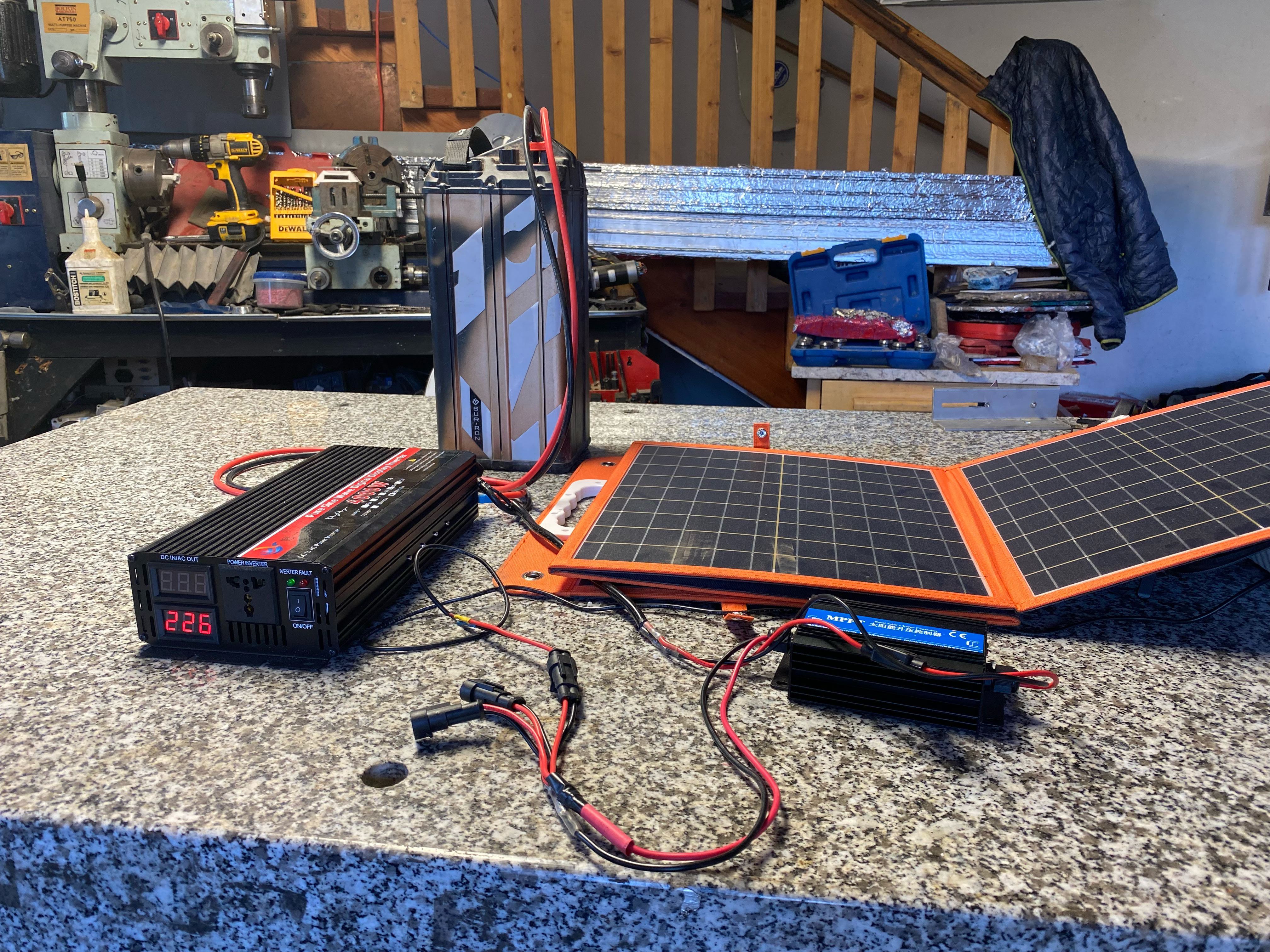

Post by 3DTOPO » Jul 02 2022 8:24pm
Here's my complete system, everything works!
I charged the battery with the solar for the first time yesterday. 8)
I just have one 100 watt panel for now - going to get another. It weighs 5 pounds and 16x16 inches. The harness is wired for three panels (and the MPPT I got supports 300 watts).
My inverter is putting out 220V that can be split to two 110V outlets (going to use GFCIs).
Un-limted range (given some time to soak up some photons) and actual broadband just about anywhere now! :bolt:
Oh - the only thing is, when I connect the inverter to the battery I get a big spark - even when the inverter is off. Anyone know what connection or signal needs to go to the battery to disable DC power out?

The spark is the inverter's bulk filter capacitors charging up. You need to precharge them or use something like an anti-spark connector (AS90) to do so.
Fuse your battery connection as close to the battery as practical. That MPPT has to be a POS for the price but as long as it works, it works. If something goes wrong you want the fuse to blow and not start a fire. If the failure draws current that is lower than the BMS trip limit it can set the wires on fire. 300W MPPT / 60V = 5A max. So w/ the 1.25x UL fuse derate, look for a 6.5-10A fuse and size wire accordingly. Do similar calcs for the inverter (though it needs ~2x sizing due to the high RMS current on the DC side)
Is your 220V inverter center ground referenced/balanced? Not many cheap ones are. Be careful trying to run to separate 120V circuits from it. It likely wont like unbalanced phases either.
2kWh/100W = 20H of charging for a full charge. (~4days w/ good sun) Wife/kiddo/I can't wait that long;) Its clever doing what you are doing w/o intermediate storage and having it portable though. Kudos!
