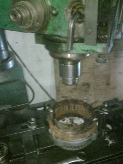

Anyway, been quite busy this weekend 8) with my stator (please forgive my BB's picture quality) :
1. Went to the machining shop, but before that marked the area which need to be removed with marker pen. Then drill them out. Its a 2 dollar jobs
Please be really careful for the machine not to touch the stator wire, but 1-2 scratch wont kill you and easily insulated by thin CA.
2. the results then looks like this
Please note that the sensor will be positioned just before the respective phase, and as the each phase interleaved with each other, on bosch/ND this would mean that each sensor will be separated by 1 tooth.

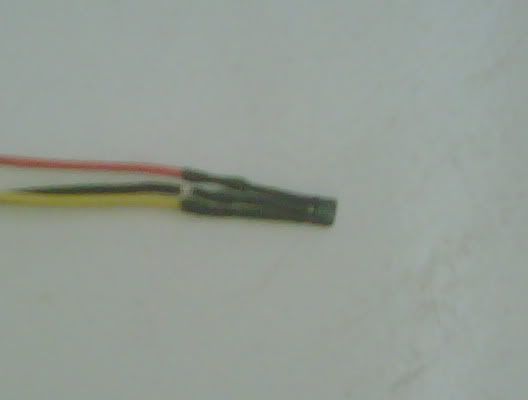

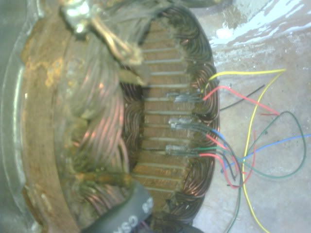

3. Wired up the hall sensor, previously I'm using the honeywell SS40A open collector, but hate the mess with the pull up resistor, hence currently I'm trying the totem-pole output of the SS411. Did have a problem previously with the pin assignment but it is turn out to be +, - , output.
Again, sorry for the picture quality. But I found Blackberry is the fastest medium for capture and share this project.

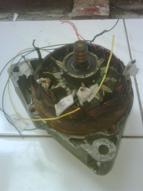

Please assure that all sensor was working before progressing further, as you will need to glue it up firmly to the stator. Found one which was not working after it has been glued, has been proved to be very frustrating.
The SS40 & SS411 was quite small, but as the space really tight, I removed its sides using a dremel, also rounded the edge a bit. Based on my experience it was OK to removed the BACKSIDE on the sensor a bit, but NOT the front side.
So far only able to wired 1 sensor before going out to the office, so will be continue later on.

The workbench model (ND 35A), proves to be working ok as shown in the previous video. it has some issues in reverse rotation as couldn't reach the top speed, but need to figure it if this was due to power limitation imposed on the ESC for reverse rotation.
Hopefully, the sensored altermotor will be up and running this weekend, will see how big the improvement will be, planning to change the gearing ratio from 1:21 into more conservative one, i.e 1:18 or 1:15 for higher speed :D

Krumpi, to be honest, I'm still trying to figure out the relationship between the hal sensor position on the sensored altermotor in respect with the performance, it's kind of hard to find any reading material regarding to this issue, hence if you could shared it, will be highly appreciated :D
Please correct me if I'm wrong, On the RC world we usually used advancing Timing, but this is more to how much delay should be applied after BEMF cross over before a switching, and this was set on the ESC confirguration. it does have the effect as you're mentioning, however I believe there is a big point in the sense that RC motor did not have an interleaved phase like the altermotor, I wonder is this will produce the same effect. As the interleaved effect of the phase, Advance "B"-hall could also be referenced a retarded "A"-hal and so forth, I did manage this experiment with my caveman controller (still with a rudimentary logic :oops: ) and still working, perhaps I should put this also in my to do list.
Anyway, back to installing a sensor in the alternator:
After gluing up the sensor, you have to label it up (A,B & C) for each sensor cable, also the respective phase for future reference before assembly:

I've used simple, experimental method to determine hall position- first manually switched phase sequence to determine "electric degrees" though it was already calculated. Then I've marked static positions of rotor in corresponding stator sequence, and positioned hall sensors according to Microchips AN857 - "maximum torque is obtained when the permanent magnet rotor is 90 degrees away from alignment with the stator magnetic field." That's geometric degrees, not electric.
I think that excessive advancing can cause failure of FETs in controller, remember advancing of brushed motors and arcing commutator? Our FETs play commutator role and slight advancing can do good for speed and (maybe) torque, but really small degrees, because altermotor rotates through 2160 or more electric degrees to make one turn. So if it's advanced 15 degrees, it makes 90 electric! Too much, I think.

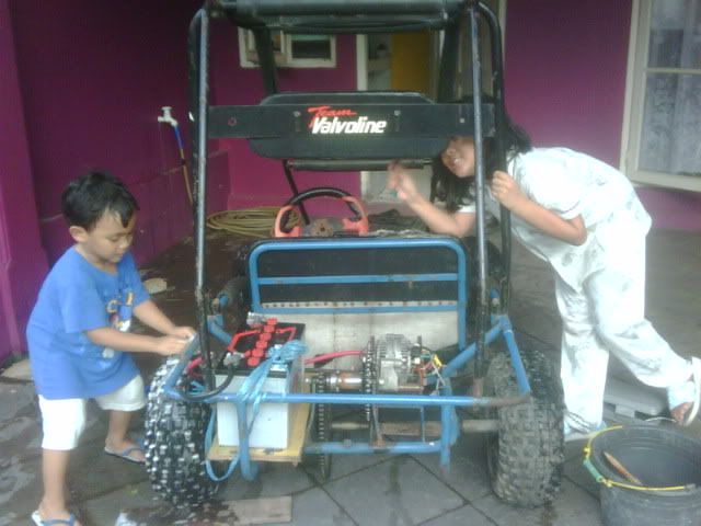

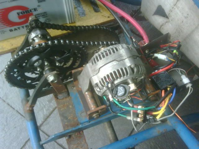

Anyway, installed the motor today, but the bench test shows that though the torque is big, it does takes quite some amps and makes my 25C 3S lippo warm up quite rapidly :shock: (this quite old battery hence might be one of the reason together with the advance timing) . Nevertheless, the ESC did not shows any excessive heats up, so I its time for the real testing.
Installed the motor
and have a quick 1 km trip including the extrime climbing in the same place as shown in the previous video. The result are:
1. Crisp throttle response
2. Smooth start up
3. No more low rpm outsync, a very noticeable difference is on the car ramp on my garage, as previously it would requires some sprint up for 2 meter to succesfully climb it up. Now I could easily literally crawl up in a very low speed from a standstill.
Video not yet available for a couple days, as I still having problem with my PC to BB connection.
Still, these are two very happy children, having their eBuggy improved (they did sat besides me during the improvement process :D ), washing it up for tomorrow cruises after a month project :D .
