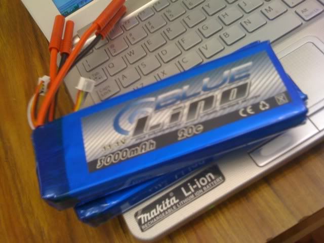

jesus christ thats a lot of lipo! i think i need more!
so far this is what i have:
well i have 4 of these packs. time to start saving for more...lol.

I'd read you bought the world supply of those hardcase packs.
Somehow, your bed looks softer than mine.
Someday, I may even get the charge card paid off for what I bought since last summer. I just kept having this nightmare where I was at the race, recharging for the main event, and the charger goes poof. So I wanted a big pile of batts.
Back to the thread subject. Answering itchyknackers question. I have permanently connected the power leads, but the balance leads are still seperate. This allows periodic checking to see if the pack needs balancing, and which cell if any needs individual balancing. If way off, you charge just that cell in the bad pack. If only a little off, you connect the jst balance paralell adapter and charge.
You could also paralell the balance wires permanent, but I like the idea of keeping the plugs intact at least, so you can check an individual pack.
Of course, you break in your lipo before cutting up stuff. No sending back packs with the wires cut.
My bad pack ratio just inproved. 26 packs, and only two stinkers.
Iv'e done the red to black discharge test on one of my 5s 20c packs. As LFP has said many times, the tabs act like a fuse. Now I have a new 4s pack. Thinking about running a bike light with the 1s pack that is left, if I can come up with a decent way to connect to a tab 1mm long. I'm thinking some kind of crimp, after scraping the plastic back.

dogman wrote:Most likely you'd notice a lack of range first, then see a bulging pack later. The case might help a cell not puff. Aren't pouch cells happiest when squeezed hard? That's the purpose of the round cell cases from what I have read.
Yep. The tighter the layers are pushed together, the better they perform. If the vacuum seal is not lost on a cell, then if it's say 2" wide by 6" long, it's got 12 square inches on each side, so even if the vacuum is just -10psig, it's all ready got 120lbs of clamping force on it. But once they puff, you gotta get the gas out, and get the clamping load back mechanically (or, replace the pack if you're trying to be most safe).

Sooo many ways to do it.
Here is just one. Picture these two sets paralelled packs get charged on two chargers, or any of the other zillion ways to charge lipo. The two plugs are unplugged from the bike to charge.
Then the batteries are plugged into the series adapter shown which is part of the bike, the two long wires going to the controller.
No confusion, no Kentucky fried fingers, the connectors shown can only be plugged in correctly.
This photo shows one of the decent ways to connect a 12s or 10s pack to a series adapter for discharging. Another pic, showing hooked up to discharge For a 15s pack, you could just make the adapter bigger.

Re: Yet another, no solder, paralell lipos thread
I've been getting ready to do something like this paralleling for my 18S4P Lipo pack. I like to parallel the wires in a connector pin's crimp tube and avoid having extra crimping junctions in the circuit. As it turns out, crimping four wires together makes a bundle six gauges lower in number. So:
four 12 gauge wires make a 6 gauge wire (12-6)=6
four 10 gauges wires make a 4 gauge wire (10-6)=4
The Anderson SB-50 and PowerPole 75 will take up to 6 gauge wire. So they will accommodate four 12's. Since each 12 is carrying 1/4th the current (more or less) it is still pretty capable, and makes a very clean adapter with 4 into 1. This should be adequate for most ebike needs.
The battery side would remain the 4mm dual bullets that come standard. Those seem to work adequately, though they take a lot of damage if you let the cap charging arc hit them, the coatings are really thin. So make sure you have a precharge solution or use some other connector to take that damage.
If you want to use 10 gauge wire to maintain the Turnigy pack native wire size then you can use an SB-120 or PowerPole 120 which can take up to number 2 size wire. Then you can accommodate more than four wires into one, perhaps even six #10 wires will fit into the #2 pin socket...
I am considering five into one, four for load and one for charging. Probably have to use SB-120's, or perhaps I can just use four 12's and stuff a fifth smaller wire for the charging connector into the #6 pin. My plan is to leave the big connector hooked up during charging and have a smaller one to connect to, but one could also charge through the large connector. That would insure isolation during charging, so that might actually be the best setup. I am also designing a little pc board for paralleling the Turnigy JST-XH balance connectors and providing a DB-9 for the charging balance connection. So the Turnigy batteries would be completely stock in their connectors (4mm bullets and JST-XH balance leads).
I noted that the SB connectors are generally less costly than the corresponding PowerPoles, and slightly smaller. Powerwerx had pretty good prices, but I have not shopped around lately on that. The SB-50 was about four bucks and the SB-120 about six.
