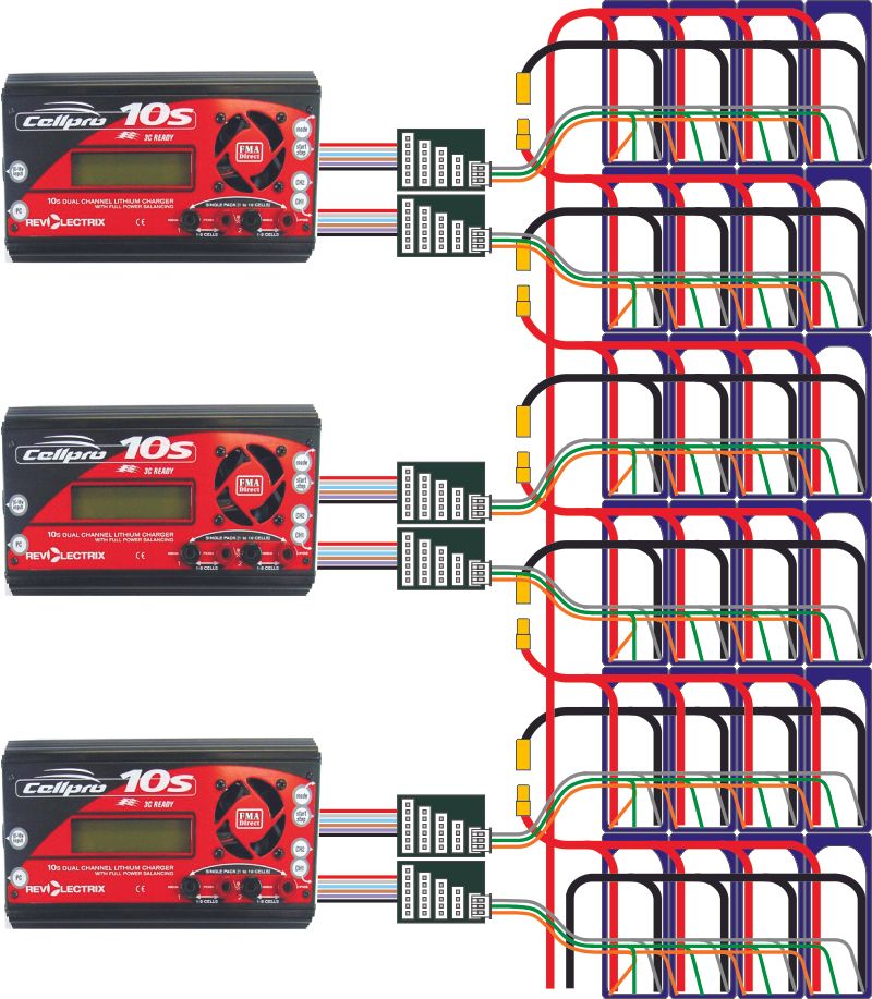

I was passing the time on the computer yesterday and came up with this lipo battery pack that could be used on my scooter. This is just out of curiosity and just to think of another option besides the Cellman battery I plan to get in the spring.
This is done with Turnigy 2S 5800 mah 25C lipos. 24 of them for 44.4V 23.2 Ah. Once done the whole pack would probably weigh around 25 to 27 pounds depending on what I would use for a box. Why 2S when I see a lot of people going with 4, 5 or 6S or even more. Well from my experience, I found that for me it is so much easier to work, repair or rebuild a 2S lipo then a 4 or more cell lipo.
I already have one Cellpro 10S charger and it is awesome and very easy to use and safe on lipos. They are sold pretty cheap on HobbyKing so I could get two more for $262 shipped. Not including custom fees that might be added. The battery pack is inaccessible on my scooter and I need to disassemble most of the rear body panels to get to it so the plan would be to have only the balance tabs stick out through the plastic of the under seat compartment. The tabs would be protected from dirt, dust and water and I could balance charge every time easily. I don't need to fast charge as I always do it at night.
The total price of the 24 lipos needed would be $776 shipped. Not including custom fees that might be added. So a total of $1038 shipped for lipos and chargers. Not including custom fees that might be added.
So here's my concerns about this, again just out of curiosity. It seems a bit pricey but it is the most powerful battery I could get and there are two very good chargers in the mix. But there is time and effort involved here, and I have to make some kind of box or enclosure to house all these lipos securely. My biggest concern is that I plug in the scooter in the evening to recharge to have a cheaper rate on the electricity. It drops to half the cost after 7 pm. I'm nervous to keep such a large number of lipos unattended while being recharged over night. I'm not one to believe you have to sit and stare at lipos for the whole charge cycle but the way my scooter is used, I come back from work, park in the garage, plug it on the charger and forget about it until the next day. Not something I want to do with lipos.
Because of that I don't think lipos are for me. But still, if I had an extra thousand dollars to spare, it would be a fun project. Just thinking out loud here. Thanks for reading.

Are those chargers totaly isolated out puts???

I'm not sure what you mean by that arlo, sorry. Do you mean if the charger can separately charge two packs at once? If that is what you mean then yes but it will treat two packs as if they are in series. Like connecting a 3S pack on channel 1 and a 5S pack on channel 2, it will read them as being one 8S pack.

No it can sepratly charge 2 packs but when you hook the two packs in series and you are trying to charge them sepratly then you have big problems. Are you going to dissasemble the pacs?mistercrash wrote:I'm not sure what you mean by that arlo, sorry. Do you mean if the charger can separately charge two packs at once? If that is what you mean then yes but it will treat two packs as if they are in series. Like connecting a 3S pack on channel 1 and a 5S pack on channel 2, it will read them as being one 8S pack.

I think I might see what you're getting at. In my drawing, I have 6 clusters. Each cluster has 4 2S packs in parallel. then the 6 clusters are in series and that's where the mistake is right? In order to balance charge the 6 clusters I would have to disconnect the series connections first and reconnect only once the recharge process is completed. So I would have to have the six balance tabs poke through the under seat compartment AND also the 5 series connections so that I can disconnect the series. And then have a way of reconnecting the series in the right order. I think I should delete this drawing I posted.

I actualy have 31 isolated 4-5v power supplies to charge at the Cell level so I can set them all to 4.2v and ballance charge safely evey time. I just need to build it.

each cell would have it's own little charger? That's cool. Here's a new drawing with 6mm bullet connectors to unplug the series connections before charging by the balance tabs. Now that would work. Not the fastest way to charge but I can go up to 4 amps on the balance tabs. A couple pig tails on the + and - leads of the pack with bullets at the end and I could balance charge the 6 clusters at once at 10 amps.
