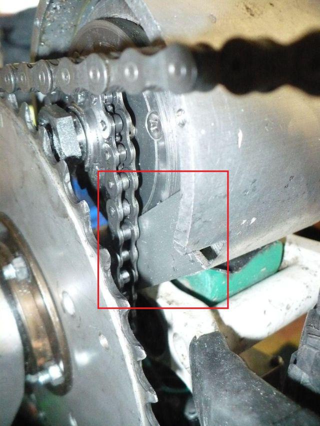

The RC setup is nearly complete. Here is a picture of the idler I had to build with my CNC. The wheel is out of black ABS with an internal skateboard bearing. Works very well. I also have the controller finally mounted. Quite happy with how everything is coming together. Currently I have the Turnigy on the bench to be fitted with hall sensors. I still have to build the battery packs out of A123's, but might use Lipo's to get it up and running. The shafts have all been keyed so the only things I expect to break are the chains. Alignment looks good, and I can adjust out any chain issues. It should be a fun bike to jump with all the components near the center. Very solid, should take a lot to break it. It won't be very stealthy but it's sure to turn heads.
Controller, I kept the mounting hardware light when possible.

Re: RC Turnigy 80100, FS Kona Cowan DJ, A123 build.
In Germany you may have a gearbox to build en ebike from almost every producer if you ask kindly ( here in Germany there are alot of transmission producer).
I guess if you ask very kindly, almost any supplier would gain you a sample, if not for free when you have commertional interest. So it should not be too exhausting to get another of your 8:1 drives.
Btw suggest to keep distance betwenn BB and your motor box with a direct connection like i did in my (250W) tongxin project.
Chain tensioner:
Chain tensioner for fools but better than nothing
flew away at 1,2 ridden meters but now i've got sth. better... just develop ...
(that's all the fun you'll get... besides of ... riding..?)
Chain tensioner:
It's hard to tell if that's #25 scooter chain or a standard bike chain. If it's a #25, your bound to have troubles. I'm only using #25 for my first stage. My output stage is actually 1/2 link BMX chains. Much stronger than standard bike chain. The bike suspension itself pivots around the bottom bracket. No chain growth to worry about. Different from most suspension frames. I really don't expect to see any chain issues, other breakage. If that happens I will truly be impressed.
