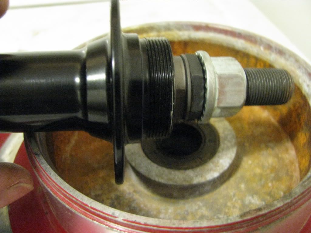

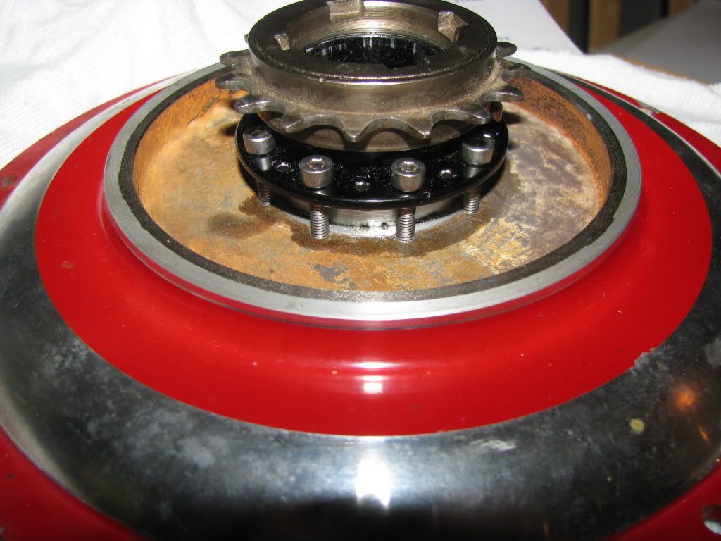

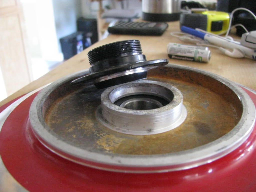

They may fit into a DH bike with 150mm dropouts. I took the side cover with the drum brake chucked it in a lathe and cut it down. the other problem is the more powerful ones don't have a place for pedal chain drive, so I bolted a hub onto the side for freewheel threads.

Postby ElectroSurf3r » Tue Feb 28, 2012 12:58 am
etard, fantastic. well done sir.

Postby Spicerack » Tue Feb 28, 2012 1:39 am
More details please etard? Type of motor, how you lace it to a wheel, power, price etc?
Btw, love the simple solution for putting the freewheel thread on the hub!
