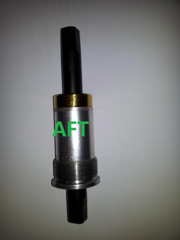

To all we would like to annouce 1st on Endless sphere our new laser cut bottom bracket mounting kit in Jan 2012
The bracket suits the commonly available Headline motor and controller's as we have found them to be a very durable product. Our test mule has done over 3500km of road use on the original motor controler and gearbox.
This mounting bracket will suit nearly all bicycle down tube designs. Additionaly we have added 10mm adjustment freeplay in the motor bolts, hence no chain tensioners will be rquired.
We also have available the ACS crossfire freewheel machined for the crank freewheel and motor freewheels. During our testing this has proven to be the most durable and value for money freewheel available and a significant upgrade to the commonly availble DICTA freewheels.
These upgrades will be released for sale with our complete kits in 2012

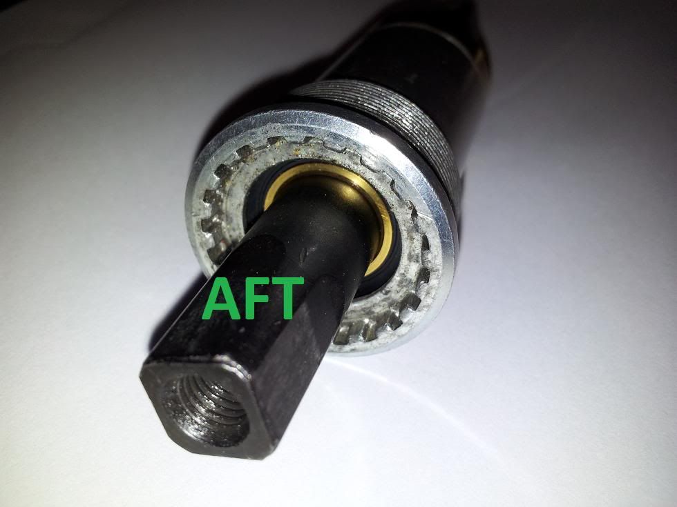

Where have you been all my life??!!!! Awesome freewheel, that mounts on the cassette hub tooth pattern, correct? I will be ordering 6 thank you sir for providing this long-awaited product.
Email sent. :P
Edit:
That freewheel gets me EVERY time!! :evil: It's still threaded for the cranks and hub isn't it?

etard wrote:Where have you been all my life??!!!! Awesome freewheel, that mounts on the cassette hub tooth pattern, correct? I will be ordering 6 thank you sir for providing this long-awaited product.
Errrrrr, no. We think that's just the 6 spline recesses for the removal tool you're observing - it won't fit a 9 spline cassette driver..... :)

Postby AFT » Mon Sep 24, 2012 12:06 am
To all we have a new product release
It is an offset Bottom Bracket Cartridge 153 mm fitted with hybrid ceramic bearings that helps increase drivetrain efficiency hence increasing the speed and range of your bicycle.
Featuring:
Titanium Coated Races with Ceramic Balls, Durable and long life, High Rolling speed Sealed Bearing with less frictional losses. Lifetime 5 to10 times Longer than normal steel Sealed Bearings
Price: $143 AUD for BB fitted with ceramic bearings.
http://www.af-tech.com.au/Products_Ebikes.html
JIm
aft_ebike@hotmail.com
**Note this item is custom made to order, so their maybe 2 week lead time if we have no stock on the shelf. **
