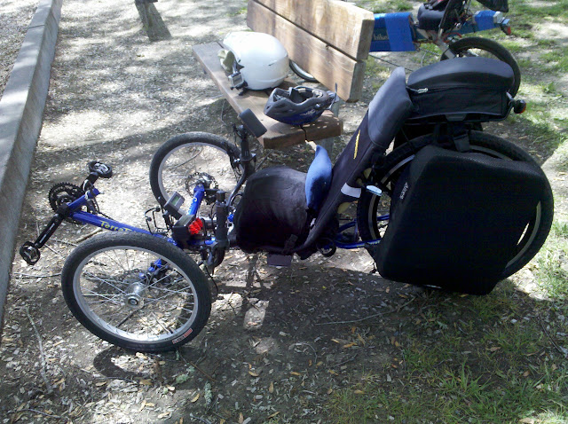

I moved the seat forward a little today, about 3/4 of an inch. Felt good, have to ride farther to judge it.
Recharged the onboard batteries with a new Hyperion 1420i charger, balance charged the whole pack at once. :)
Took 6000 mAh to fill them up. Very nice charger. :)
Readjusted the rear brake which had slipped a bit on the cable. It howls pretty loud when applied hard. But it works. :)

Weather has been bad, turned nice today so I took the BikeE out for a spin. 15 miles along the road by the lake. They call it Dam road. :)
Windy, but the BMC powers through it well. Makes about 20-24 mph up on the level and moderate uphills.
The bike doesn't feel totally stable to me, but it goes where I want it to.

EbikeE and BMC for Efficiency
Post by Alan B » Apr 15 2012 1:41am
kevo wrote:Alan, nice photo of the EbikeE and great weather for the crystal blue sky and Reservoir :D
Thanks for the nice comments. Photo with Droid, I need a good way to carry the DSLR safely.
The efficiency of this machine is amazing. At 48 volts (12S Lipo) it went 16 miles on less than 8 amp hours at full throttle 20-24 mph with little pedaling and a lot of wind. At one point I was using 800 watts going slightly downhill! :)
Max power was just over 1kw. This 12 Fet Lyen controller is dialed down to about 23A. I should tweak it up slightly to 1500W or so, but haven't dug into it.

Battery Reconfiguration
Today I reconfigured the battery pack on the EbikeE. The pack was a bit long, preventing seat adjustments. The capacity was 12S 24AH which on this efficient machine was more than I generally need, and still not enough for a long ride. So I decided to reduce it to 16AH. I made some new PVC downspout covers and painted them a couple weeks ago. Today I installed them. It was getting dark so I'll take photos tomorrow, but it is lighter, cleaner and with the new colors of vet-wrap it looks better.
Later I will make some type of extended pack for those long rides.

Here's the rack:
BikeE Pannier Rack
BikeE Pannier Mount.PNG (195.8 KiB) Viewed 2277 times
