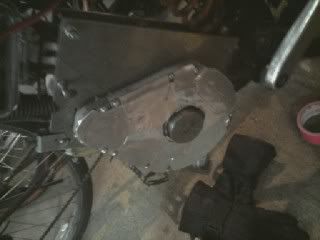

Anyways in other news I made an ass-ugly chain guard for the motor chain. I was hoping that it would make it quieter but it seems to have gotten worse. I will keep it simply because it keeps the chain clean. Pictures will be posted once I recover from my shame
-Colin

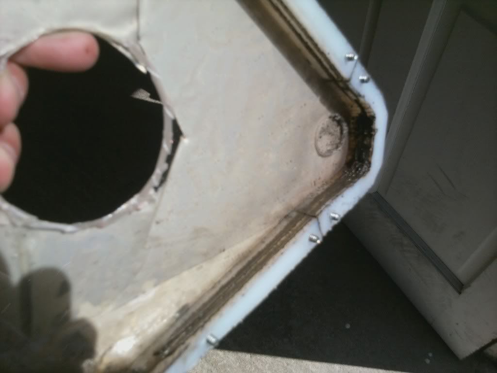

Well here's some terrible cell phone pictures of my new chain guard and the brown gunk that has collected on the inside in the last 50 miles or so of riding. I am not sure if that much dirt has managed to get inside the chain guard, if it is the dirt that was previously in the chain, or if it is some kind of finely ground rust/lube sauce.
Also here is a video from last week where everyone stops for ducks to cross the road. It was pretty cute. Then I also added a video from today where in the process of blowing a stop sign (a very slow-walking old person was about to use the crosswalk and I had to get there first) I saw a dude riding a very strange looking motorcycle with a small child in a sidecar. They both stared at me, probably because I was being a bit of an asshole by riding through the stop sign and because I was riding a vehicle that is almost as strange as theirs.

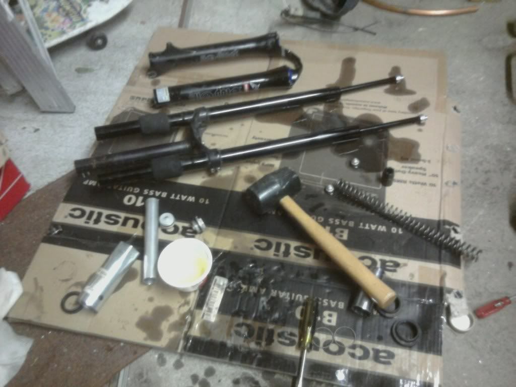

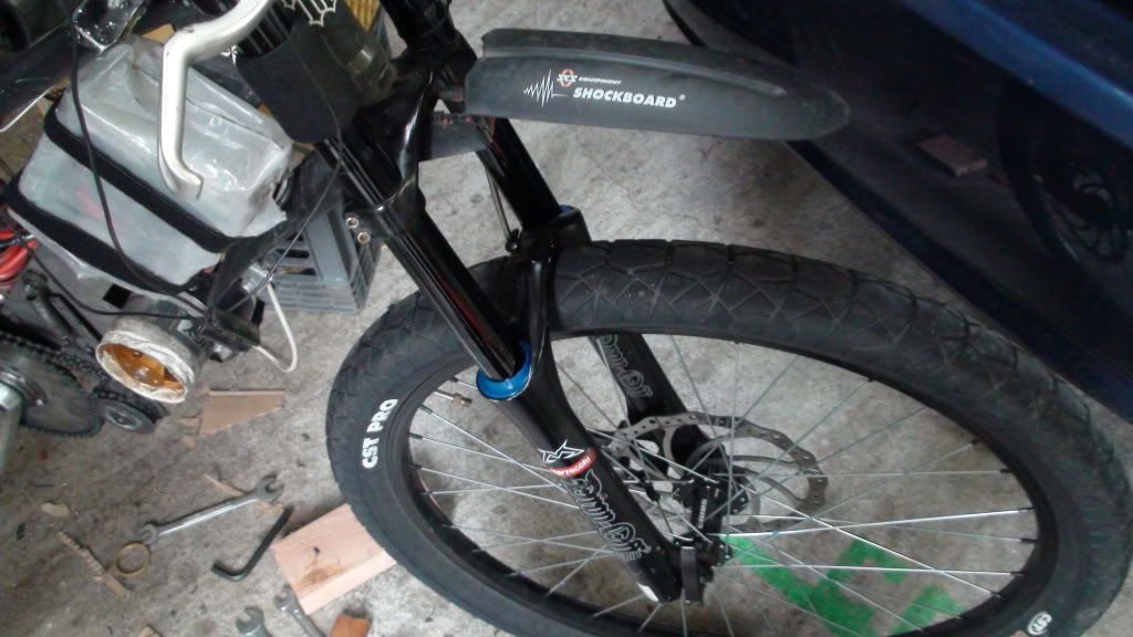

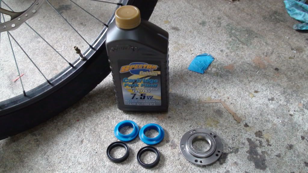

Well, in a burst of hyper-productivity coupled with a complete lack of a social life this weekend, I managed to rebuild my fork last night and swapped my freewheel for the fancy new ACS one today.
The fork, taken apart
The replacement seals for the fork
Rebuilding a fork for the first time was not too hard, and I haven't ridden the bike yet but just pushing it up and down it feels a lot less sticky.
In the process of replacing my freewheel, I discovered that my bottom bracket is unthreading itself on the right side... which makes sense because it is reverse threaded so it unthreads in the direction that you pedal. Who designed this???

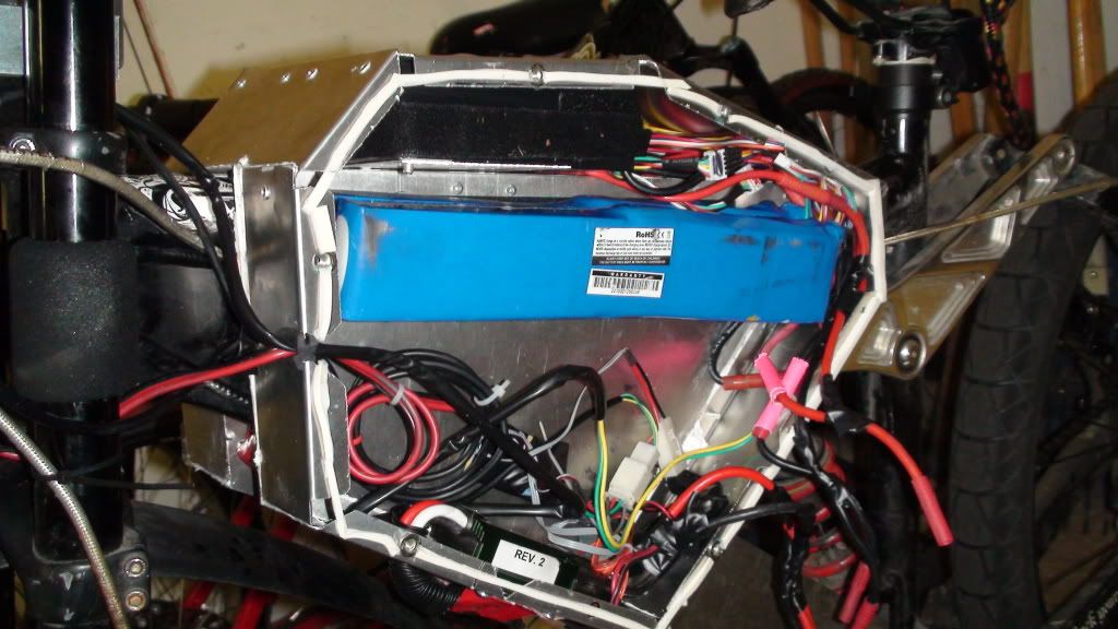

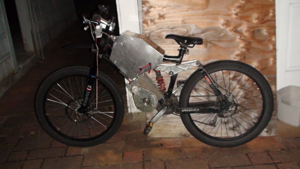

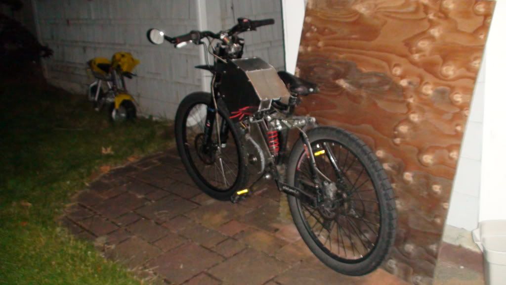

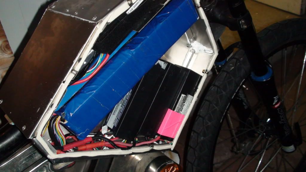

I made my new battery box to fit 44v 20ah! It also holds my controller and stuff. Here are some bad pictures that I just took.
It's not a pretty box but I think it should be a heck of a lot better than what I had.
old
new
original plan
what resulted
And it's made of .032" 6061 T6 aluminum sheet cut with a band saw, bent with a vise, slathered with silicone, and riveted together. I ended up not needing the structural cross-braces. The side panels are held on by rivnuts and are sealed (hopefully) with window/door sticky stuff. It's not sealed well now because it's summer, but hopefully I can get it rain-proof soon! Right now there are just wire grommets to keep them from chafing on the rough panels.
The box will be tested in two days, I will ride it to my work 16 miles away, charge it, and ride it back. If all goes well :lol:
I was going to test it friday but I discovered that I had a bent .5" steel jackshaft from a chain-derailing event in which I forgot to tighten the nuts on one of the freewheel sprockets and it fell off :cry:
-Colin

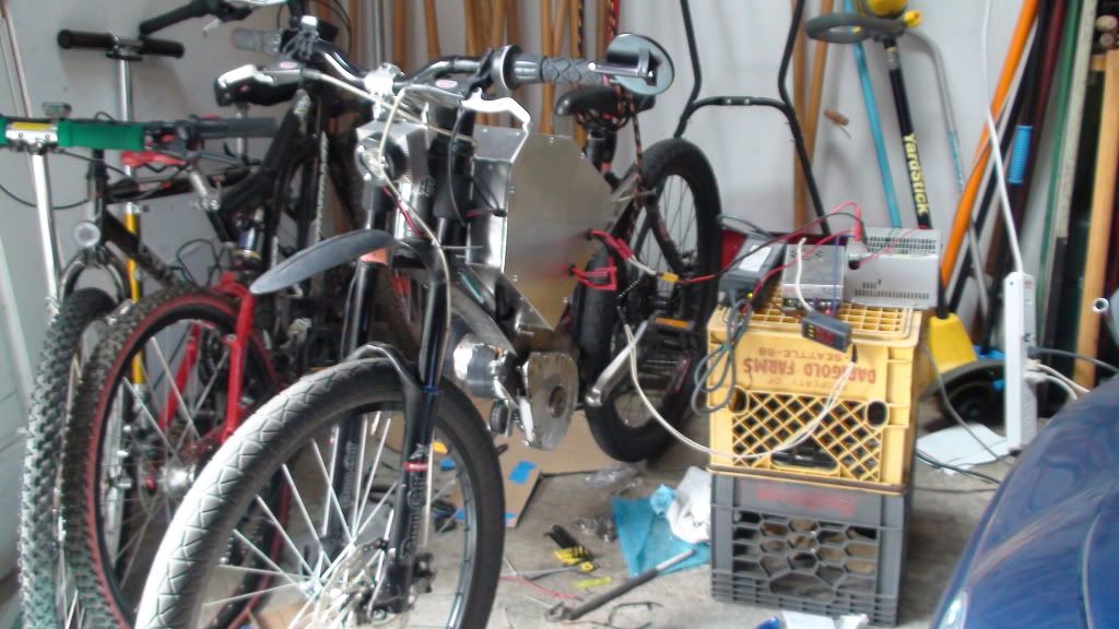

Post by fizzit » Jul 08 2012 8:17pm

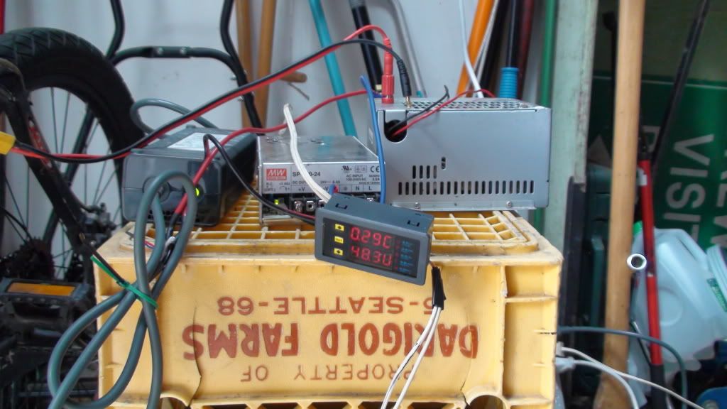

Here's my bike charging for the 16 mile trip tomorrow!

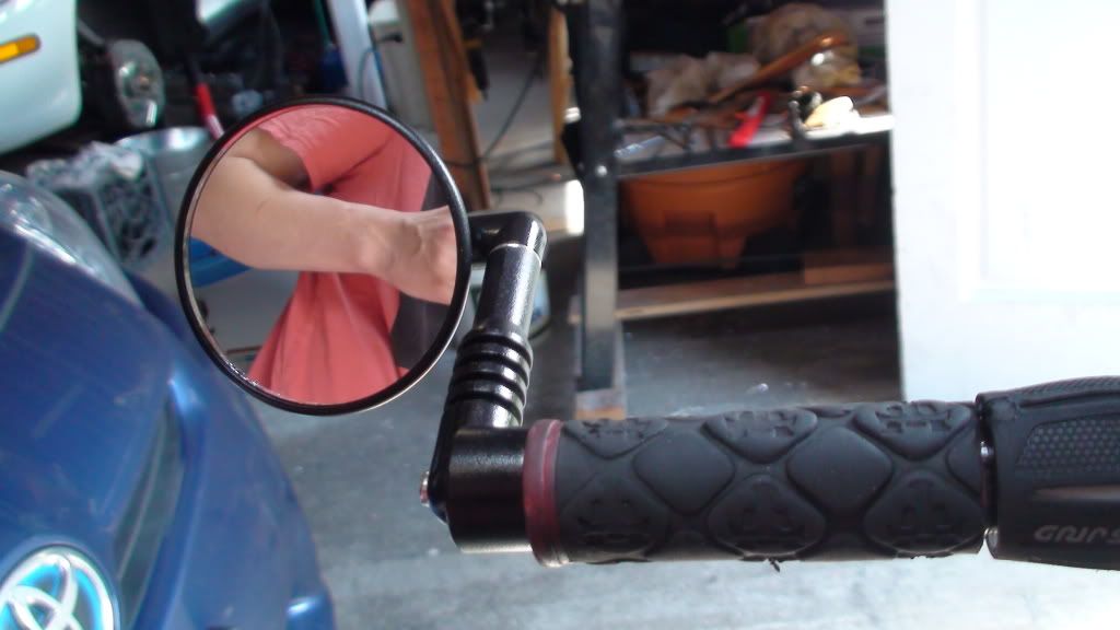

And here's the new Mountain Mirrycle I got. I think it will come in handy.
On another note I switched to a 12t #35 sprocket when I made my new jackshaft. The bike is noticeably quieter! This should keep some people from getting mad if I ride past on the bike path. Hopefully.
-Colin

My mirror helped a huge amount, it made riding a lot easier. I regret going for so long without one.

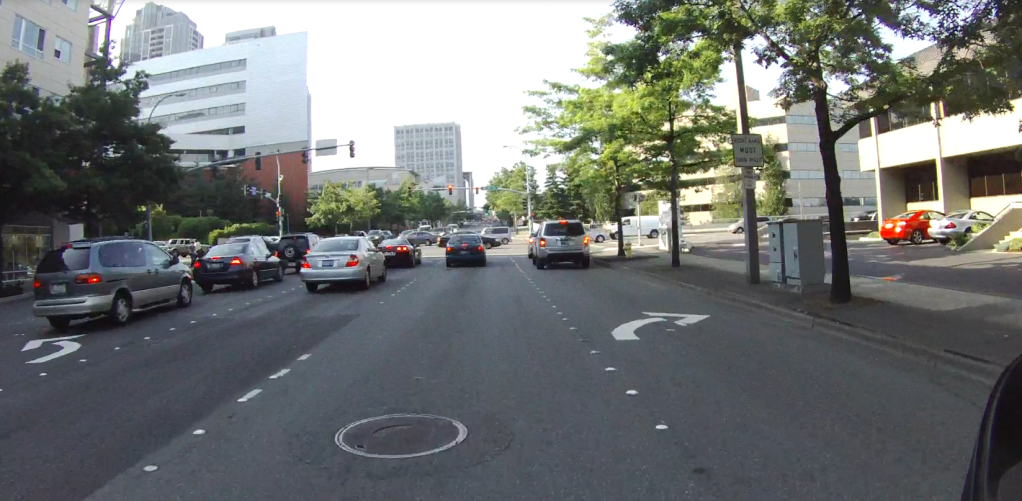

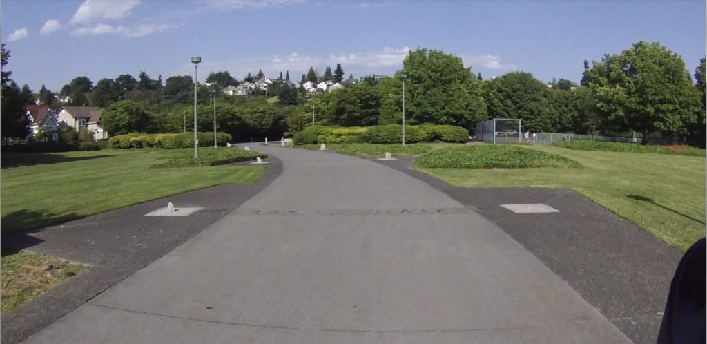

I started it off leaving the warehouse and I had to mix it up with traffic in downtown Seattle

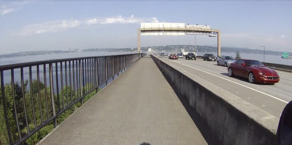

Then I headed through some nice parks that lead to the seattle end of the I90 bridge trail.
Slightly ominous entrance to the I90 tunnel
Then onto the I90 bridge!
It was a great view except for this guy halfway across who was either completely and utterly baffled by my bike or was giving my the evilest eye that he could muster. I'm gonna go with the bafflement. Other than him, no one really seemed to care about my bike as I went slow and pretended to pedal when I passed people.

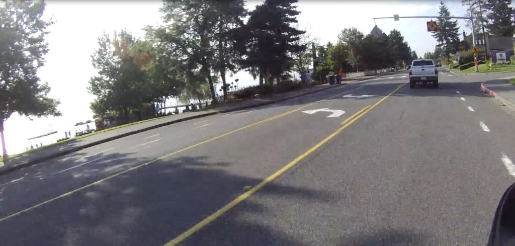

Then through bellevue
and into my hometown kirkland, where I was unfortunately snarled by traffic for a few minutes before I found a detour to my house.
And that concludes my 34 mile commute!

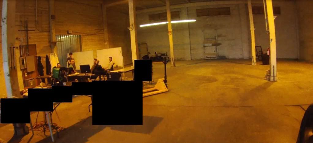

A mirror helps so very much that it is baffling to me when people I know refuse to use one for whatever reason. :?
BTW--the blacked out sections in the warehouse pic have me intensely curious what is so secret it must be covered up. ;) I have been resisting the temptation to try to figure it out from shadows and such.... :lol: If I had time, i might try anyway, but I don't.

amberwolf wrote:A mirror helps so very much that it is baffling to me when people I know refuse to use one for whatever reason. :?
It's true! I used to live in constant fear of someone passing me. Now I feel like I have eyes in the back of my head. It definitely changes the whole riding experience.
amberwolf wrote:BTW--the blacked out sections in the warehouse pic have me intensely curious what is so secret it must be covered up. ;) I have been resisting the temptation to try to figure it out from shadows and such.... :lol: If I had time, i might try anyway, but I don't.
Hmm... well looking at the video, I'm not even sure what it is :P
It's stuff for a project at work that I'm not a part of, so I don't know if they have any secrecy/privacy concerns and I just want to stay on the safe side.
-Colin

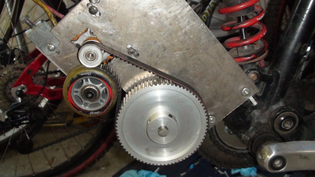

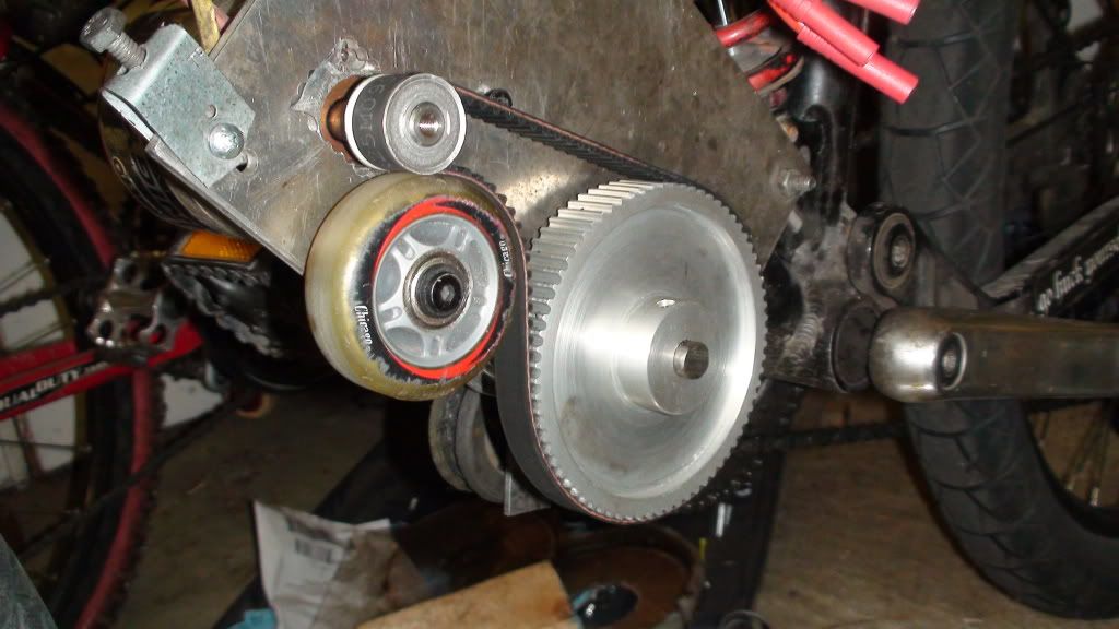

Post by fizzit » Aug 09 2012 3:08pm
Belt drive: implemented
I rode the 17 miles to work today and it was quiet and that was the only difference I noticed from the chain drive 8)
I thought I was going to have to take off the motor mounting plate to drill a hole for the tensioner but I discovered that I could use one of the motor mounting bolts to hold it. And it slides with the motor.
I also made a parallel board with a bunch of HobbyKing JST-XH extension wires so all my cells are paralleled and there is quite a rat's nest in the battery box. Oh well!
Thanks to recumpence for the tips on the belt drive!
