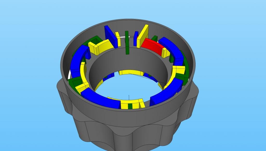

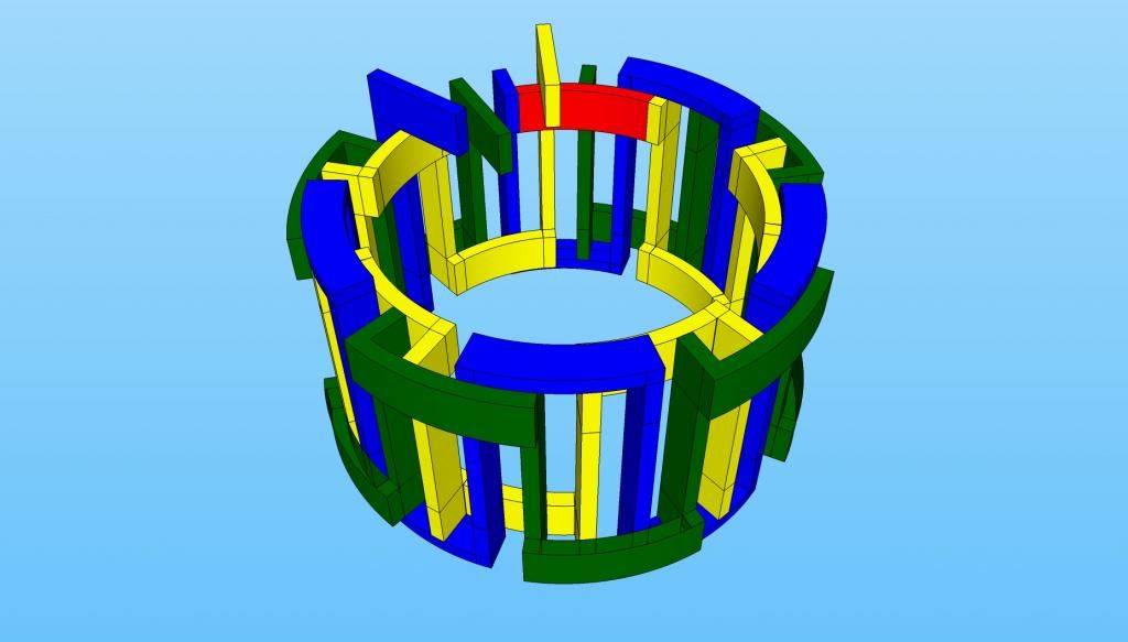

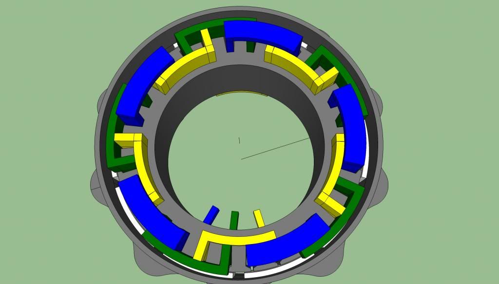

ok, here is a rough drawing of the motor. The windings look complex, but will actually be very easy to construct.
Overall dims are 12 inch dia x 7" thick can end to can end.
The copper wire is actually 25mm by 6mm solid bar.
Test Review Revise Repeat

Post by liveforphysics » Nov 02 2013 11:36pm
Beautiful. Going to be low inductance.

liveforphysics wrote:Beautiful. Going to be low inductance.
I am hoping its not too low. Ill run it thru emetor in sine wave test to see if I am even in the ballpark of driveable.

Post by Farfle » Nov 03 2013 12:46am
hmm, emetor is spitting out 0.005797 mH or 5.7uh. thats really really really low. bugger.
Back to the drawing board!
