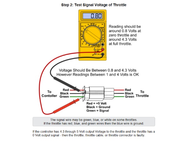

Nice easy to probe connections! Nice. Tip: If your meter leads are too big to back probe the pins. Stick a straight pin in and use alligator clips...
True that you would be looking for a three wire connection. But I'm not convinced that is the one. It would be odd that it is split up and goes to two different controller connectors. But take your voltage meter to it and check to see what you have. Use the testing procedure picture posted above. No harm will come by testing for voltages, unless you short the probes together. :( Do not short your probes together. Any high voltages, and your not in the right place. Should have 5vdc and lower. Don't the brake cable, and the two button push button switch assembly cable head down there too?
I'd look at the controller connections, for one with three wires. Test it, and see where it goes.
To review,
One wire 5vdc+ supply.
One wire 0vdc- supply ground or negative.
One wire sensor output ~.8 vdc to ~3.6 vdc as throttle is twisted to wide open throttle. (WOT)

Now to the other possible black cable , there's is a white and brown that go somewhere, and there's a black red and blue, so black is the negative /ground, witch one is the signal?
omadawn   10 W
Posts: 90
Joined: May 16 2019 9:56am
Re: Test The Brake Lever Switch help
Post by omadawn » Jun 02 2019 12:05pm
Ok, I got 0.83V on the blue, and 4.3V on the red...
For my desperation, it seems everything normal here too... :? :cry:
