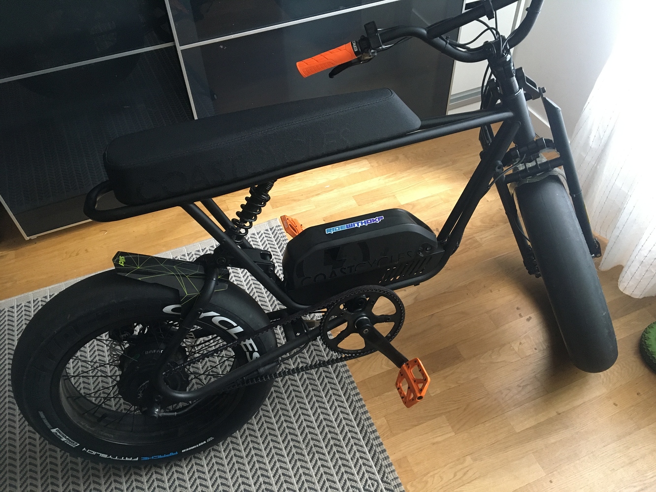

PM sent ! I'll go BBSHD / EggRider v2 / ASI 855 for my Coast Cycle upgrade Buzzraw
