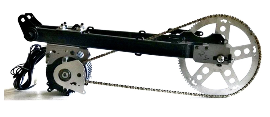

Noob here especially about how drivetrains work so please be gentle
Would it be possible to set up a Lightning Rods Big Block with its left hand heavy chain driving the rear wheel
completely separately, from a **mechanical** POV, from the human-pedaling force driving a relatively weak IGH ?
Application is a heavy tandem / cargo with occasional very long climbs up steep mountain roads.
So I want that crazy high torque when needed, but reckon that would likely destroy the gearing hub.
So, ignorance showing, does this mean two freehubs?
or a freehub plus a freewheel or something?
Please don't argue against the IGH idea - for purpose of this thread anyway, assume a thought experiment to isolate out this one specific question.
I'm fine with a single **very** low gear for the motor, and if that means basically human power only on the flats, once past 15mph, that is also fine
but ideas for getting shifting, say maybe 3 gears would be welcome, if it doesn't complicate things too much?
Would also like strong regen for safe drag braking on long descents minimizing pad wear.

Realized I may not have written clearly enough
john61ct wrote:completely separately **from a mechanical POV** from the human pedaling force driving a relatively weak IGH ?
Is this meaning two freehubs, or a freehub plus a freewheel or something?
that I want the lightning rod's left-hand #219 chain to drive the rear wheel at high torque / low wheel rpm say grinding slowly up a long steep slope
without going through the relatively weak IGH.
IOW that the IGH is only driven by lower-torque human power, for example on the flats at higher speeds, say 10mph and over.

totally possible. Not all that hard, depending on the IGH. They make sprockets to fit on disk brake mounts for ebikes and ICE bikes conversions, so adding a left sprocket is simple enough. The only hard task will be in setting up a freewheel. You won't be able to add a freewheel to the left side wheel sprocket, so you'll need one at the motor or on a jackshaft in between.
Building a multi-speed left hand drive is the kind of thing you need access to a machine shop for. I'd do it with motorcycle transmission gears, but someone posted plans of an chain and sprocket transmission on here once. it's possible to make something like that, if you have time and the tools.

Yup sprocket on the disc mount. Two problems:
1. Practically all gas motorized bike hardware relating to rear chain is going to be a half inch pitch, usually for 415 or 420 chain.
2. An IGH is not designed for motor use. So whatever little 10mm axle in it is going to break or bend with too much power. And that is not an easy or cheap thing to replace on an IGH.
If you’re dead set on going IGH I’d run it as a jackshaft like on a trike and figure something more robust on the rear. Too much work though.

The point of this thread is exactly that, as in the title, I want the left-hand chain drivetrain to "bypass" the IGH since its torque is too high.
So only the pedal chain - human power only, completely separate drivetrain - goes through the IGH.

Yes, look at stuff meant for ICE motors, for what you want. It will be fixie, meaning the motor always turns if the wheel does. It will drag some while coasting, but like hub motors, you can just tickle the throttle with a tiny bit of power, and then it will coast freely. Very little use of power, but if you go to zero throttle, you will get a mild form of braking from the motor. Much like the engine drag while coasting a car in gear. But you can still have electronic braking with that setup too, which can be very strong.
The big advantage of this setup, is you can choose a gear ratio that suits your needs. Very low gear for slow speeds, but getting huge weights up hills, or faster and more motorcycle like power. Your choice, depending on motor size and gear ratio chosen.
I don't know your needs, but for a low speed high weight setup, I'd look at generic chain drive brushless scooter motors that can run easily in either direction. You can have regen with this, and reverse too. Put the sprocket on the left, and then a big sprocket on the wheel. There are rigs that bolt a sprocket to the spokes of a wheel too, btw. Its all in the gasser stuff.

400-500lb tandem / cargo, Rocky Mountain style climbs, 15mph top speed is fine if needed, max 25 so long as not compromising low-rpm torque for uphill standing starts.
Lightning Rod Big Block is the only motor being considered here, trying to get a handle on HowTo
Goal: (if not already default) get the motor's left hand chain working "as a fixie" so getting strong regen, single speed is fine for now
IGH is only driven by the pedal chain on the right side, I guess freewheeling (or freehub) is standard vanilla there.
I am happy to keep it simple as possible within that context, reliability / longevity are top priority.

> So I inferred direct drive so you could use regen.
I never heard of a mid-drive called a "DD"; I thought that just meant hub motors, which are not included in the scenario here in any form.
I have concluded for regen the mid-drive power train needs to be "fixie", so if that is synonymous with your use of "DD", fine.
> Running a disc mount sprocket would mechanically bypass it but the hub axle itself isn’t suitable for power like the LR BB.
Aha. Do you mean that of every IGH including Rohloff's?
> So yes you’d need to find a sprocket for the motor.
Sorry I don't know what that means. The LR kits look like they are designed to be complete, don't they include all sprockets needed?
Is what you're talking about a big challenge?
> I didn’t mean the SBP setup. IMO that is a stupid setup but lots of people like it. Guess they don’t like engine braking. By hub jackshaft I meant the way rear hubs are used as a jackshaft in trikes or pedicabs.
I do not know anything about how either of those work, nor mopeds nor gas powered bikes, if you can point to learning resources I'd appreciate it.
I definitely want regen.
I also know nothing about pedicabs nor solid vs moped style hubs, but here this thread is about the pedaling drivetrain using IGH, so let's set that aside for now.
> IMO an IGH has no place next to a powerful motor
Do you mean even if there is no mechanical connection between them? Even on separate wheels? Why?

If the axle strength really is a major issue here
do others agree it is?
note that Rohloff offers a QR hollow axle vs a threaded axle which I infer is solid and therefore stronger.
As a whole the assembly is rated for 130 N.m but that is based on shear pins, acting as "physical torque fuse" to prevent damage to the more expensive parts,
I would think the next weakest bits would be gearing, not the axle?

Single speed means no gearing. You can use a freewheel at the back, or you can use a fixed sprocket which would be called a fixie. Since you want regen, that means no freewheels in the system.
Lightning rods' two stage drive (2 gearing stages, 1st stage is belt, 2nd is chain) has a freewheel inside the big pulley, so you probably don't want that one. His single stage looks like it does not have a freewheel, so that should work for you.
As far as the strength of the IGH goes, the disc brake mount should be able to handle all the torque a disc brake normally would, so I wouldn't be too concerned about driving the left side of an IGH.

thepronghorn wrote:Single speed means no gearing
Well there is gearing, size of sprockets chosen etc, you just can't shift.
The LR system apparently makes it pretty quick and easy to swap the front sprockets out for different ratios / uses or terrains.
Well, no freewheeling in the **motor** left-side drivetrain anyway.
Since the pedals' drivetrain (human powered only) is through the IGH and neither is involved with the motor, I believe there can be freewheeling in **that** system on the right side correct?
Wow great thanks for that, I will need to learn more about those details.
Aha great thanks I thought so, must have come from Tony's mistakenly inferring that the motor would be driving the IGH.
_______
So, here is my hopeful understanding, please correct me if any of it is wrong:
The LR kit rear sprocket usually mounts to a disc brake mount on the left side, and modern IGH are usually designed so that is straightforward.
There is no freewheeling mechanism there, and in order to get regen I need to ensure Mr L Rod sells me a kit with none elsewhere, so that whole left-side system is fixie. (Would "fixed" be generally understood for that meaning, I'm irritated by that bit of jargon for some reason)
On the normal drivetrain, right side, IGHs include freewheeling, and the pedaling system will connect there, functioning completely independently of the motor fixed left side system.
But the power output from the two systems will be additive over some overlapping ranges of cadence, wheel rpm and torque required.
This combination can be created mostly from pretty standard OTS parts and is pretty straightforward with some help from a decent bike shop and maybe a bit of custom fabbing by a machine shop.

Yeah I think you understand everything. The term "fixie" really only applies to pedal drivetrains in my experience - I'm not sure there's a term for "non-freewheeling mid drives" besides just calling it what it is.
I'd say the hardest part about a left hand drive is chain routing which gets even more complicated if you are using a bike with rear suspension. The chainstays have to be narrow to clear the pedal cranks before they flare out to accommodate the 130+mm rear hub. Running the chain through there if you want to put the motor/jackshaft above or below the bottom bracket is difficult. I'm interested in the solution of putting the motor/jackshaft in front of the bottom bracket, but it's a pretty long chain run at that point which I've read is susceptible to chain drops. One example of this configuration would be district9prawn's linked below.
