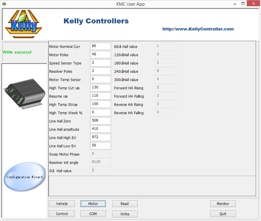

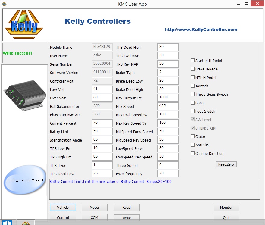

Hi,
I could use some help with my e-scooter configuration. It,s a dutch model ''Novox C50'' with 2500w motor.
The battery is a 100ah 48v lifepo4 with bms, controller used is a Kelly KLS4812S (https://www.kellycontrollers.eu/kls4812s.
I have no experience with setting a controller up.
I'd like fluent acceleration and a top speed of ~33 Km/h GPS. I prefer long action radius and battery longevity over speed and acceleration.
Had someone help me with setting the motor poles but I'm encountering some issues:
1) speed goes up to 41 KM/h (scooter dashboard speed) and drops down after a few seconds to 34-35~ Km/h, then speed goes up to 37 Km/h stays like that for ~15 sec, then speed goes down to 35 Km/h again, goes up to 37 Km/h and stays that way. Every time after releasing throttle this process repeats itself.
2) regen sometimes makes my scooter turn off, battery bms protection? RLS_TPS Brk% was set at 10, now lowered to 5 but haven't tested yet.
Can someone give me advice to optimise controller settings?

flippy wrote:
Oct 04 2020 6:27pm
turn the regen off until the bms settings are changed.
the speed hunting comes from the kelly not wanting to do the brick wall style that sevcon does and it just tapers off the acceleration. that jo-jo's a bit until the speed is stable. its mainly due to putting high voltage and currents in a motor that is forced to run at low speeds.
you hit the artifical limits way too hard before you get to the "natural" limits of voltage for example.
best thing you can do is reduce trottle when you get up to speed. when you hit 35 you can hold the trottle open again.
dont worry about getting a ticket, they have to wait until the speed is stable so you dont get a ticket.
Is it possible to change settings in the controller to make this jojo effect less noticeable?
Speed is varying between 45 km/h and 29km/h (dashboard speed) at the moment and it's kinda annoying, speed stabilises (but still hunting) between 35-38 km/ when holding full throttle.

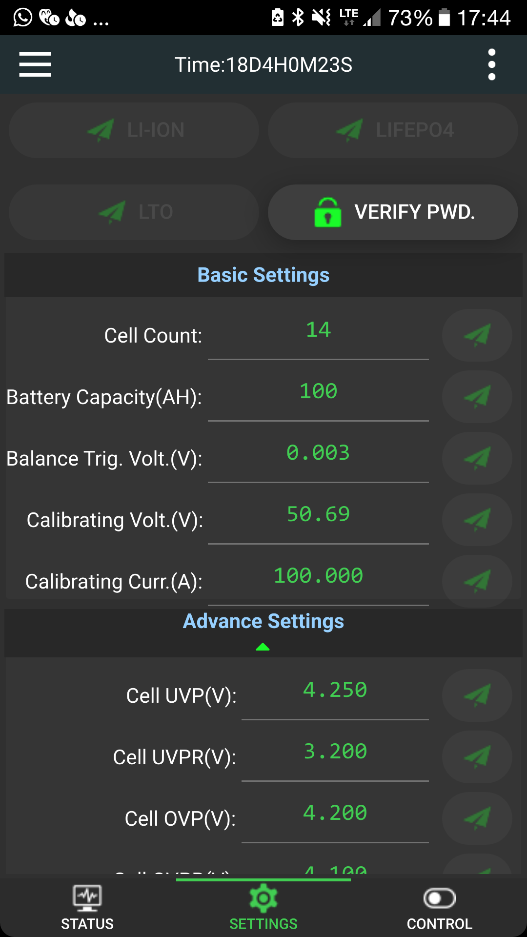

bms screenshots:

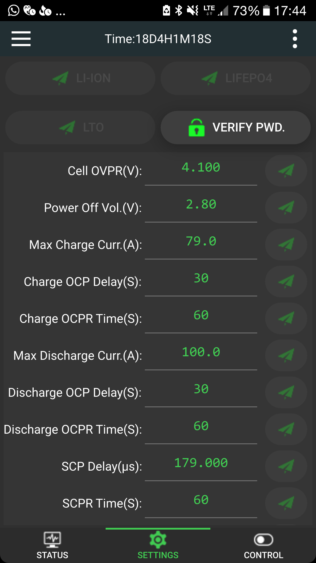

I forgot to upload a screenshot of the bms failure
' Protection (discharge short circuit) (2s)'
I talked with M and he said he was worried about raising the upper voltage limit because the bms reports a short circuit.
Any thoughts on this?
>this is only an issue when you are fully charged. once you have driven a bit the problem will go away
The bms protection also kicked in when the battery was around 80% full, so what's going on there?
flippy   10 MW
Posts: 2417
Joined: Aug 12 2015 3:07pm
Re: 2500w / 100Ah Lifepo4 / KLS4812S controller e-scooter configuration
Post by flippy » Oct 13 2020 12:48pm
max discharge current is set to 100A. that needs to be increased to the maximum.
Lithium beats liquid dinosaurs.

flippy wrote:
Oct 13 2020 12:48pm
I can't increase the max discharge current, when applying the setting the app reports 'command send failure'.
Is this setting normally adjustable or do I have to change other values before I can raise this?
Any ideas?
