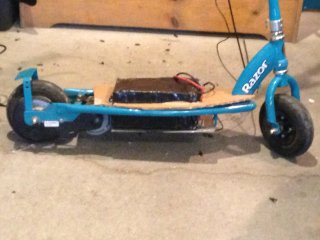

I got it working with the yiyun controller and the battery only sticks up 30mm from the metal frame.
I am looking for knobby tires for the snow, 200x50 wheel some of the us vendors want gold prices for shipping.
A golds fortune for these guys https://www.monsterscooterparts.com/cat ... /?q=200x50
Amazon is all I've been able to find with generic tires with shipping from China and Amazon fulfilled.
Larger fork for larger tire is on the wish list along with larger 9" or 10" rear wheel

ebike throttle through the box hole, just controller inside. Battery wires will string out rear hole to back pack.
Not a good setup
No room for big feet between battery and wheel.
One could make a battery easily, I would not go 7 but 6P 10S 36v because the battery box curves down to 10.5cm. Middle is only 16.5cm wide. I would also put the controller on the outside where the Razor logo is to help with heat management. Cheap controllers heat up to much with air cooling should help out. Expensive batteries need to be taken care of.
Copy 18650 Razor_LI.jpg (900.65 KiB) Viewed 1113 times
It is to much work dealing with the battery raised above the deck and making a cover for the rear wheel so I put the battery box back in, with the controller inside and wiring the battery out to a back pack with 10awg silicone wire. This will help reduce the weight when I fold up the handle bars and carrying it into places and I wont be worried about the scooters batteries when its locked up outside. Scumbag thieves are less interested in kids scooters then ebikes, they should be stealing the rental scooters and I wonder what the loss rate is because those batteries are sure interesting.
I took the Razor on 2 of the community city buses that are the same size as the small yellow buses for retards, the drivers never blinked.
That means I have to carry the battery on my back or make a basket to put the back pack in while riding. A backup short distance battery will be nice in the battery box with 36v out of 18650, 25r's for discharge or 35e's for max ah distance. It looks like you can stuff 15ah or more in there out of the square lattice 18650 holders.
36v 500w is not enough power, doing short full throttle runs in the garage the scooter doesnt have enough zippy torque, I have not done a full speed test but top speed isnt a big deal, slow take off means it will get bogged down on any hills the best I can do is a shunt mod on the 36v 500w brushed controller. 750w and 1000w brushed controllers are both the same $20 price which isnt that bad until its wasted on a baked motor. The other 350w motor that fits the Razor linked in the post above isnt much power either. I have the same motor 1000w brand but in mid drive format which is 98mm in diameter, 176/199mm long, weighs 6kg. Latecurtis and Drkguy plays with those kinds of motors, I should get in touch with them for info on 1500w unite motors.
I was going to test drive the scooter with the raised battery today but my foot always caught the rear wheel. I will do a test tomorrow with the back pack battery which I hope will get me by because I rode my ebike today with a flat tire have no spares.

The cost I was referring to was for a rim and custom cut spokes.
I have thought about what to do if I was to lace ebike a larger crystalyte hub motor with a 232mm hub flange diameter can fit a 14" iso 298 with a spoke length of 33.6mm I did another screen shot with the paint app, the problem is to keep the scooter level the extended rear frame hub axle dropout has go up 6-8" and back 8-12" and that is not what I want with a large 14" wheel extending way beyond that upwards beyond the handlebar stem mount. I can now focus on using the hub motor to power the razor wheel, which means I have to deal with the bolt I can not undo on the #25 gear so a trip to get propane tank for the torch is in order or I can bolt a bicycle gear to that with a stand off.
I tried to do a scale model of just using a hub motor and it looks very doable, I placed a piece of paper over the monitor and outlined the 8" wheel then added a hair more to get the motor 232mm is 9.12"
The hub with a bicycle single speed will receive a 14-16t freewheel which will power the razor wheel that will need a a bicycle gear attached to it. You can see the big hub motor does not go above the front fixed handlebar stem :thumb: and the foot deck will gain some room with a custom wheel cover.
I have to drum up an idea for braking. :lol: the direct drive can have electrical braking but I need emergency braking capabilities. 160mm rotor is in the pic is a little to large so I will need 120mm https://www.ebay.com/itm/154600526133 and figure out a front brake.
232mm hub on razor.jpg (178.38 KiB) Viewed 865 times

Post by calab » Jan 15 2022 10:02am
Well those are great links to get the brake drum off, I would have just taken a grinder to take down the lip to bolt on the disk but I will do the ebay product.
I want this to be as cheap as possible, I did pay more then I wanted for the e200 as the lead acid batteries were no good. I have two motors a small geared 500-750w ezee clone and a 1000-1500w crysltalyte H-rear clone. The e200's rear dropouts are 140mm for the 135mm hub motors axle flats.
A 12" iso 203 will fit the ezee with 17.3mm spokes radially laced
https://ebikes.ca/tools/spoke-calc.html ... 31&cross=0
But with the Crystalyte H rear is to small for 12" iso 203 rim https://ebikes.ca/tools/spoke-calc.html ... 31&cross=0 but needs 33.6mm spokes on a 14" iso 298 rim. I will do a cardboard circle to 298mm for the erd and add 1.5-2" for the tire height and see what is needed, but like I said the e200 will be high in the rear. Which will need steel welded to the e200, I did make a diagram but I must have deleted it.
The 3 circles are 1) ezee hub to scale 2) 12" iso 203 erd rim eye balled 3) tire od eyeballed
razor e200 a.jpg (229.62 KiB) Viewed 845 times
razor e200 b.jpg (220.9 KiB) Viewed 845 times

I just did a 1:1 scale drawing of both 12" and 14" and the 12" 203 needs a 6" rise and 14" 298 needs 9.5" rise with some extended rear distance I like the idea of taking a kids bicycle from bottom bracket to rear dropout either keeping the rear triangle or not. I will have to think about that idea because that is a very good idea as it saves steel plate stock I have or buying steel plate stock. The 1:1 scale drawing is just computer paper taped together and outlined the erd then added a bit for rim wall then added a bit for the tire for 12 and 14" and the 6-9.5" offset is in relation to the 8" razor wheel to keep the foot deck level. The biggest problem with using a big hub motor like the crystalyte H series needs 14" 298 is the wheel diameter and carry the razor the same with 12" iso 203. I actually did save a draft to post.
calab   100 kW
Posts: 1183
Joined: Dec 11 2013 1:00am
Re: Razor E200 Build
Post by calab » Jan 16 2022 7:47pm
Be nicer to use a higher powered mid motor but the offset is to much to line up the chain properly, the hub motors you can mount a tire to the motors flanges would be awesome http://www.cnqsmotor.com/en/article_rea ... /1049.html
Now, there has two rim dimension options 1. 10x2.15inch rim(Matched tire: 90/90-10) 2. 10x3.0inch rim(Matched tire: 130/90-10)
but for that kind of money you could just go with rc motor and esc but the problem there is it wont be using no 36v, 48v, 52v, 72v battery they only really work with 6s and if your lucky 10s for reasonable value. Since the hub laced to rim idea is scrapped I wanted to double check the lacing hub idea, 6" and 9" is how much of a rise in the rear in the stock dropout which just means the hub axle needs to be raised 6 or 9" and offset backwards a predetermined distance.
If anything I could just unlace my higher powered hub motor to put in the e200 if the 500w ezee clone does not work out. If the speed is not what I want because of the smaller 8" wheel I can up the voltage to get higher speed but 40a is plenty for a 26" bicycle but I am thinking I will need 48v maybe 52v, I should just play around with the motor simulator. Now I just have to check out what kind of steel stock I have and the curvature of the e200 and get welding.
36v 40a is 15.6kph not nearly enough that is what I feared but I do have higher voltage batteries.
https://ebikes.ca/tools/simulator.html? ... s=120&hp=0
48v 40a is better of course 20.3kph
https://ebikes.ca/tools/simulator.html? ... GA&grade=0
52v 40a is 21.6kph which would seem so slow on a bicycle as I am used to 25mph.
And I just realized that doesnt account for the gearing change from the 1s freewheel on the hub motor to the gear on the razor wheel I have no clue how to figure that out. Small motor gear to large wheel gear means slow but more torque and large motor gear to small wheel gear means faster speed lower torque. Played around with it some, the gear ratio needs to be 1:1 on a hub motor setup like a mid drive https://ebikes.ca/tools/simulator.html? ... f=20&tr=16
I took a look to see what gears I have for the motor and its not much two 13t 1spd fixed and fw. 19 and 20t is what I can buy.
https://ebikes.ca/tools/simulator.html? ... f=20&tr=14 https://dnpgears.webnode.com/products-/ ... freewheel/
