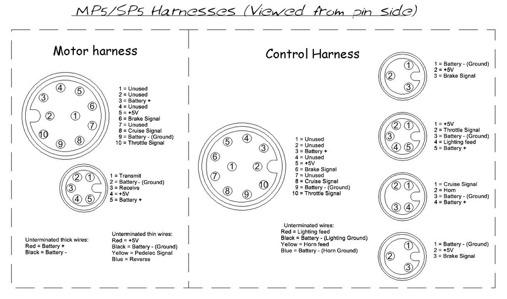

I have a golden motor magic pie with internal controller. It just quit working. Battery is good. No responses from throttle. When I owned the app on my phone the motor was not listed. I am unable
To check settings. I went and tried another battery and checked all cable connections. When I unplugged an plugged in the main controller connection the bike motor engaged causing the bike to go forward. Then when I tried to plug it in again it was dead. I disconnected both brake shut offs. Still dead. Throttle feels fine but does not work.
I do not have pedal assist. Any ideas?

You could try measuring the voltages on the throttle wires. Vs. ground, you should see one that's a steady 4-5v and one that varies with throttle movement.
Most likely there is a failure inside the motor and you will need to take it apart and inspect/test.

The throttle power lights are all on when powered up

I use a Magic Pie version 5.
To know what version you have would be helpful.
If it's a 5, this will certainly help...
