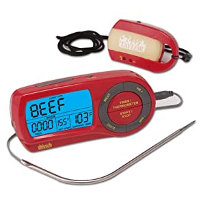

The solution:
BBQ digital temp monitor.. around 10$ good up to 350 celsius
I bought mine at Canadian tire store. What make it great is that it have an alarm setpoint!
All my ebikes have one and i never burned any hub with my 10-20kW..
I leave the winding going up to 140 celsius .. than i decrease throttle.

Yeah john it's just the display, but all you need is a thermocouple, a computer, and the simple math to use it it to monitor any temperature.
The solution:
The easy solution :D

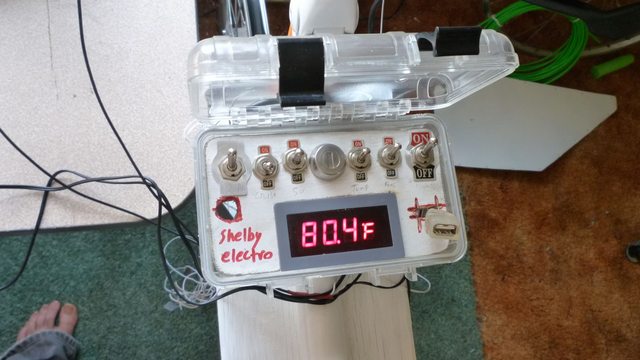

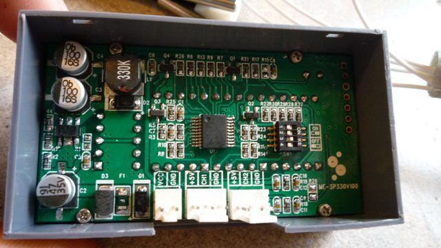

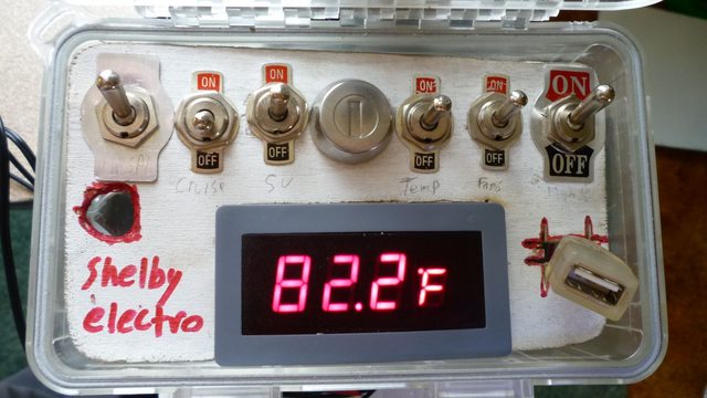

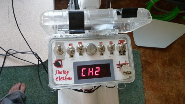

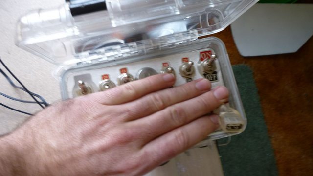

Post by auraslip » Mar 16 2011 4:08pm

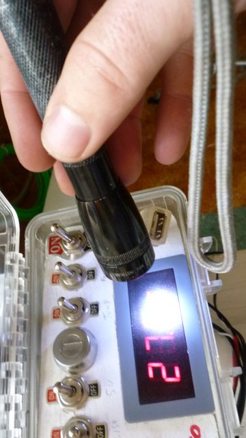

Came today - got it installed in my latest project - the cooled battery box for the lawn care bike - I got fans in the box as well as the thermo and I'm gonna monitor the internal temp of the PING as well as the battery box. Liveforphysics strongly disagrees with this being necessary, but cycle fade does happen at higher temps and I'm curious just hot hot a battery gets on the inside. Hopefully I won't need this, but I'll be using this bike in the 100 and 10 million degrees of a texas summer!
AN IPOD??? no. a $15 thermometer
dip switches
I got a bit quick making the box because I'm in a rush to get on the road! Yes that is a 5v usb plug for charging my phone/e cigarettes.
It flashes the channel number as it switches between them.
Also it has a cool feature to switch between C and F
Hit it with a light above 60 lumens (or the sun?)
Cover it
Volia - should be interesting to see how it works in broad daylight when you move in and out of the shade
