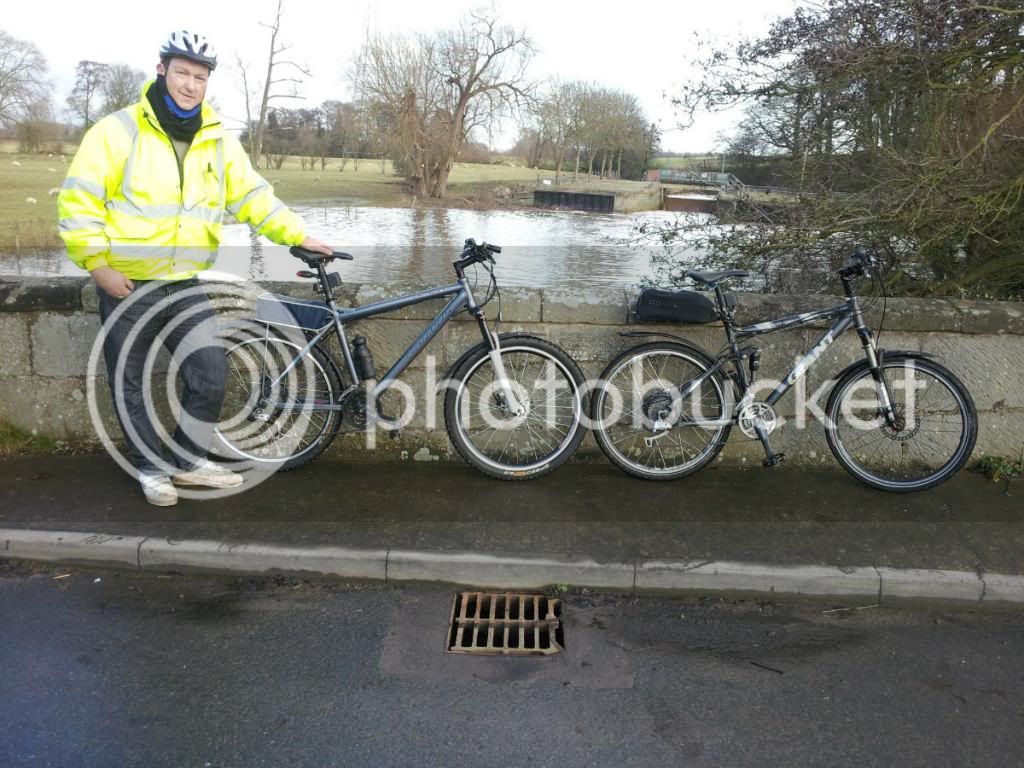

I've fitted two 500w CSTmotors and they dropped straight in to the bikes, which had 135mm drop-outs. One of then was an upgrade from a 350w CST: I hooked out the 350w wheel and dropped in the 500w one. I would therefore say that the 500w CST is made for 135mm drop-outs not 150mm.

I had the 500w BPM at 30 amps in my other bike, so that was the bench-mark. I started with the 350w CST at 22 amps, where it was a lot less than the BPM. I then tried the same 30 amp controller as my BPM, which made it marginally better, but nowhere near the bpm. Finally I upgraded to the 500w CST and 30 amps. Now it's the same as the BPM. I didn't weigh each, but I believe that the 350 is a few grams lighter, but otherwise, they're identical.

Interesting comments!
Unfortunately I've just sold the 350w one, so I can't measure it. I haven't actually measured the 500w CST, but all I can say is that I didn't have any problems slotting them in to the two bikes I built with them. I would say that even with 9 speed cassettes, they dropped in easier than a 500w BPM, but not much difference.
We've both done about 300 miles and are delighted with these motors so far - smooth, quiet and powerful. use "CTRL" +"-" to see the whole picture.

Hello Dave.
Nice picture of you on a cool day in the UK. Looks to me like there is a bit of flooding going on behind you in that picture as the water levels are creeping into the pastureland. Can't be that cold though. What! No gloves? :-)
I agree that it is unfortunate that we can't measure a possible difference between the 350 W version and this new 500 W version. However, it was fortunate that you were able to sell it though! Good for you! That would've been interesting just to see if there was any physical differences "between" the same 135mm nut to nut dropout measurement. Ah well, it all sounds very intriguing and I look forward to investigating these motors anewed.
But tell me Dave, what type of controllers were you using? And did you have to do any modification to them?
Cheers,
Tom

Actually, that's my friend Steve. Your right about the floods. It was even worse the week before, and the road was flooded too, so we got wet feet. Gloves are on the wall out of view. You're very observant! I only look at the bikes.
We use bog-standard KU123 controllers on the middle setting of the three-speed switch. We get about 22mph and really good climbing power.We see up to 32 amps on our wattmeters. The 350w CST felt a lot less powerful.
