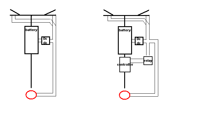

I'll describe the way i achieved the ebrake light, and if you like how it sounds let me know and i'll talk you through it step by step, with whatever help you need along the way.
First, as youve realized, a DC DC converter running from your ebikes battery is the most elegant and robust way to add additional electronic whatnots to your bike. Saves pissing around with gimicky bicycle accessories that just break within a year. You can get dc dc converters from ebay.
So if we arent using bicycle accessories, we are using motorcycle and scooter parts. Weirdly, they are much cheaper (larger market?), and better made. Buy a motorcycle or scooter brake lever for a cable brake/drum brake, it will accept the same bicycle cable nipple, it will clamp onto bicycle handlebars, and will cost nothing, like 7 dollars, and it will be bigger, have a longer pull, and be all metal. Nice. The switch inside the brake lever will be designed to accept the 12v current a brake light will need. The issue now is how to close the circuit of both the controllers motor cutoff/regen, and the brake light mounted on the back of your bike. If you only want to have the brake lever turn on the light and nothing else, then this isnt an issue, its really as simple as having one circuit with the dc dc converter, the brake lever switch, and the light (im not sure of your level of knowledge, let me know if the previous description doesnt make sense to you, and we can discuss it, its a good beginners electronics circuit, very achievable). The reason both lights and controller-cut-off cant be all on one circuit, is that 12v going into the controllers ebrake wires will damage the controller. So when you have this kind of conundrum in electronics, you use a relay. The squeezing of the lever closes a circuit that supplies a current to the relay, and that causes the relay to close 2 further, separate circuits, one for the light, one for the controller. Some people have recommended a double pole switch, which is one switch inside the lever that throws open and closed two circuits, and this would eliminate the need for a relay... but i cant find any examples of these double pole brake levers.
You can stuff the dc dc converter and the relay into the same enclosure your battery is in, that way its waterproof. Also, headlights and indicators can also run off your dc dc converter, even a horn.

Thanks a bunch for reaching out and trying to educate a newbie such as myself. Electronics are a bit of a mystery to me and circuit diagrams may as well be hieroglyphics. Perhaps there are some videos/books I can find to educate myself on this.

yeh amberwolf is right, the motorcycle levers sometimes result in a strange sloppy brake control, still useable but not what you might want. In that respect its a bit of a gamble. So you can go with the bicycle levers, their switches will probably handle the current.
Here is my work of art. Maybe amberwolf can check that it isnt totally stupid. The big 'T' in the middle is supposed to be a bike frame.
First shows you the most basic way it could be. The point where the two sets of lever wires meet might be confusing; you just join them both together, that way either lever closes the circuit.
The second uses the relay to protect the controllers ebrake input, which uses a lower voltage to 12v.
Let me know if it is waaaaay to basic and not communicative enough, and i'll... make it better

Thanks for the well thought out responses guys. I think I'd rather have more braking strength available rather than less. It seems my bike doesn't have the option for mounting the disc brake calipers so I am pretty limited to 'regular' brakes. Relying on just one brake sounds a little too weak for comfort. So I'd rather have both levers each activate a regular brake and the ebrake. That lever with all those knobs sounds excellent, if only I could wire in a bicycle brake line, maybe there is a way, like using a motorcycle cable hose for the portion required? I don't know if I understand everything correctly.
The picture looks like it should give me a great guide on where to guide the wires. Maybe I'll make a video of making the modifications for the newbies like myself who would like a quality brake light as a sort of guide. I am sure there are people who are completely incompetent when it comes to electronics and such that would find it useful, I know I would : P.
As for the specific relay, I don't really have a clue, it sounds almost like warrah thinks a relay might be unneeded. I am most likely going to be using cell_man's ebike kit. http://em3ev.com/store/index.php?route= ... duct_id=77 If this gives any indication of the type of or hall signals(?) and which type of relay, if any, would be needed, I'd be glad to know. Maybe I need to have the controller and such in order to find out? Which is a bit of a bummer. It would be cool if this could be followed universally by others not in the know.
