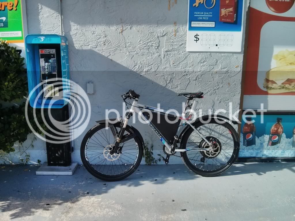

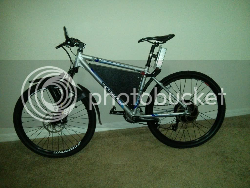

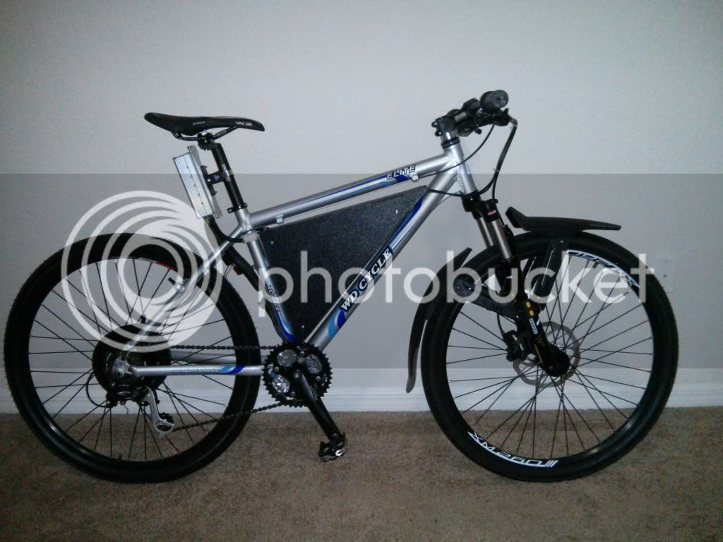

As for this build the purpose was to find a supplier on ebay that could supply me a frame continuously. My goal was to design a battery frame that could house a 18650 battery and to keep it simple with entry level components so that I could replicate it later on. HEre are the specs;
1- Motor - 9C clone motor
2- Controller- 12 fet infineon controller
3- Battery- 15S4P 18650 Samsung PAck (I envisioned building a bigger pack, but now that pack is going to another build I have planned :twisted: )
4- Left throttle and switch
5- Controller mount and torque arm well you know where those came from LOL
6- Tires - Kenda K838 with rhino liners and thorn resistant avenir tubes
So far the other components were source fairly easy and I'll make a list later here with the specs.
For now enjoy the pics. Videos will come later once I am done with the moving process :?
Still need to figure out the rear brake. I can confirm that AVID Elixirs and 180mm discs don't fit so my next try is the mechanical BB7's in the back with the same 180mm. If anyone has some feedback on that I appreciate it.
Update 7/28/13
Well I ended changing the MAC motor for a 9C. Made a quick video of my test ride and uploaded it to youtube.
I've been updating my 808 cameras and will soon start making some cool videos. Stay tuned!
Here ya go;

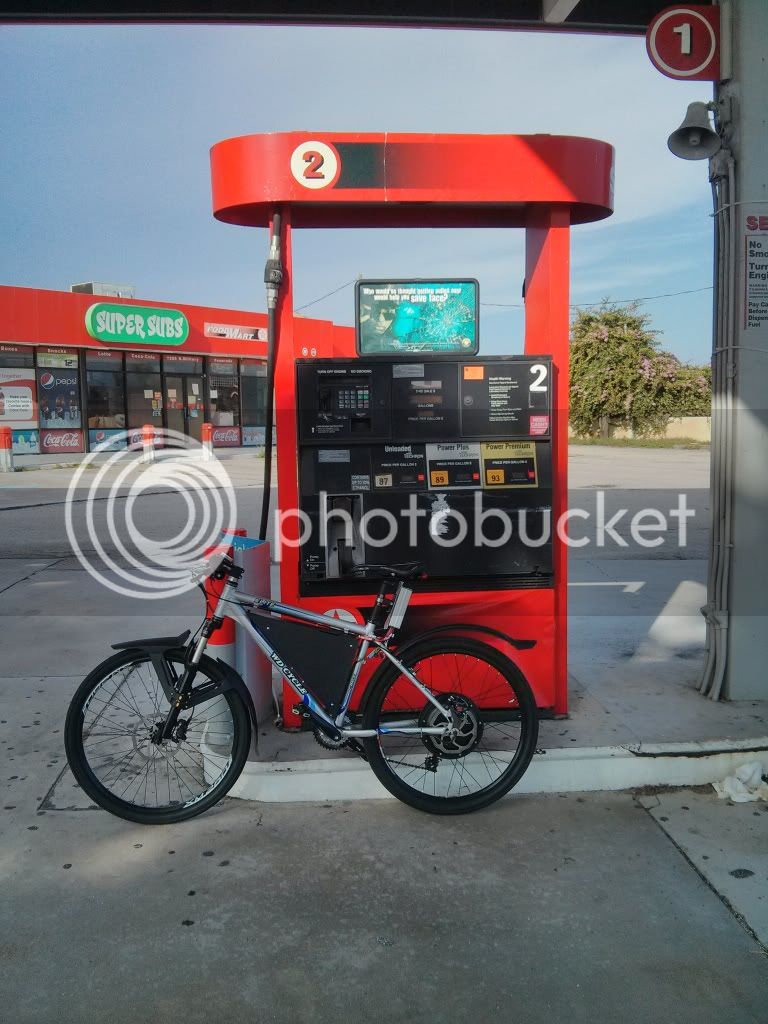

Update 9/16/13
Took the bike for a spin this weekend and took some snapshots.
It is interesting to see a texaco gas station abandoned.. whatever

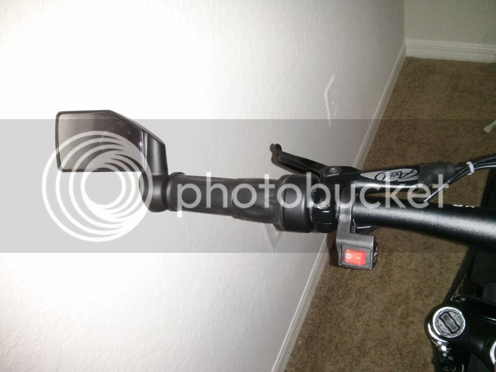

Looks good. I notice a lot of people do a mod on the BB7 brakes, I got BB5 brakes on my Bafang 500w and it doesn't require any shrinkige mods.
Also I noticed you got a handlebar mirror, does that work well for you? I got a cheaper one the other day from ebay and its crap, its way too small to see anything and it shakes too much when riding.
I have now ordered a helmet mirror which I can't help but will alleviate all my problems.

TheBeastie wrote:Looks good. I notice a lot of people do a mod on the BB7 brakes, I got BB5 brakes on my Bafang 500w and it doesn't require any shrinkige mods.
https://www.google.com.au/search?q=helm ... igKMjIHYCw
I never tried the BB5's but if they are a straight bolt on and go set that is good to add to the reference pages.
The handlebar mirror I have is a ZEFAL one. The mirror is essentially a reflective plastic. It should get worse with time but for now it is holding.
I commute mostly in the bike lane (right side) and it is good to see if a car is getting too close. Other than that when I don't use it it folds back below the handlebar.
The helmet mirrors are pretty good. I've only heard good reviews from them.
