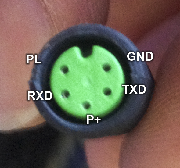

Post by Tom L » Apr 08 2014 5:35pm
Display side pinout (as marked on the C961 PCB): Image
Mirror the pinout for controller side.
P+ is the full battery voltage. PL is connected to P+ inside the display by a MOSFET when the display is turned on.

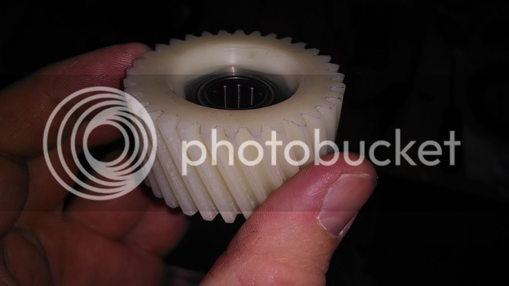

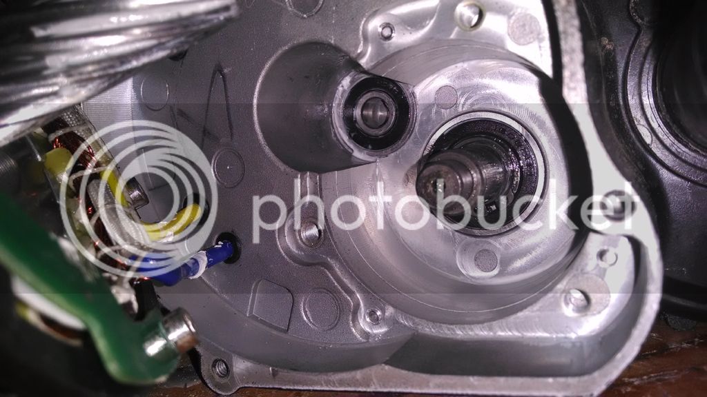

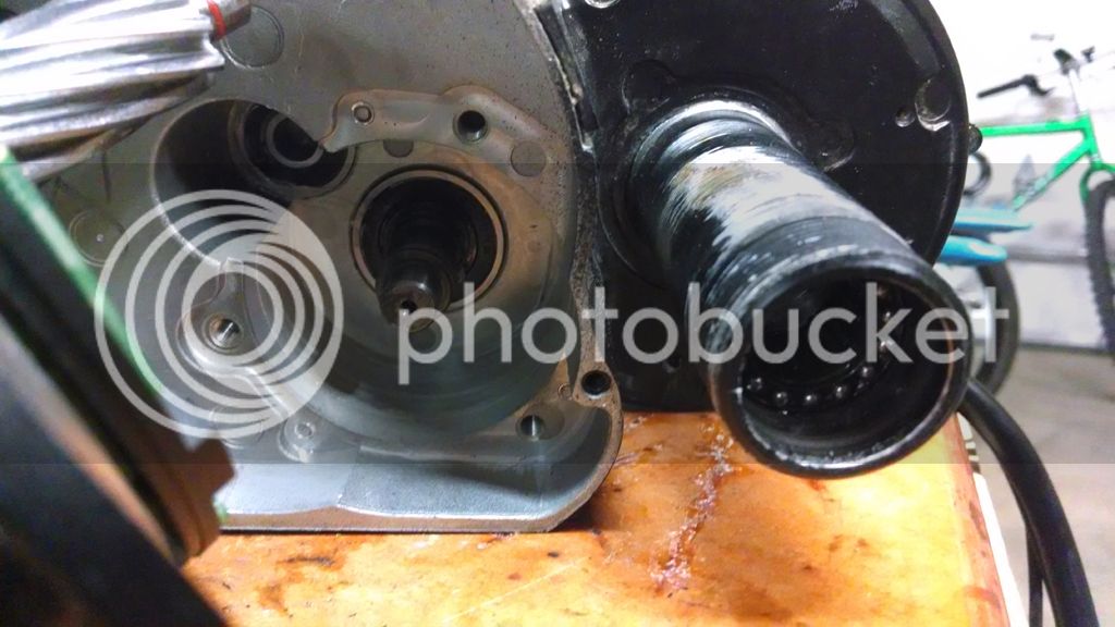

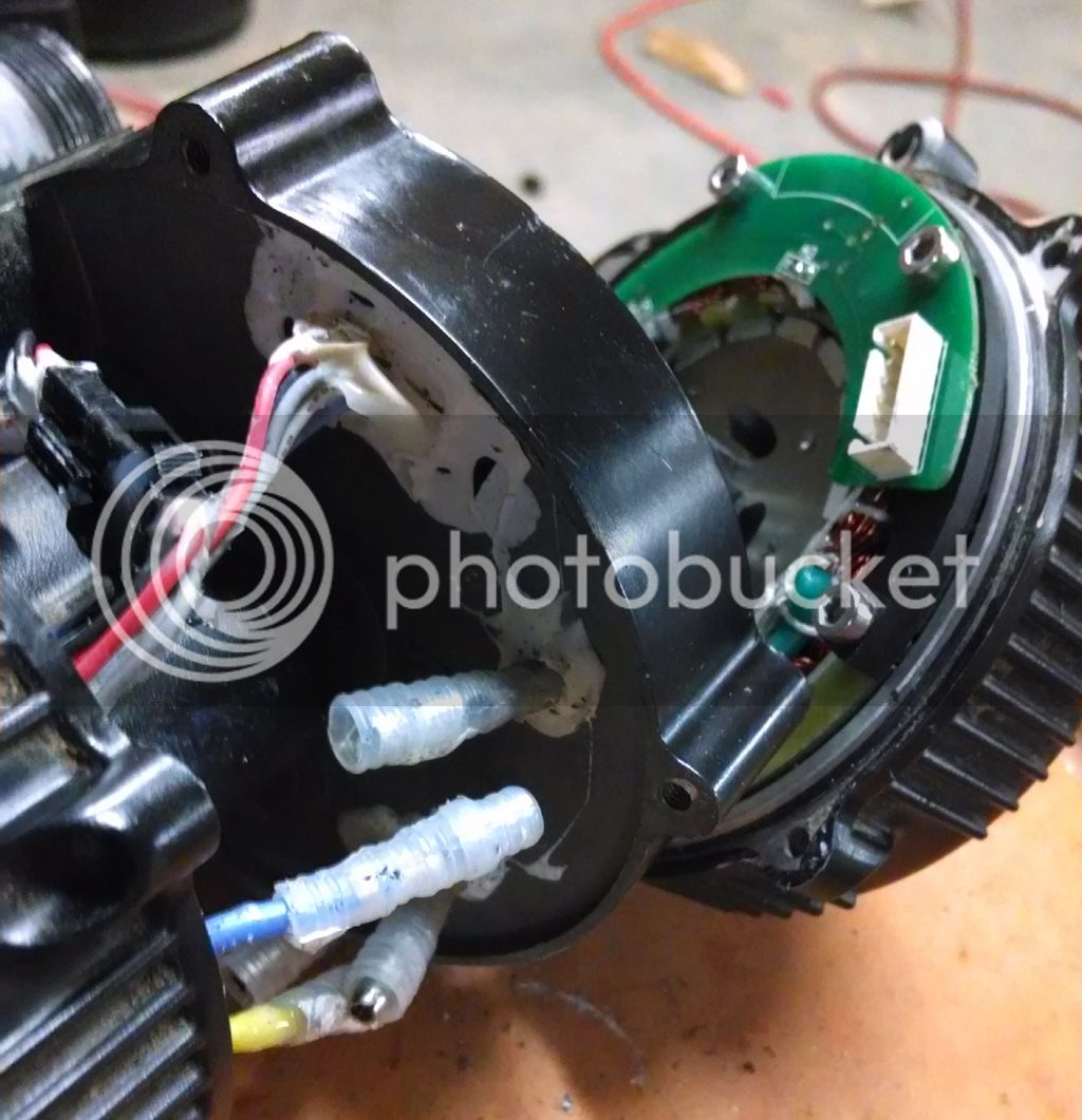

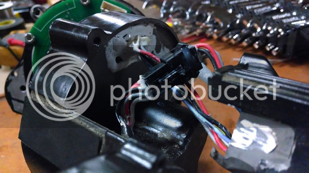

Some photos of the BBS02 750W drive unit opened up:
And this nylon gear has 500+ miles on it. Not bad, actually...

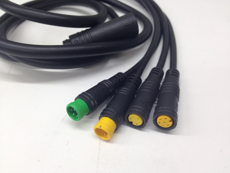

FYI, tried connecting my USB > TTL lead - plugged into the controller lead (green plug) pins first - gnd, tx and rx (and also tried tx and rx reversed) nothing. Press connect and no info returned and the read/write to flash buttons remain greyed out..
However, when I connect to the gnd, tx and rx pins on the display lead, I click connect some info is returned - nominal voltage shows as 24v but the hardware and firmware revision just show a little "v" symbol and all of the other values are zero. This connection "ungreys" the read /write flash buttons - I click "read flash" and it says "read from flash successful" but the values all remain as zero. I've not tried writing to flash for obvious reasons.
Unit is a BBS02 500w with a C961 display. Purchased Feb 2014 and has the new style connectors.

amigafan2003 wrote:Unit is a BBS02 500w with a C961 display. Purchased Feb 2014 and has the new style connectors.
What are the "New Style" connectors? Can you post some pics?

amigafan2003 wrote:FYI, tried connecting my USB > TTL lead - plugged into the controller lead (green plug) pins first - gnd, tx and rx (and also tried tx and rx reversed) nothing. Press connect and no info returned and the read/write to flash buttons remain greyed out..
You need to short the P+ and PL pins together as well. This is how the controller is turned on.

Post by teslanv » Apr 11 2014 1:27pm
Ok. Same connectors I have. So then the old-style connectors have the sixth pin and no Notch in the plastic?
