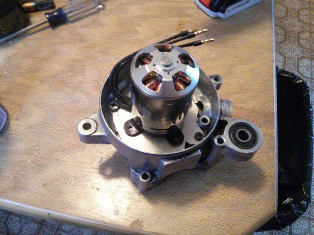

I decided that I wanted to use the entire original crankcase, because the frame mounting bushings were cast into the top (you can see one in the photo above), so I was going to have to create some kind of replacement crankshaft to adapt the outrunner to the original clutch and transmission.
I originally thought I would cut the original crankshaft in half and drill a hole for the outrunner's shaft to fit into. With that in mind I cut everything except the clutch bearing faces off the crankshaft:
Since I was going to mount the motor on the side of the crankcase opposite the clutch, I would have needed to weld a piece of round stock on to the remaining piece of the crankshaft to bridge the gap. I decided that it would be harder to weld something completely straight that it would be to machine a new one, so I ended up just taking careful measurements of the shaft and creating a new one from aluminum:
Next up was creating a good place in the non-clutch side of the crankcase to mount a motor. That side originally held the flywheel and ignition system, and had a lot of geometry cast into it. I clamped it in the mill and machined everything flat:
I cut out a sloppy little plate on the bandsaw and drilled a hole for the motor shaft, along with threaded holes for the motor mount:
While I was at it I tapped out the bearing and replaced it with a sealed unit rated for sufficient RPM:
Here you can see the new bearing with the custom crankshaft:
The hole is for the outrunner shaft, I machined a groove into the outrunner shaft and put a set screw inside the new crankshaft to lock them together.

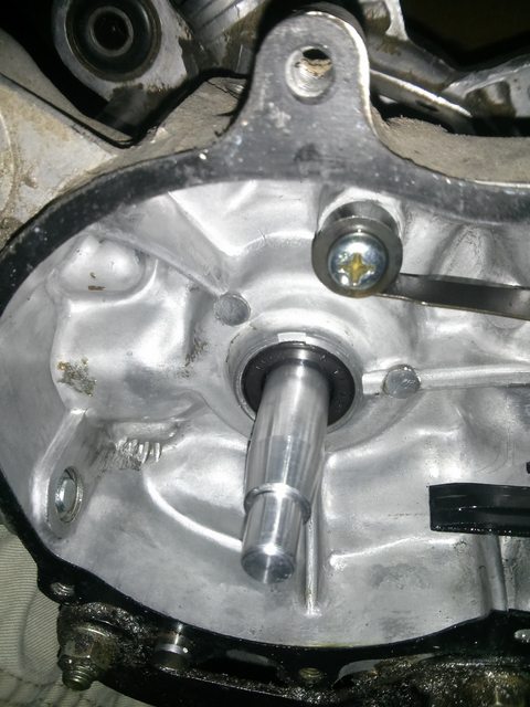

Here is where the piston would have used to be, as you can see it's just a straight aluminum shaft now:
And here is where the clutch would sit (I later threaded the end of the shaft for the clutch lock nut):
At this point I had pretty much figured out the entire drivetrain and needed to start on electronics. I did not want to use a sensorless controller so I did quite a bit of research into adding external hall effect sensors to outrunners. I found that I needed some way to mount them 17.14 degrees apart around the case of the motor. For this, I turned to 3D printing and whipped up a quick mount on the RepRap:
I drilled some holes in a piece of aluminum stock and used that to mount the sensors in the motor side of the crankcase on the same plate I had made earlier:
I'm ashamed of how bad my wiring job is haha, fixing that is the first thing on the todo list once I get things close to done. At this point I was able to reassemble the moped and get everything mounted up! Here's the entire rear end of the moped with the motor installed:
This is where it is today, I'm pretty pleased with how it's turning out. I got around to bolting the rest of the frame on and installing a throttle today, here's the very first run of the motor:
