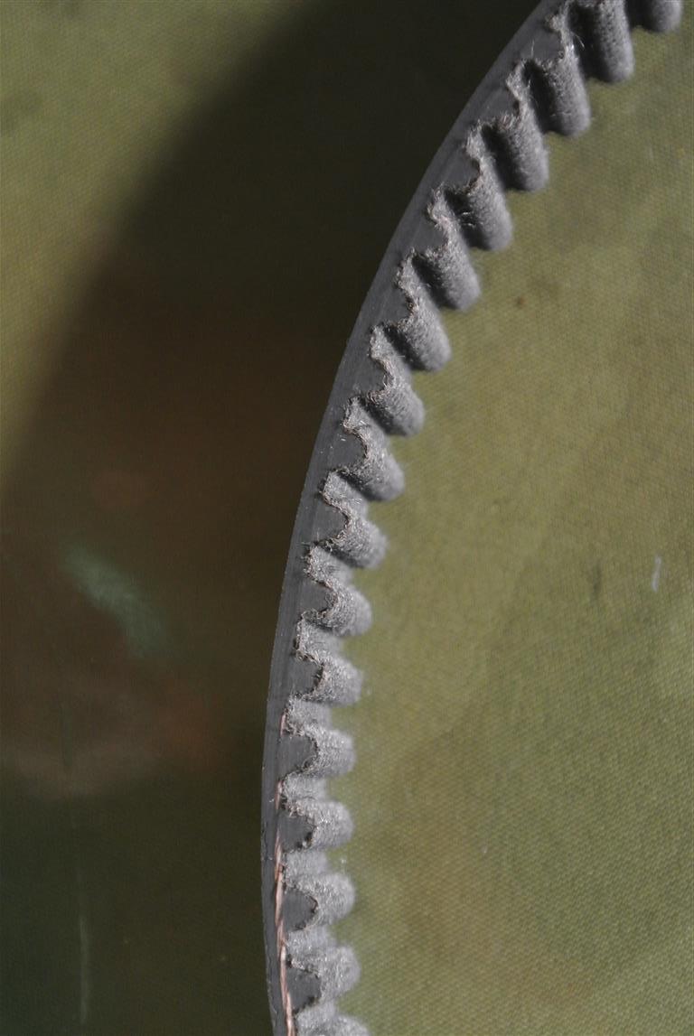

so here it is mounted to a hardtail (for now). after 300kms there IS some noticeable wear on the belt:

jdevo2004 wrote:I like your belt and chain mods.
thanks but i'm not sure if the mods did any good LOL. here's the belt after 500kms:

Post by Overclocker » Apr 08 2015 11:03pm
1000km belt life not good enough. time to do chain conversion...

Post by meelis11 » Apr 09 2015 3:19pm
Did you file off sharp edges of both toothwheels? Probably not, do it.
I did and my belt tooths look like new after 900km. Max they were lasted was about 800-900km but breaking belt is due to stock design (wrapping belt over too small tensioner and probably breaking/weakening fibers inside belt). I now modded that too - replaced belt with shorter version 260mm length instead of stock 275mm

Post by Overclocker » Apr 10 2015 10:24pm
meelis11 wrote:Did you file off sharp edges of both toothwheels? Probably not, do it.
yep i did. the motor pulley was particularly time-consuming...
i'm also using a much larger backside idler. less back-bending
btw i do a lot of off-roading that's why everything looks dusty LOL. some of my climbs are enough to stall the motor. probably contributed to the belt's early demise.
It still looks like some of teeth are still sharp. Maybe you missed some sharp edges?
But id you are almost 1000km mark and belt has not broken - so less backbending must help :) Did you mod it immediately (no riding in stock conf)?
btw, what is your idler diameter?

meelis11 wrote:
30mm
yep i modded immediately
anyway i'm giving up on the belt. i've just hacked the 80t belt pulley and turned it into a "spider" for the new 80T #25 sprocket. motor sprocket is 11T. should give decent reduction. pictures coming soon
PS i believe the only way to make the belt system work is to have at least an 18T motor pulley. but this means a very high tooth count driven pulley if you want a good amount of reduction.

Why you give up - did you brake your belt or does belt skip?
Overclocker   10 kW
Posts: 703
Joined: Mar 17 2014 5:48am
Location: Philippines
Re: Mongoose Salvo, GNG 1.1 build (in progress)
Post by Overclocker » Apr 14 2015 8:15am
meelis11 wrote:Why you give up - did you brake your belt or does belt skip?
while out on a ride the belt started giving out a screeching / tearing sound so i immediately headed home since i didn't want to have to pedal back home :evil: some teeth on the belt had already partially broken off
anyway here's what remains of the 80t belt pulley
