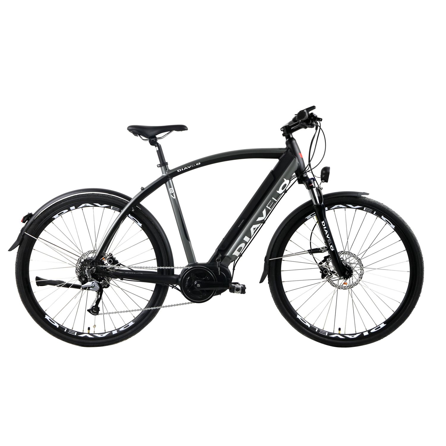

Re: Bafang MAX drive (250W) readout
What sort of bike do you have your Max mounted on and are you using 36v or 48v battery, What sort of riding conditions and range?
A Diavelo, like this
36V, 324Wh integrated battery pack. I ride it to and from work now in the winter. Temperature between -5 and 10 degree celcius, with studded tires. 20 Km total to and from work, with ~220 m uphill each way (according to my edge 510).
The first two kilometer to work I have two kids in a Thule Cheetah trailer that I drag uphill (110 m up from where I start), so about 45 kg of extra weight there. Where I on my normal pedal bike would be hoping for death by the time I get to the top with the trailer (average speed 10 km/h), on the e-bike I barely start to sweat (average speed 15 km/h). It makes a huge difference
Not sure what the total range is as I haven't ridden it until empty. If I use set the assist level high (2 for flats, 5 for uphill) I have about 60% battery left when I get home, a bit more conservative and I end up at about 70% left.
