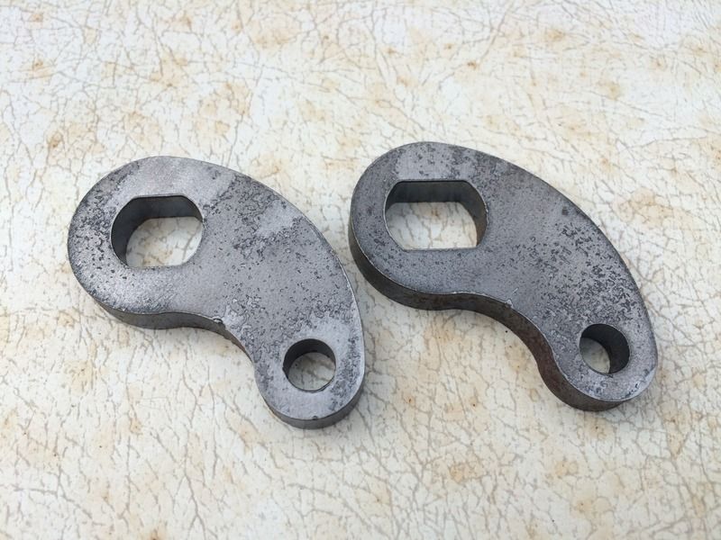

As a sweetener, I have some laser cut torque plates that I can send to whoever helps me out.
They are cut from 6mm steel and there is two sizes, 12mm and 14mm axle with 10mm flats.
Happy to send either or, or both sizes, whatever you wish. How about two of each size?
