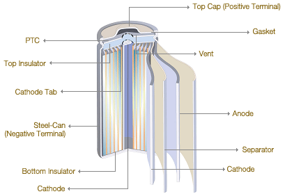

Tesla uses ultrasonic vibrations to connect a fuse-wire from the nickel-plated aluminum-core bus plates to each of the positive tips of the cells.
I'm starting this thread to park information I find about using fuse-wire. This has to do with fire-safety, and is something that every battery builder should care about. The video below is a builder making a DIY Tesla-style power wall as a power backup for his home, using salvaged laptop cells. Laptop 18650's are all low-current and medium-capacity, they compete on lowest price only, not performance. However, if the pack is large enough low cell amps can still add up to high pack amps.
I don't like the idea about soldering onto the tips of the cells, and would prefer any one of the methods used in other threads around here (spot-welding, magnets, no-solder contact pressure from poron foam). Be that as it may, regardless of your preferred connection method...I have embraced the idea that the series connections (which carry the full pack current) should be thick copper (raw or nickel-plated), and the parallel connections can be very thin, so...it is intuitive that the parallel connections should be the fuse-wire.
also, I don't think the positive end and the negative end needs to be using an identical connection method. I think on the broad and flat negative, there is merit to using button magnets to hold flat copper ribbon onto the cell-end.
In this particular application, he used thicker wire on the negative cell-ends, and it is the positive ends that have the thin 0.25mm wire as a fuse. He is using magnet-wire, so the enamel has to be removed, and this builder merely heats the wire at the location of the connection point with his soldering iron (perhaps not the most professional method, but it seems to work for him). Your individual cells' current (when shorted) will determine the minimum diameter of fuse wire that is appropriate (which needs to carry the max amps of current for one cell without getting too warm...more research is needed to make an acceptable chart, to be posted here when finished), and this should be balanced against the diameter of wire needs to be so it melts rapidly when full pack current is used. Using 2X the minimum diameter might be a useful starting point (10A cont at the cell/ 80A peak for the entire pack, so...wire gets warm at 15A and melts rapidly at 20A?). This is just a suggestion, and it may be amended in the future as more information becomes available.

There are several ways in which a battery pack might have thermal runaway event, leading to a fire. Having each cell fused, means that one type of cell failure could be eliminated as a possibity.

Vanarian, you mention 30A and 60A, but...I assume that is for the entire pack? If your P-groups are 5 cells, then each cell contributes 6A continuous, and 10A peak.
If there is a short inside one cell that allows the full pack current to pass through it, then that cells' fuse-wire will pass 60A, when it normally passes 6A-10A.
It is easy to experiment, and I would suggest for your pack: a wire diameter and material that is warm to the touch at 12A continuous, and blows quickly at 20A?
I am still learning, and i am posting all of this here to help me learn, and for others to help teach us.
________________________________________
If you are truly running 60A peak "per cell", then...a 5P pack would provide 300A. In that case, maybe try running fuse-wire that blows quickly at 120A? [edit: I am certain a shorted cell will flow all of the unrestricted amps that a parallel group can put out, not the amps of the whole pack]

If he's talking about 18650 cells it doesn't really matter because no cell is going to deliver that without cooking itself...
Fuses rely on a good differential between normal operating current and fault current. If you're trying to draw normal operating current near a current source's short-circuit current then getting effective protection from a fuse becomes difficult or impossible.

Fusing each individual cell protects the rest of the parallel cells against the failure of a single cell...such as an internal short..which could overload the entire group internaly even if you had external pack fuses.
They will also protect the cells agains an external short or overload.

when the failed cell is shorted by the fuse, does the related parallel group switch "OFF"
If the paralleled sub-pack is a 5P and one cell-fuse melts, that string will suddenly become a 4P sub-pack, but...the pack will still run, with each of the other four cells having 20% more amps pulled from them. I have a few ideas about how to flag a blown cell-fuse right away, but...the important thing is for an internally shorted cell to stop thermal-runaway immediately, so the entire pack doesn't go up in flames.

Individually fused cells is about the only way to protect against a cell that shorts internally. I don't think this kind of failure is very frequent but it does seem to happen. I think Tesla was more worried about pack damage from a crash. Bikes crash too, but the packs probably less prone to getting shorted from it.
Where using large format cells in a 1p configuration, I don't see much value in individual fuses. A single mid-pack fuse seems to be adequate.
I think you could test fairly easily by setting up a single crash test dummy cell with the fuse link and try shorting it to see how long it takes to blow (please video). Then test the link at the maximum expected current to make sure it doesn't blow or get hot.

takyka   10 mW
Posts: 30
Joined: Apr 01 2015 2:25am
Location: Hungary
Re: Fuse-wire for individual cells, DIY Tesla style
Post by takyka » May 10 2017 2:01am
The PFs has no extra protection built in.
Looking like this:
http://www.bazaargadgets.com/image/cach ... 00x800.jpg
You can see how the cap is made...
T.
